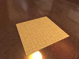

Hello,
Inspired by the question of incognito, I started making a puzzle macro.
It is nearly finished (some minor CSG stuff to be done), but good enough for
a demo scene.
The macro needs the following variables:
-number of collums (integer)
-number of rows (integer)
-radius of edges (float)
Variables that can be changed before the macro is called:
-fast (no rounded edges) (on/off)
-party(gives the pieces random collors) (on/off)
-texture of pieces
-suggestions???
The macro will be released "soon".
Of course comments, questions are very welcome as usual  :-).
Greetings,
JWV
Download 'puzzle.jpg' (203 KB)
Preview of image 'puzzle.jpg'

Neat!
Some observations/suggestions:
- Could the horizontal/vertical lines separating the pieces (ignoring the
"protrusions") be a bit more wavy? The pieces are too square for my liking
(I find real puzzles like that somewhat boring).
- Also, some edges could have no "protrusion", just a more wavy shape than
the bare straight edge. ASCII picture:
                             ____
     ____                   \    /
  __/    \__  instead of  __/    \___
- Most real puzzles I've found have a lower density of "special" pieces,
meaning pieces which are *not* the typical shape:
     ___    ___
    |   |__|   |
   _|          |_
  |_            _|
    |    __    |
    |___|  |___|
This density of "defects" could be adjusted with some parameters...
light_source{9+9*x,1}camera{orthographic look_at(1-y)/4angle 30location
9/4-z*4}light_source{-9*z,1}union{box{.9-z.1+x clipped_by{plane{2+y-4*x
0}}}box{z-y-.1.1+z}box{-.1.1+x}box{.1z-.1}pigment{rgb<.8.2,1>}}//Jellby

I thought about this, but it would make it way to complex to implement at
this moment.
I think it would even need a completly different approach, and i would need
to master beziersplines first.
So, no, not for the moment. :-) (but it will deffinitly be in v2.0, if there
will be one)

After staring at, thinking about, and realligning the ascii picture: Yes
that would be possible (will try to implement that).

Many real puzzles are somewhat boring, with all pieces the same general
shape (some of them even have all pieces exactly the same shape). This
general shape consist on two bulges on two opposite sides and two holes on
the other two opposite sites. There are, however, some pieces with
"special" shapes, which deviate from the typical shape mentioned above (and
shown in the ASCII picture). These "special" pieces or "defects" (since
they make the overall shape non-periodic) can have:
 - three or even four bulges or holes.
 - two bulges in non-opposite sides (I don't remember having seen this).
 - a side (I have not seen more) without bulge or hole, just the "wavy"
shape I described in my previous message.
Your puzzle shows the first two kinds of defect, but in a very high number,
there are too many "special" pieces for a typical puzzle, I'd say. I
suggested you could make this "density of defects" an adjustable parameter.
When this parameter is 0, the puzzle would be perfect, completely regular,
all pieces (except for the straight edges) exactly the same shape, as the
the parameter increases, the number of "special" pieces increases as
well... maybe something like this:
 0:   perfect puzzle: bulge to the left, bulge to the right, bulge to the
left, bulge to right... and bulge down, bulge up, bulge down, bulge up...
 0.1: each bulge has a 10% probability of being inverted (changed from left
to right or from up to down).
 0.5: the puzzle is completely chaotic, there's no regularity (maybe this is
how you do it now?)
 1:   all bulges are inverted, so the puzzle is again regular, but
different.
I don't know what's the structure of your macro right now, but unlike my
first suggestion (in the previous post), this one should be no real problem
(I guess). :)

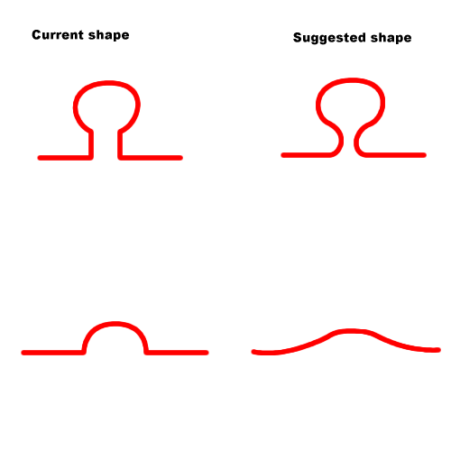

I realized you've already posted the code. I've looked more closely at the
images and maybe you could find some time to "improve the shapes of the
pieces. It would take some time and effort, but I believe it may be worth
it. I include an attachment, because ASCII art is not good enough for this
Note: if/when you use differences and intersections in your code, I guess it
would be wise to add "manual" bounding boxes to improve the rendering
times...
problem
> (I guess). :)
So, you guesed wrong :-).
About the waving edges, it can be done but i need a special shape. I'm
thinking about making a deformed square using splines (one spline for each
edge), but i can't find a way to do this.
Greetings,
JWV

"Jellby" <jel### [at] M-yahoocom> wrote in message
news:41285ff4@news.povray.org...
> >> than the bare straight edge. ASCII picture:
> >>                              ____
> >>      ____                   \    /
it
> times...
