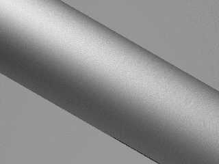

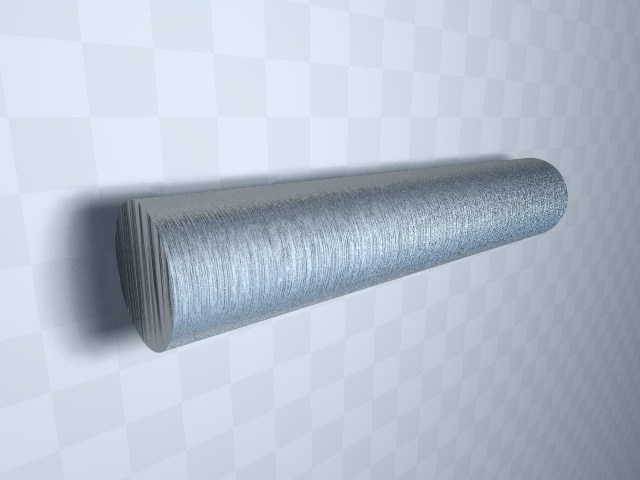

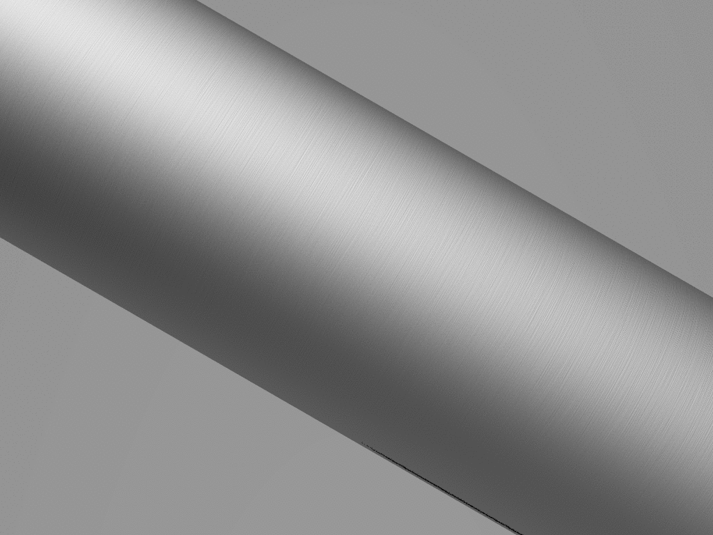

Hi there,
   I'm currently working on my IRTC wip for the Great Invention still.
I was wondering what you thought of this brushed metallic cylinder?
Source code for cylinder is:
cylinder { <0, -5, 0>, <0, 5,0>, 1
   texture {
     pigment { rgb 1 }
     normal { bump_map { png "BrushedMetal.png" map_type 2 interpolate 2}
       translate <0,-0.5,0> scale y*5 bump_size 7
     finish {
       ambient 0
       reflection 0.6
       brilliance 5
       specular 0.01
       metallic
   rotate z*60
And first image is the Render, took 78 secs on my 450Mhz.
And second image is a sample of the texture I used to brush the cylinder!
Download 'brushedcylinder.png' (163 KB) Download 'brushedmetal_sample.png' (31 KB)
Preview of image 'brushedcylinder.png'
Preview of image 'brushedmetal_sample.png'
BTW, the black line below the cylinder is most likely caused by the
shadow on the background caused by the single light at an angle of 30
degrees over the cylinder.
It looks quite nice.
Perhaps have a look at this brushed metal too:
http://runevision.com/show.asp?page=povgoodies&data=brushed
This texture actually doesn't have any small bumps at all, but it looks
very much like brushed metal, even from long distances. Well, this
technique actually doesn't do anything to the sides of the cylinders,
only the caps (the ends of the cylinders), but then, I think it's the
cylinder caps that best show off brushed metal... ;)
It can be combined with your own texture too...

Neat; there are lots of things motion blur on noise can make! In this
case, you may find it easier to use a noisy procedural pattern like
"granite". The following normal resembles what you did with a bump_map:
	normal
		granite 0.1
		scale <0.1, 20, 1>
		no_bump_scale       // Keeps my scaling from messing up the bump depth.
The attached image is a rendering of a cylinder with this normal. By
using procedural textures, you can:
* Forget about having to make your bump_maps "blend" together.
* Get virtually infinite resolution because you're not using a bitmap
but a mathematical function.
* Use less memory because you aren't loading an image.
* Spend less time mucking about in Photoshop :-)
Dan P
http://<broken link>
Download 'cylinder.jpg' (109 KB)
Preview of image 'cylinder.jpg'
Thanks!
I remember seeing these here on the newsgroups too...  It is very neat!
   I guess this effect could also be used to make the kind of rainbow
refraction seen on CD-ROMs.
However, I will not need cylinder caps in my scene, only the sides of
them...
Thanks!
Yup, although I only used horizontal blur! ;)
I didn't spend much time in GIMP, I knew exactly what I wanted and GIMP
provide WYSIWYG!
And I can easily add home-made scratches to my texture as well...
Though, I like maths and I like a povray file that is "self-contained"
with all the textures generated...  Eventually I may take the time to
learn POV-Ray more indepth, but I'm trying to use the computer the least
possible.  It's not even a hobby anymore, it's more like a sporadic
passion from the past! ;)
Thanks,
   Simon
Hehe -- horse, piece.
> provide WYSIWYG!
Ah, a GIMPer! Great to hear it!
You've got a good point about the scratches and stuff -- you have more
control over your texture. You could use average your textures to
seperate the brushed metal part from the scratches as well.
Sporadic Passion -- is that the sequel to Mel's film? :-)
