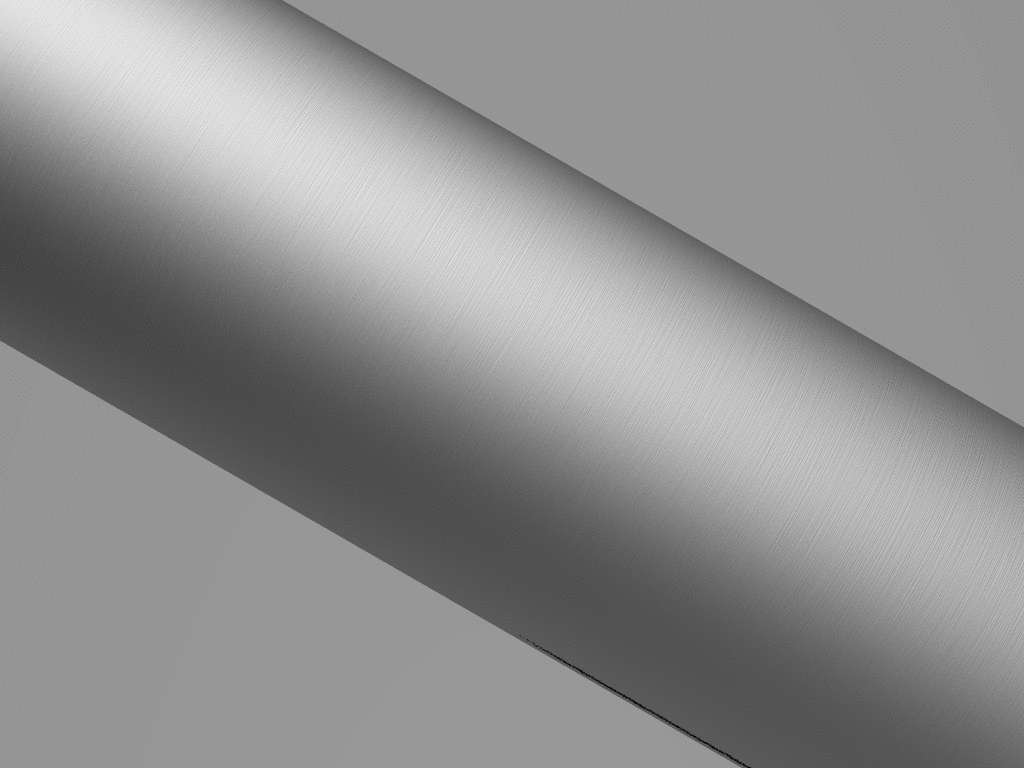

Hi there,
   I'm currently working on my IRTC wip for the Great Invention still.
I was wondering what you thought of this brushed metallic cylinder?
Source code for cylinder is:
cylinder { <0, -5, 0>, <0, 5,0>, 1
   texture {
     pigment { rgb 1 }
     normal { bump_map { png "BrushedMetal.png" map_type 2 interpolate 2}
       translate <0,-0.5,0> scale y*5 bump_size 7
     finish {
       ambient 0
       reflection 0.6
       brilliance 5
       specular 0.01
       metallic
   rotate z*60
And first image is the Render, took 78 secs on my 450Mhz.
And second image is a sample of the texture I used to brush the cylinder!
Download 'brushedcylinder.png' (163 KB) Download 'brushedmetal_sample.png' (31 KB)
Preview of image 'brushedcylinder.png'
Preview of image 'brushedmetal_sample.png'
From: Xilo Musimene
Subject: more...
Date: 18 Apr 2004 14:12:53
Message: <4082c525$1@news.povray.org>
BTW, the black line below the cylinder is most likely caused by the
shadow on the background caused by the single light at an angle of 30
degrees over the cylinder.
Simon
From: Rune
Subject: Re: Brushed Metal
Date: 18 Apr 2004 14:49:13
Message: <4082cda9$1@news.povray.org>
It looks quite nice.

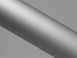

From: Dan P
Date: 19 Apr 2004 00:23:00
Message: <40835424@news.povray.org>
> Hi there,
<snip:technical />
Neat; there are lots of things motion blur on noise can make! In this
case, you may find it easier to use a noisy procedural pattern like
"granite". The following normal resembles what you did with a bump_map:
	normal
		granite 0.1
		scale <0.1, 20, 1>
		no_bump_scale       // Keeps my scaling from messing up the bump depth.
The attached image is a rendering of a cylinder with this normal. By
using procedural textures, you can:
* Forget about having to make your bump_maps "blend" together.
* Get virtually infinite resolution because you're not using a bitmap
but a mathematical function.
* Use less memory because you aren't loading an image.
* Spend less time mucking about in Photoshop :-)
Dan P
http://<broken link>
Download 'cylinder.jpg' (109 KB)
Preview of image 'cylinder.jpg'
From: Xilo Musimene
Date: 19 Apr 2004 01:48:48
Message: <40836840$1@news.povray.org>
Thanks!

From: Xilo Musimene
Date: 19 Apr 2004 01:54:24
Message: <40836990$1@news.povray.org>
Yup, although I only used horizontal blur! ;)
I didn't spend much time in GIMP, I knew exactly what I wanted and GIMP
provide WYSIWYG!
And I can easily add home-made scratches to my texture as well...
Though, I like maths and I like a povray file that is "self-contained"
with all the textures generated...  Eventually I may take the time to
learn POV-Ray more indepth, but I'm trying to use the computer the least
possible.  It's not even a hobby anymore, it's more like a sporadic
passion from the past! ;)
Thanks,
   Simon

From: Dan P
Date: 19 Apr 2004 23:38:18
Message: <40849b2a@news.povray.org>
Hehe -- horse, piece.
> provide WYSIWYG!
Ah, a GIMPer! Great to hear it!
You've got a good point about the scratches and stuff -- you have more
control over your texture. You could use average your textures to
seperate the brushed metal part from the scratches as well.
Sporadic Passion -- is that the sequel to Mel's film? :-)
Respectfully,
Dan P
