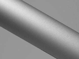

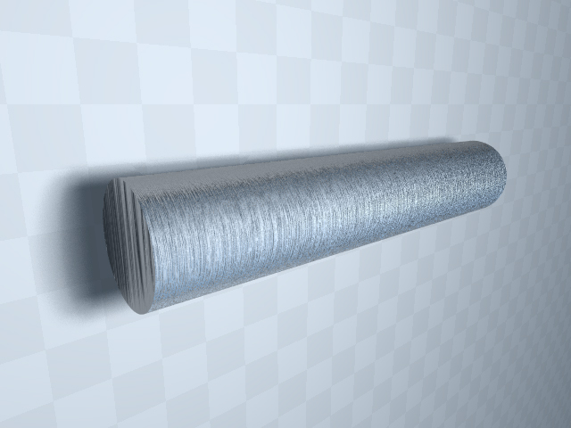

Hi there,
   I'm currently working on my IRTC wip for the Great Invention still.
I was wondering what you thought of this brushed metallic cylinder?
Source code for cylinder is:
cylinder { <0, -5, 0>, <0, 5,0>, 1
   texture {
     pigment { rgb 1 }
     normal { bump_map { png "BrushedMetal.png" map_type 2 interpolate 2}
       translate <0,-0.5,0> scale y*5 bump_size 7
     finish {
       ambient 0
       reflection 0.6
       brilliance 5
       specular 0.01
       metallic
   rotate z*60
And first image is the Render, took 78 secs on my 450Mhz.
And second image is a sample of the texture I used to brush the cylinder!
Download 'brushedcylinder.png' (163 KB) Download 'brushedmetal_sample.png' (31 KB)
Preview of image 'brushedcylinder.png'
Preview of image 'brushedmetal_sample.png'
BTW, the black line below the cylinder is most likely caused by the
shadow on the background caused by the single light at an angle of 30
degrees over the cylinder.
Simon

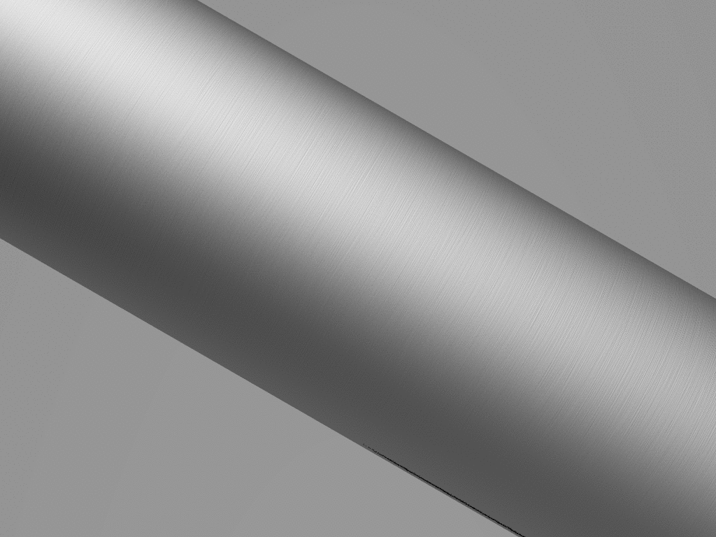

Neat; there are lots of things motion blur on noise can make! In this
case, you may find it easier to use a noisy procedural pattern like
"granite". The following normal resembles what you did with a bump_map:
	normal
		granite 0.1
		scale <0.1, 20, 1>
		no_bump_scale       // Keeps my scaling from messing up the bump depth.
The attached image is a rendering of a cylinder with this normal. By
using procedural textures, you can:
* Forget about having to make your bump_maps "blend" together.
* Get virtually infinite resolution because you're not using a bitmap
but a mathematical function.
* Use less memory because you aren't loading an image.
* Spend less time mucking about in Photoshop :-)
Dan P
Yup, although I only used horizontal blur! ;)
I didn't spend much time in GIMP, I knew exactly what I wanted and GIMP
provide WYSIWYG!
And I can easily add home-made scratches to my texture as well...
Hehe -- horse, piece.
