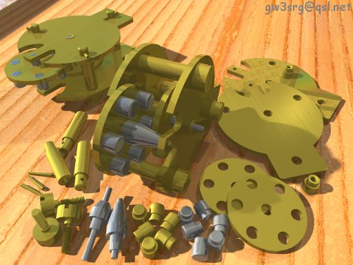

This was an engineering examination test piece. (A real life example
of required sharp edges ;) It has no other useful purpose*
Couple of days on the csg, mostly on the helix thread.
Weeks on the brass texture which still doesn't look right.
Bright sun-light on the left.
Objects in the room don't show very well despite brass reflection of
0.6 but they DO s****up the brass texture.
An 800*600 98k version is here:
http://www.peake42.freeserve.co.uk/pix1/tape.jpg
Shiny metal gets most of its appearance from reflection, not diffuse
lighting. Try cranking the diffuse down to 0 and slowly increasing it
from there until it looks good.. also, from what I can see here, you
need a much stronger specular to simulate the reflection from strong
sunlight. You might even consider using photons for the reflective caustics.
-Xplo

I have had pretty good luck with metals by bringing the total luminosity of
the pigment way down and then using a relatively high reflection value.  See
my previously posted image.  Xplo is right ... you need to have it
reflecting something to make much of the effect.
Aaron
it
I'll try that again. This was my final brass texture.
texture{
   pigment{ rgb <1,0.9,0.35> }
   finish {
      ambient 0.2 // 0.1
      diffuse 0.6 // 0.2
      brilliance 4
      metallic
      specular 0.7 roughness 1/1000
      reflection{ 0.1, 0.6 metallic }
      conserve_energy
caustics.
I used photons but they are not very visible.
Thanks for advice
Alf
luminosity of
value.  See
Your metal around the barrel looks very good.
Yes. The object is in a fairly "busy" room (fire, chairs, wall
pictures, TV, doors etc) but I think most of the reflections are of
the ceiling.
I'll play with it a little longer.
Thanks
Alf

Try an HDRI environment!
"Alf Peake" <alf### [at] peake42freeservecouk> wrote in message

Yes, its on my "to try" list which is now long enough to reach the
moon :/
Some of the results I've seen posted here in p.b.i are amazing.
I've taken Xplo and Aaron's advice and the updated scene does look
better:
Alf
>caustics.
Photons will show much better if you increase the specular reflection.
Try something like reflection { <0.6, 0.5, 0.2> } (and lower the
diffuse pigment accordingly).
------------------- Richard Callwood III --------------------
~  U.S. Virgin Islands    ~  USDA zone 11  ~  18.3N, 64.9W  ~
~  eastern Massachusetts  ~  USDA zone 6 (1992-95)          ~
--------------- http://cac.uvi.edu/staff/rc3/ ---------------
reflection.
I checked the "real life" scene yesterday in bright sun-light on the
wood table. I was surprised that the caustics could not be seen
against the lighter wood unless you looked very hard. I was sure there
should have been some :/
Alf
