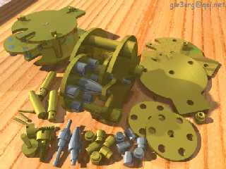

This was an engineering examination test piece. (A real life example
of required sharp edges ;) It has no other useful purpose*
Couple of days on the csg, mostly on the helix thread.
Weeks on the brass texture which still doesn't look right.
Bright sun-light on the left.
Objects in the room don't show very well despite brass reflection of
0.6 but they DO s****up the brass texture.
An 800*600 98k version is here:
http://www.peake42.freeserve.co.uk/pix1/tape.jpg
* Red Tape:
*Needlessly time-consuming procedure.
*The tape used in public offices for tying up documents, etc.; hence,
official formality and delay.
*The collection or sequence of forms and procedures required to gain
bureaucratic approval for something, especially when oppressively
complex and time-consuming.
Alf
http://www.qsl.net/gw3srg/
Download 'tape0.jpg' (40 KB)
Preview of image 'tape0.jpg'
Shiny metal gets most of its appearance from reflection, not diffuse
lighting. Try cranking the diffuse down to 0 and slowly increasing it
from there until it looks good.. also, from what I can see here, you
need a much stronger specular to simulate the reflection from strong
sunlight. You might even consider using photons for the reflective caustics.
-Xplo

I have had pretty good luck with metals by bringing the total luminosity of
the pigment way down and then using a relatively high reflection value.  See
my previously posted image.  Xplo is right ... you need to have it
reflecting something to make much of the effect.
Aaron

"Xplo Eristotle" <xpl### [at] infomagicnet> wrote in message
news:3fa6aa25@news.povray.org...
it
I'll try that again. This was my final brass texture.
texture{
   pigment{ rgb <1,0.9,0.35> }
   finish {
      ambient 0.2 // 0.1
      diffuse 0.6 // 0.2
      brilliance 4
      metallic
      specular 0.7 roughness 1/1000
      reflection{ 0.1, 0.6 metallic }
      conserve_energy
caustics.
I used photons but they are not very visible.
Thanks for advice
Alf

"Aaron Gillies" <no### [at] spamcom> wrote in message
news:3fa6aacf@news.povray.org...
luminosity of
value.  See
Your metal around the barrel looks very good.
Yes. The object is in a fairly "busy" room (fire, chairs, wall
pictures, TV, doors etc) but I think most of the reflections are of
the ceiling.
I'll play with it a little longer.
Thanks
Alf

Try an HDRI environment!
"Alf Peake" <alf### [at] peake42freeservecouk> wrote in message

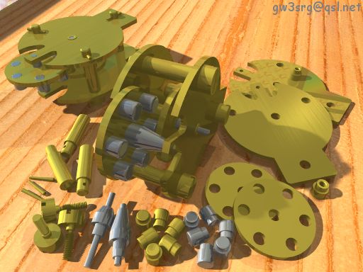

Yes, its on my "to try" list which is now long enough to reach the
moon :/
Some of the results I've seen posted here in p.b.i are amazing.
I've taken Xplo and Aaron's advice and the updated scene does look
better:
Alf

On Mon, 3 Nov 2003 21:26:53 -0000, "Alf Peake"
>caustics.
Photons will show much better if you increase the specular reflection.
Try something like reflection { <0.6, 0.5, 0.2> } (and lower the
diffuse pigment accordingly).

"Richard Callwood III" <ric### [at] yahoocom> wrote in message
news:rntiqv0tl83u3ek8eol2jmbh5dmus0rla6@4ax.com...
strong
reflective
> >caustics.
reflection.
I checked the "real life" scene yesterday in bright sun-light on the
wood table. I was surprised that the caustics could not be seen
against the lighter wood unless you looked very hard. I was sure there
should have been some :/
Alf
