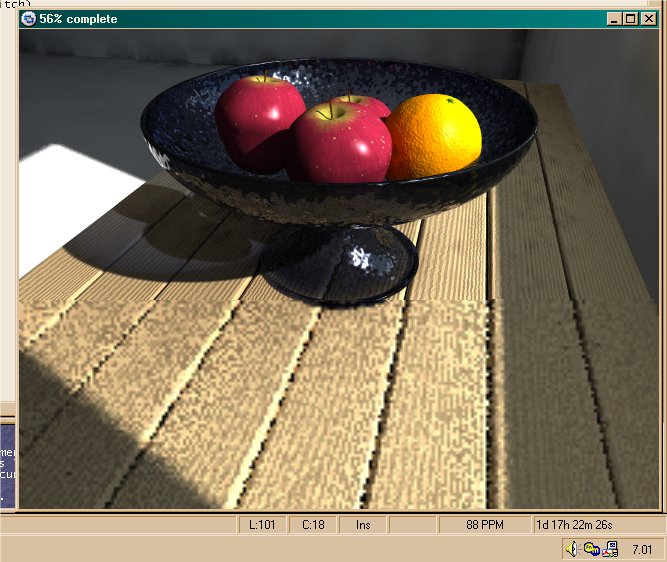

This was just meant to be a test render. Then time passed and I began to
realize that radiosity (even with not-so-extreme settings) doesn't get on
with glass. How is it possible? Is there something in the code that says
"hey, a transparent object! Make a 100000-steps-for()-loop for every pixel
to make it slower. Only the patient ones will deserve it!"? Is there a way
to speed up radiosity indoor scenes (possibly with glass)?
I'm not a patient one, so I killed the render after 41 hours of agony.
Jonathan.
Download 'pity.jpg' (80 KB)

Hmm, are those wood planks isosurfaces?
Glass with radiosity can be quite slow, but 1d17h is not very extreme for
such a scene.  I had a similar situation in my picture for the 10best
cover image contest and it came near a halt (~30min per line) on my old K6
when reaching the glass objects.  There were photons and a lot of
isosurfaces too of course.
Something that would really help in such a situation would be a
no_radiosity modifier for objects.  You could create a second bowl for
radiosity with no_image, no_shadow and no_reflection and a simple material
and use no_radiosity for the real bowl.
The fruits look great, apart from the leftmost apple floating in the air
of course.  Is there subsurface scattering on the orange?
From: JRG
Subject: Re: Radiosity and glass: utopia?
Date: 3 Nov 2001 06:18:15
Message: <3be3d277@news.povray.org>
Jaime Vives Piqueres wrote:
>  Remember: radiosity+glass+area_light+antialias>=infinite :)
Then radiosity+glass+area_light+antialias+isosurfaces...
>   A pain you killed it: but if it was just finishing the glass! The slow
> part was almost finished! Oh...
No. Every line was getting slower and slower, no matter how much glass the
line was passing through. I think that in radiosity scenes glass can
considerably slow down things even if it is behind the camera...
Jonathan.
From: JRG
Date: 3 Nov 2001 06:29:07
Message: <3be3d503@news.povray.org>
Yes, they are.
But it was a final render, not a simple test! :)
I have to say that with recursion_limit 1 things were a bit less slow, but
the unlit parts were completely black, so I had to raise it to 3.
Not to mention the fact that without the glass object the scene looked much
brighter (who knows why)...
What about rendering the scene without the glass, saving radiosity data, and
reloading them later with always_sample off and with the glass objects
included? Would it look good? I have to try.
> of course.
<Cough>... :)
Nope. The scattering with that iso was really slow and didn't look that
good. But with radiosity it looks good anyway.
Jonathan.
From: Kari Kivisalo
Date: 3 Nov 2001 07:35:54
Message: <3BE3E4B7.9CB25164@engineer.com>
Set glass or transparent objects like this when saving rad data:
no interior
no normal
no reflection
diffuse 0 ambient 0
filter/transmit only
Then set them back to normal and:
load_file "rad.dat" always_sample off pretrace_start 1 pretrace_end 1
diffuse 0 ambient 0 appeared to speed it most.
This was just from 10 minutes of testing so more quality may
be possible without increasing render time dramatically.

From: Kari Kivisalo
Date: 3 Nov 2001 10:30:02
Message: <3BE40D84.D84C38ED@engineer.com>
I did some more testing and this is good for glass when
saving rad data:
max_trace_level recursion_limit+1
diffuse 0 ambient 0
no normal
no reflection
Low res without aa is enough for the rad data.
Close beta 7 before rendering with the saved data. It was
very slow when rendering right after saving the rad data.
_____________

From: JRG
Date: 3 Nov 2001 11:51:31
Message: <3be42093@news.povray.org>
> saving rad data:
> diffuse 0 ambient 0
> no normal
> no reflection
I will try it for sure.
Even with high quality settings?
Hmm, is this a known bug of some sort?
Thanks for the hint,
Jonathan
From: Kari Kivisalo
Date: 3 Nov 2001 12:50:54
Message: <3BE42E83.2713BC38@engineer.com>
If you want to force rad sample for every pixel then
you must use final resolution but 1/2 - 1/3 resolution
should be enough for most scenes.
I haven't reported this yet due to lack of minimal scene
but I think there is a "using load_file after save_file
causes slowdown" bug which may be related to "restarting
while in pretrace causes slowdown" bug.
The combined rendertime for the rad and final scenes
was 1/8th of the one pass render for my test scene.
_____________
Kari Kivisalo
From: JRG
Date: 3 Nov 2001 12:59:38
Message: <3be4308a@news.povray.org>
I've rendered a 320x240 version for saving data, which took about 20
minutes. I followed your suggestions and I also turned off the area_light
and the displacement of the iso- wood planks.
Now I'm rendering the 640*480 version which seems quite fast. I will post
the result when finished.
I'm wandering how save_file and load_file work. I mean, if turn
always_sample off it shouldn't matter whether you use some radiosity
settings or some others, should it?
Jonathan.
