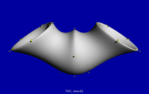

Here's a little peek at what I'm working on these days.
The image shows a bivariate NURBS surface together with
it's control points. A few of the control points (yellow
spheres) are not visible.
The two "straight" lines visible upon the surface of the
bend is caused by my mesh2 macro, which was not made for
surfaces with this kind of topology. (The normal is not
calculated correctly along these lines, but I'll probably
fix that soon.)
Tor Olav
Download 'b-splines03_03_.jpg' (16 KB)
Preview of image 'b-splines03_03_.jpg'

Although I do find NURBS interesting, I'm curious:
are they easy to visualize? I mean, do you have some
sort of external modeller for that, or are you using pure
POV and some other methods, like Wireframe etc?
Cause when I use POV, I need to either visualize things
very easily, or I need a lot of patience and trace a lot
of 360 degree views etc...
Tim Nikias
Tim,
I have barely used any modellers, so I have very little
experience with them. I like to write POV scripts instead.
When I'm working with NURBS, I first try to sketch on
paper the general shape that I want to make. (It also
happens that I am just curious about what shape a certain
macro will output.)
And then I try to figure out where I'll have to put the
control points (that will pull the surface towards them).
Then I call my NURBS and mesh macros and feed them with
the control points and the output from some macros that
generates different knot vectors and weights for the
control points.
When I see the output from this, I might adjust the
control points and their weights. Sometimes I also switch
to other knot macros (in order to have the surface to
"approach" the control points in a different "way".)
Tor Olav

If you really want to use NURBS, you'll have to use a modeller. That's way
easier. I guess it's worth the effort to build a patch for Moray or write a
Java application for this. But who's got the time?  ;-)
I absolutely like this stuff.
Apache

That's a very nice shape. It has something "useful" to it. Have you been
able to reduce the calculation time of your macros? The shape gives me an
idea: Maybe it's easy to make interesting lathes with nurbs. Something to
try out!
Hugo

now if you could get this to directly read the output from rhino, save
converting to a mesh a exporting etc etc

If Rhino outputs the control data for its NURBS into binary files, then
those files would be difficult (or impossible ?) to read with the POV SDL.
(In that case I think a file converter program would be needed.)
I have looked briefly at the proposed NURBS extension to VRML-97.
(http://www.blaxxun.com/developer/contact/3d/nurbs/spec/nurbsproposal.html)
- And I think that maybe I could adopt my macros to adhere as close
as possible to such a standard.
There's one great worry though: Trimming of NURBS. (To allow for
complex surface topologies.) - I fear that POV's SDL will be to slow for
this task.
Btw.:
I (and others) have already made macros that will export the meshes
(e.g. mesh2 or STL) produced by these parametric surface functions.
Tor Olav

The problem with my current NURBS macros is that they build HUGE functions.
(I.e.: These functions are slow to evaluate.)
In order to make some NURBS macros that builds smaller functions, I need a
set of macros that will will do calculations with matrices and polynomials.
I'm about to finish such a set of such support macros. It is a lot of work
to figure out how to make these macros efficient, easy to use and to decide
how to organize the data that "wanders" between them.
(I suspect that the time to build the functions will be longer. But since
the functions will be smaller and faster to evaluate; I expect that the
total parsing time will be shorter.)
> The shape gives me an idea: Maybe it's easy to make interesting lathes
> with nurbs. Something to try out!
I have have done some successful experiments lately with B-splines that
follows circular arcs. The next thing I will try to do is to make splines
that follows elliptical arcs (and other conic sections) and then use them
in NURBS surfaces.
So "advanced" lathes, extrusions and cross sections that follows splines
shouldn't thereafter be very difficult to do.
Tor Olav
