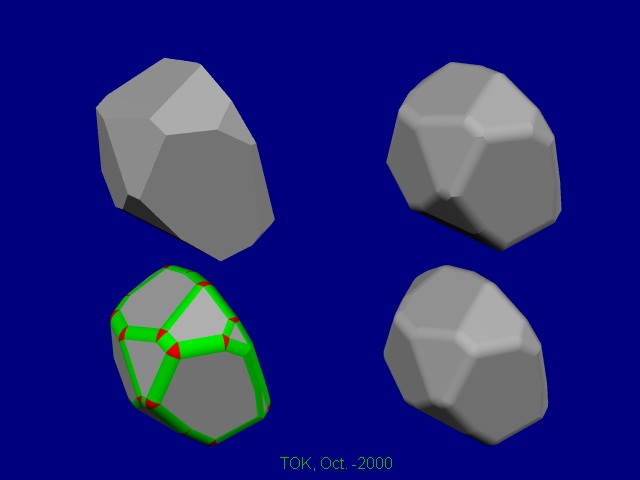

Yesterday I did some more work on some CSG-macros of mine.
They will "round off" any concave shape made with intersections
of planes, like the upper left shape.
The lower right shape shows how the resulting shape looks
like if both the edges and corners are wounded off.
The rendering is slow, so now I'm working on the macro
so that it will render much faster.
The upper right shape shows how the rounding looks like if
only the edges are rounded off.
And the lower left shape has different colours where "material"
has been "removed".
When I'm finished with the macros I'll post the source code
if anyone is interested.

From: John VanSickle
Subject: Re: Concave shapes (43KB)
Date: 5 Oct 2000 11:21:46
Message: <39DC9C88.54B9888F@erols.com>
Nota bene:  The shapes depicted are convex, not concave.
It's possible that making each face into a prism will help.  This
might be difficult, however.
John

"John VanSickle" <van### [at] erolscom> wrote in message
news:39DC9C88.54B9888F@erols.com...
Well, not if you put the camera inside  :-)
You're quite the wizard with this kind of thing Tor, manipulating CSG
objects.  I just wanted to say that.
Any chance this could merge with one of the rock making includes?  Then
again, if this is slow and the rock makers are already slow it might be too
much for the typical scene file.
If the amount of roundedness can be adjusted it certainly could do well for
worn edges of such shapes anyway.
looks good, how did you do it ? just CSG with planes, cylinders and spheres?
I suppose parsing will also be quite slow when working with complicated shapes.
> has been "removed".
Sure we are :-)
I estimate it's quite a lot of work doing it, so thanks in advance...

From: Tor Olav Kristensen
Date: 8 Oct 2000 18:30:52
Message: <39E0F57C.F4D1F1E0@hotmail.com>
Ugghh...  -How did that happen ?!
I even looked up convex in the dictionary
to make sure that this wasn't only a
norwegian word before I wrote the post.
> This might be difficult, however.
Yes I think you're right. I like that idea.
Prisms would probably make it faster.
It would not be very difficult. The needed
data are already available within my macros.
But it will be some work determining how
data should be passed between the different
macros in an efficient way.
There's one problem with prisms though:
The "stones" could not be used in further
CSG operations. E.g. like I did in my image;
"Two spheres" posted to this news group 26.
April:
news://news.povray.org/3906D341.F1CD358C%40online.no
The two metal spheres are put inside the
"space" cut out by a convex shape "rounded off"
by some preliminary versions of these macros.
Tor Olav
mailto:tor### [at] hotmailcom
Thank you !  - I'm flattered :)
I'll look into it. Where can I find these
rock making includes ?
The roundness can be adjusted by setting
a "rounding radius" for the corners and
the edges.
Tor Olav
Date: 8 Oct 2000 18:56:10
Message: <39E0FB6B.A7DFECE0@hotmail.com>
The starting (convex) shape is just
intersections of all the involved planes.
Then one macro takes info about these planes
and calculates where every possible triple
of non parallel planes meets at potential
corners (points).
Then another macro removes all the corners
that are "false" (I.e. those that have one
or more planes "below" themselves.)
Then some other macros receives the data
about the final "true" corners and
constructs the shapes (CSG with cylinders
and spheres) that are used to "subtract"
from the starting shape.
Yes, but not unbearable slow (as the pre-
liminary macros was).
> Sure we are :-)
Yes, there's a lot of info to manage within
the macro. But I've now manage to make them
much faster. But there's still some work
left to make them stop calculating the same
things over and over.
Maybe I can force myself to post some code
soon, even if I'm not satisfied with it yet.
Tor Olav
