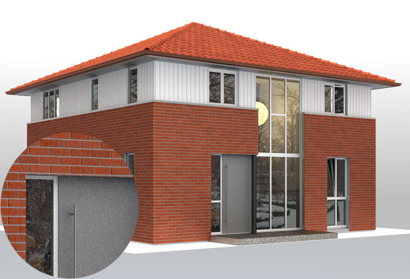

Greetings from Cologne!
May be, the following reflections are not new !?
May be just unnecessary or pesky!?
In this case give me a piece of your mind !
I've rarely gotten satisfactory results using (Mega)POV's radiosity.
Therefore, in my last projects, I add to almost all surfaces (except
perhaps the glass) MegaPov's "blurred reflection" - that is, what happens
in nature - it's true in opposite direction - but it's the habit of raytracing
anyway.
I'm quite happy with the results and it's easy to use.
With the few settings you have good control over the appearence of each
object and the results are correct, even in small details.
For most surfaces I use the following settings:
	reflection .5
	reflection_blur .5
	reflection_samples 50
	reflect_metallic 1
	and
	a bright hollow sphere or a sky_sphere to spend the diffuse light.
BUT, there are two faults, and they are the reasons for this posting:
	1) The granulation
	2) The slight shift of the diffuse reflections towards the camera
My suggestions are:
	Ad 1)
	I think, the granulation could be avoid by adding an option to the
	"blurred reflection", which switches off the randomness of the
	direction of the reflected rays in each point.
	So - each point of surface should get the same, regular bunch of
	rays. Perhaps such a bunch (reflection_samples) needs less
	samples, which will reduce the rendertime as well.
	Ad 2)
	The reflection shift could be avoid by using a blurred reflection
	(bunch of reflected rays), always PERPENDICULAR TO THE
	SURFACE, regardless of the visual angle between the surface
	and camera point.
I'm not experienced in changing and compiling source-code -
so, perhaps, perhaps, someone...!?
.. what shall I do?
Thank you for your patience!
I'm curious about reactions - and, of course, Help!
Tom Aust
www.aust-manufaktur.de
Download 'radtest.jpg' (99 KB)
Preview of image 'radtest.jpg'

The picture looks fairly interesting, but that does not really have much
to do with radiosity in fact.  As you mentioned the concept of reflections
in raytracing is limited to one direction so you might want to try photons
too.
I think some time ago someone suggested in p.g. that blurred reflection
and photons combined would be sufficient to generate realistic surfaces,
but the necessary amount of computations would be enormous.

  So what you want to achieve is, in fact, the radiosity algorithm used
by POV-Ray, but a LOT slower (because you want to calculate ALL the reflected
rays for EACH intersection point).

But this would cause artifacts (like when you use a 3x3 area_light without
jitter).
> and camera point.
You'll be happy to know that it's been done!
http://perso.wanadoo.fr/albedo/patchedpov.html
But you may want to look here:
http://perso.wanadoo.fr/albedo/cornell.html
to see what to expect for render times.
-Nathan
