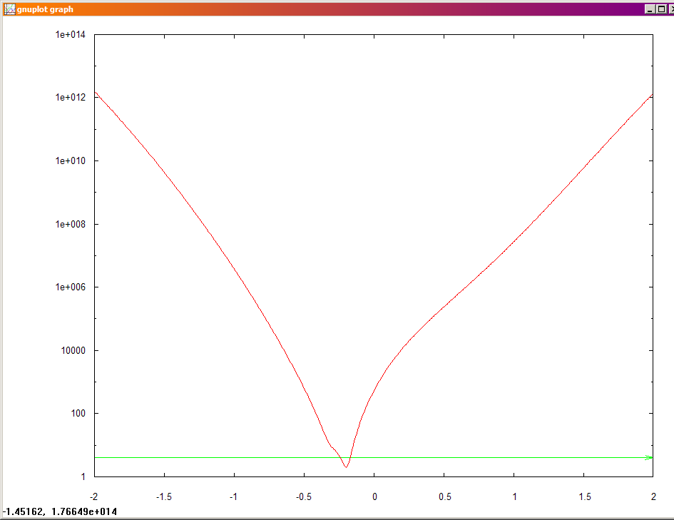

Attached is a graph of the function I'm trying to trace. (Note the
LOGARITHMIC Y SCALE!) The red line is the function. The green line is
the isosurface threshold. (i.e., the parts below that line are "inside",
and the parts about it are "outside".)
You can see why POV-Ray is struggling; on a linear scale, the graph is
two vertical lines with a flat part in the middle. So POV-Ray has to
tip-toe through space at some ridiculous spacing to be absolutely
certain that there isn't some vertical line in the graph taking us down
to a surface. If it was a different function, there might be. But for
this one, there isn't.
Currently POV-Ray has the maximum possible gradient. That is, the 1st
derrivative of the function's value with respect to space. I wonder -
would POV-Ray be able to do something more intelligent if it had the
maximum SECOND derrivative too? Then perhaps it would know that the
sides are very steep, but the steepness can't change very suddenly...
Hmm, no, that's still not much help.
Download 'graph1.png' (11 KB)
Preview of image 'graph1.png'
From: Thorsten Froehlich
Subject: Re: Isosurface speed
Date: 28 Aug 2006 10:34:38
Message: <44f2fefe$1@news.povray.org>
Orchid XP v3 wrote:
> Anybody have any further thoughts?
Post a minimal scene with the function, there might be ways to improve
render time.
	Thorsten

From: Orchid XP v3
Date: 28 Aug 2006 10:53:09
Message: <44f30355$1@news.povray.org>
>> However, since it's the isosurface of a 18th degree polynomial, I've had
>> to set max_gradient=exp(18) to get it to render correctly.
>   I suppose you have tried with a lower max_gradient and it resulted
> in an incorrect rendering?
Yes.
Specifically, a black image. (max_gradient=exp(17) renders with a few
holes. exp(16) gives a totally black picture.)
Have a look at the graph I posted. The sides of this function rise like
x^18, but the bit in the middle is quite "flat". Without the
astronomical max_gradient, POV-Ray samples the edge of the BB and sees a
value like 10^12 or something, and thinks "hey, no surface for miles
around" and doesn't find anything. But if you turn up the max_gradient
high enough to make POV-Ray take resonable size steps even when f=10^12,
then when you get to the middle POV-Ray start to take *minute* little
steps...
It seems I've found a very pathalogical case for the particular
algorithm POV-Ray is using. As I said, I'm not really sure what POV-Ray
could do differently here...

The high max_gradient makes POV-Ray take tiny little steps through the
nearly-zero areas. (But if you turn down the max_gradient, the high
values make POV-Ray take giant steps and completely miss the surface.)
The logarithm function is perfect here, because it makes big values
small, but doesn't change small values much. (The sqrt() function would
work too, but to a lesser extent.)
Problem #1 is going to be negative numbers. You'll have to bias the
function completely into positive space before attempting to take the
logarithm, and then bias the result back. This fails for functions that
zip of to minus infinity. (Actually, it's probably best to keep the
whole function above 1, rather than just above 0.)
Note that my solution works because the surface I'm actually trying to
draw is quite simple, it's just the maths is confusing POV-Ray. Not sure
what happens if the surface really *is* complicated - I suspect you
can't do too much about that...
