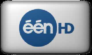

I am now using Povray to create so called picons, on a Dreambox satellite
receiver these icons are shown when you zap to a particular channel, so that you
see the channel logo when that channel is shown.
However, I'm trying to make them transparent, so that I could use any kind of
background and it would not be covered by the background of the picon.
What should be the best way to achieve this ?
The Dreambox expects an 8-bit paletted PNG file
Right now I create the image in TGA format in Povray with the +ua option, so
that the background is transparent.
Then I use Imagemagick to convert this image to GIF, thereby automatically
converting the 24 bit colour with 8 bit alpha channel to a 256 colour palette
file, then convert it with the same tool to PNG.
The result is far from perfect, though.
As you can see from the edges, the edges are rough because of this double
transformation.
I was wondering if there was a way to immediately create such an 8-bit paletted
PNG file from within Povray itself, or if there is another, better way to obtain
this result.
Does anyone know a way of doing this ?
Download '1_0_19_44f_b_1_ffff0000_0_0_0.png' (9 KB)
Preview of image '1_0_19_44f_b_1_ffff0000_0_0_0.png'
From: Patrick Elliott
Subject: Re: What 's best way of making this kind of image ?
Date: 17 Apr 2012 22:20:40
Message: <4f8e24f8$1@news.povray.org>
> transformation.
> this result.
Uh... Why not just set the output type to +FN8 +UA (F = file type, N =
PNG, 8 = 8 bit color, UA = Alpha output on)? I mean, assuming I didn't
misread the page on those settings... Mind, I have no idea of that is a
"paletted" map, but I would think that any converter you might use would
be doing the same thing at setting that color depth. I might be wrong
though.
From: clipka
Date: 18 Apr 2012 09:44:17
Message: <4f8ec531$1@news.povray.org>
Am 17.04.2012 19:54, schrieb zzzzzz:
Are you sure 24 bit PNG with 8 bit alpha channel doesn't cut it?
Of course - GIF supports only one single transparent palette entry. As
far as I know, PNG does support semi-transparent palette entries.
> transformation.
Can't you convert from TGA to 8-bit paletted PNG directly? I'd expect
Imagemagick to be able to do that stunt.
> this result.
POV-Ray does not support paletted image output in any format; the reason
is that there are plenty of different ways of choosing a suitable
palette, and plenty of different ways to dither the image, each with
their own strength and weaknesses, so we leave that job up to image
processing software as a post-processing step.
From: Warp
Date: 18 Apr 2012 10:53:57
Message: <4f8ed585@news.povray.org>
  In fact, calculating the optimal palette and dithering for a given
image is an extremenly difficult problem, and tons of papers have been
written about the subject. (It also depends on your definition of
"optimal". It's not unambiguous.)
                                                          - Warp

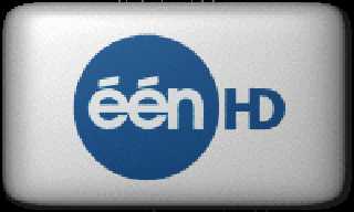

From: zzzzzz
Date: 20 Apr 2012 01:55:06
Message: <web.4f90f9b94795eda4b63966750@news.povray.org>
Yes, with a 24 bit PNG with 8 bit alpha channel it doesn't work.
An 8 bit indexed PNG works (with transparency or not, but on some skins it looks
better with transparency).
I am sure Imagemagick can do it, but the myriad of options was a bit too
difficult for me.
I can understand this reasoning.
Finally I found a way of doing it, I'm now creating a regular 24 bit PNG image
with alpha channel (+ua), and now I'm using PNGQUANT to convert it to an 8bit
indexed image, mainting transparency.
The result looks a lot better.
Download '1_0_19_44f_b_1_ffff0000_0_0_0.png' (10 KB)
