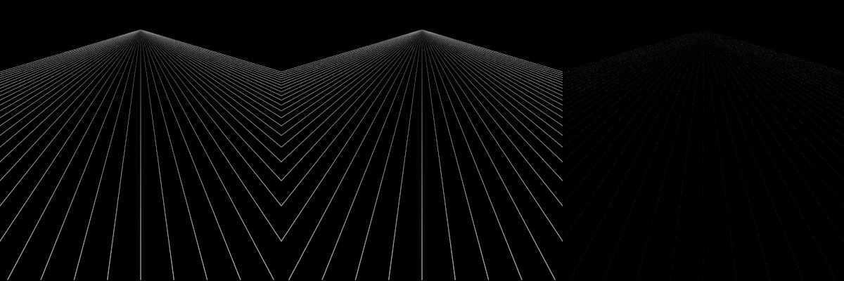

The yuqk fork returned to truly random jitter where the default of
jitter is off rather than the official V3.7 onward POV-Ray code where
antialiasing (AA) methods 1 and 2 jitter is always on - and any
randomness is predictive, but not purely gridded.
Further, it allows the jitter-ing to bounce outside the pixel - or bleed
into adjacent pixels - where the jitter amounts are >1.0. This ability
has thus far been called 'big jitter'.
I've now had some years playing with the 'improved jitter' in the yuqk
fork and while the yuqk fork is certainly more flexible, the results are
not always better depending upon the measure of goodness.

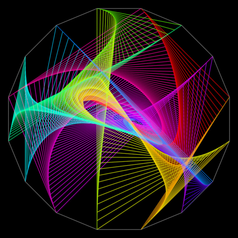

Using the Pursuit Curve code from Kurtz le pirate which was recently
posted on the POV-Ray forums, I've made an attempt to better formalize
some rough AA rules for using random/big jitter. See those rules below.
I've added to my yuqk fork to do list some ability to specify a minimum
recursive AA depth in addition to the maximum one. Thinking the options
and flag would be Antialias_Min_Depth=n and +RMn, respectively.
The 'lines' in the attached image have been fattened with a big jitter
rather than by increasing the radius of the cylinders. I believe this
will lead to better looking thumbnails for images of this type - FWIW.
Bill P.
October 31, 2023

Download 'courbesdepoursuite_c.jpg' (281 KB)
Preview of image 'courbesdepoursuite_c.jpg'
:-) Well, my thinking there was certainly not as right as I'd hoped with
respect to the POV-Ray web site's thumbnail mechanism!
Bill P.

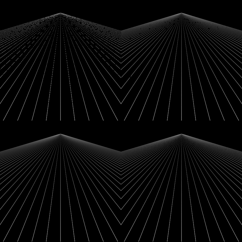

Added Antialias_Min_Depth=n ini / +RMn flag option for antialias methods
2 and 3(a). It can be thought of as a way to implement initial
non-adaptive AA sampling - better at resolving detail - prior to
adaptive AA. Will be available in R11 v0.6.5.0.
The attached image shows method 2 in the left column and method 3 in the
right column. The top row is what we get today without the ability to
initially force a minimum number of samples. The bottom row uses a
Antialias_Min_Depth of two and the results are substantially better for
both methods 2 and 3.
Method 2
yuqk hmmAA.pov +w400 +h400 +am2 +a0.035      +r6 +j3.33
yuqk hmmAA.pov +w400 +h400 +am2 +a0.035 +rm2 +r6 +j3.33
Method 3
yuqk hmmAA.pov +w400 +h400 +am3 +a0.035 +ac0.9      +r6 +ss12345
yuqk hmmAA.pov +w400 +h400 +am3 +a0.035 +ac0.9 +rm2 +r6 +ss12345
Credit Ton for the test scene from an issue report some years ago.
Aside: Method 1 is not adaptive so there is no point in specifying a
minimum Antialias depth. The depth value is the number of steps in x and y.
(a) - Reminder the yuqk fork has method 3 fixes which are not in any
official POV-Ray release. Fixes which in part prevent the implementation
from sometimes running in a non-adaptive manner; Where results look
good, but at the expense of the maximum number of samples specified by
+r being taken.
Download 'antialias_min_depth.png' (129 KB)
Preview of image 'antialias_min_depth.png'

William F Pokorny <ano### [at] anonymousorg> wrote:
Nice results :)
This reminded me of something I stumbled upon, and maybe it will help you come
up with some more sophisticated methods.
https://bgolus.medium.com/the-best-darn-grid-shader-yet-727f9278b9d8
http://iquilezles.org/articles/filtering/
https://iquilezles.org/articles/filterableprocedurals/
https://iquilezles.org/articles/checkerfiltering/
- BW
This sounds like a great feature for official POV!
Method 1 is adaptive in a minimal way:  If a pixel is not determined to require
anti-aliasing, it is not sub-sampled at all.  That is, unless this was changed
in POV-Ray 3.7, and the reference manual had not been updated to reflect the
change.  I did notice that 3.7 does a better job of method 1 anti-aliasing than
3.6 did, but it still doesn't appear to sub-sample every pixel.
Perhaps +AM1 +RMn can specify the sub-sampling depth for any pixel that is not
selected for anti-aliasing under the old algorithm.

On 1/11/24 11:08, Bald Eagle wrote:
> Nice results 🙂
Thanks - and thanks for the links. :-)
Bill P.
Hmm... Yeah. I guess up front I was thinking if folks wanted to force
the sub-sampling with method 1 they could specify a threshold of 0. I'll
ponder & perhaps play with your idea in code.
I confess to seldom using method 1 due the left / top directional bias.
Bill P.

On 1/11/24 17:22, William F Pokorny wrote:
> I'll ponder & perhaps play with your idea in code.
Well, I'm surprised. Your idea works well for somewhat complicated
reasons(a) over just setting the threshold to 0.0 in method 1 - where we
need to force more samples(b). Thanks for the prompt!
(a) - My guess is we might be a little more exposed to left top
directional artifacts on using min depth.
(b) - In scenes where we were almost always sub-sampling already the use

Attached more or less equivalent images (less random jitter) both using
method 1. Th difference image shown on the right. The left column image
is using:
yuqkB hmmAA.pov +w400 +h400 +d +p +am1 +a0.035 +rm4 +r6 +j1.33
and the samples / pixel come in at: 19.05
The middle column image is using:
yuqkB hmmAA.pov +w400 +h400 +d +p +am1 +a0.0 +r6 +j1.33
and the samples / pixel come in at: 33.80
