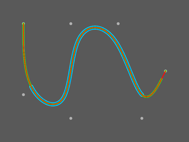

From: Tor Olav Kristensen
Subject: Re: Camera position for spline object
Date: 28 May 2022 15:55:00
Message: <web.62927c9e6b948b668051087f89db30a9@news.povray.org>
> On 2022-05-26 10:17 (-4), Tor Olav Kristensen wrote:
> > But I'm now wondering if the original poster used another spline type in the
> > other tool. The spline type in the POV-Ray code is "b_spline". But I've not been
> > able to find out what spline type that is supposed to be. I very much doubt that
> > it is the B-splines described here:
> > https://en.wikipedia.org/wiki/B-spline
> > Perhaps the b stands for Bezier (?) Maybe someone can verify this...
> POV-Ray's b_spline is indeed a 3rd degree B-spline.  I verified this a
> few years ago by plotting points derived by de Boor's algorithm against
> a POV-Ray b_spline.
Ok. I did the same test as you. It seems to be b-splines with a closed knot
vector. Their order is 4, i.e. 3rd degree (as you found) plus 1.
> I have a very poor understanding of what is going
> on mathematically, but I do know that b_spline is not a Bezier curve.
As Bill mentioned; B-spline curves are a superset of Bezier curves.
> I found the Wikipedia article quite confusing, especially since all of
> the illustrations have the curves intersecting the endpoints, yet de
> Boor's algorithm, which the article links to, does not produce this
> result.  I know that Bezier curves are related to B-splines, but I
> haven't figured out how.
To make B-splines intersect the endpoints, you can use open knot vectors.
Alternatively you can repeat the endpoints. To see how to do this,
have a look at the source code below and the attached image.
The file NURBS_29.inc in below can be found here:
http://news.povray.org/povray.binaries.scene-files/thread/%3Cweb.4c327e199f459e99c734aecd0%40news.povray.org%3E/
// ===== 1 ======= 2 ======= 3 ======= 4 ======= 5 ======= 6 ======= 7
#version 3.7;
global_settings { assumed_gamma 1.0 }
#include "colors.inc"
#include "NURBS_29.inc"
default {
    texture {
        pigment { color White }
        finish {
            diffuse 0
            emission color White
background { color Gray10 }
camera {
    orthographic
    location -5*z
#declare Size = 7;
#declare PP =
    array[Size] {
        <-3, +2,  0>, // 0
        <-3, -1,  0>, // 1
        <-1, -2,  0>, // 2
        <-1, +2,  0>, // 3
        <+1, +2,  0>, // 4
        <+2, -2,  0>, // 5
        <+3,  0,  0>  // 6
#declare Radius = 0.01;
union {
    ShowPoints1A3D(
        PP,  // Points1A3D
        false, // WrapU
        6*Radius  // Radius
    pigment { color Gray40 }
    translate +5*z
// Uniform B-Spline of order 4 with closed knot vector
sphere_sweep {
    b_spline
    Size,
    #for (I, 0, Size - 1)
        PP[I], 8*Radius
    #end // for
    tolerance 0.1
    pigment { color Cyan }
    translate +4*z
#declare Order = 4;
#declare Open = false;
// The circumstantial way
#macro B_Spline_Function1A(OrderU, KnotsU, Values1A)
    #local SizeU = Size1A(Values1A);
    #local BlendU_Fns = BlendFunctions(SizeU, OrderU, KnotsU);
    function(_t) {
        0
        #for (I, 0, SizeU - 1)
            #local C = Values1A[I];
            #switch (C)
                #case (-1)
                    -BlendU_Fns[I](_t)
                    #break
                #case (0)
                    #break
                #case (+1)
                    +BlendU_Fns[I](_t)
                    #break
                #else
                    +BlendU_Fns[I](_t)*C
            #end // switch
        #end // for
#end // macro B_Spline_Function1A
#declare KK =
    UniformKnotVector(
        Open,  // Open
        Order,  // Order
        Size  // NrOfPoints
// Closed: { -3/4,-2/4,-1/4, 0/4, 1/4, 2/4, 3/4, 4/4, 5/4, 6/4, 7/4 }
// Open:   {  0/4, 0/4, 0/4, 0/4, 1/4, 2/4, 3/4, 4/4, 4/4, 4/4, 4/4 }
#declare PPx = ExtractComponent1A(PP, x);
#declare PPy = ExtractComponent1A(PP, y);
#declare PPz = ExtractComponent1A(PP, z);
#declare B_Spline_FnX =
        Order,  // OrderU
        KK,  // KnotsU
        PPx  // Values1A
#declare B_Spline_FnY =
        Order,  // OrderU
        KK,  // KnotsU
        PPy  // Values1A
#declare B_Spline_FnZ =
        Order,  // OrderU
        KK,  // KnotsU
        PPz  // Values1A
union {
    ShowFunctions1A3D(
        B_Spline_FnX,  // xFn
        B_Spline_FnY,  // yFn
        B_Spline_FnZ,  // zFn
        false,  // WrapU
        0, // MinU
        1, // MaxU
        200,  // ResU
        6*Radius  // Radius
    pigment { color Blue }
    translate +3*z
// Alternative way,
// but now with 2 repeated points in both the beginning and the end.
#declare NewSize = Size + 4;
#declare QQ =
    array[NewSize] {
        PP[0], //  0
        PP[0], //  1
        PP[0], //  2
        PP[1], //  3
        PP[2], //  4
        PP[3], //  5
        PP[4], //  6
        PP[5], //  7
        PP[6], //  8
        PP[6], //  9
        PP[6]  // 10
// Uniform B-Spline
union {
    Show_UBS_1A3D(
        QQ,  // Points1A3D
        Open,  // OpenU
        Order,  // OrderU
        false,  // WrapU
        200,  // ResU
        2*Radius  // Radius
    pigment { color Red }
    translate +1*z
// Now check if also the built in B-spline sphere sweep can be
// tricked into reaching the points in the beginning and the end.
sphere_sweep {
    b_spline
    NewSize,
    #for (I, 0, NewSize - 1)
        QQ[I], 4*Radius
    #end // for
    tolerance 0.1
    pigment { color Green }
    translate +2*z
Tor Olav
http://subcube.com
https://github.com/t-o-k
Download 'b_spline_sphere_sweep.png' (33 KB)
Preview of image 'b_spline_sphere_sweep.png'

> > Or is it just trial and error? Can someone please help me to get the proper
> > camera setup so as to obtain the figure attached:
> The points in your sphere_sweep don't plot the figure in the screen
> shot, the points form a more or less straight line in the z direction.
> (1.png) (Points 5 & 6 are the same.)
> Looking again at the screen shot, I notice that the 3 axes are at
> different scales. If I apply scaling and rotation to the points I can
> get something like your figure. Scale = <200,10,1> rotate<0,90,0> (2.png)
> Note that I have moved the camera to <0,0,-200>, looking at <0,0,0>. I
> find it easier to keep track of x,y,z if the camera is in the minus z
> position.
> If you want a point for the camera to look at, you can find the mean
> center of your plot thus:
>   #declare Thing_max = max_extent(Thing);
>   #declare Thing_min = min_extent(Thing);
>   #declare Thing_centre = (max_extent(Thing) + min_extent(Thing))/2;
> (Red sphere)
> #include"colors.inc"
>   camera {
>      //location <-0.0872 , -1.8850 ,   4.8301 >*3.5
>      location <0,0,-200>
>      look_at <0,0,0>
>      angle 22
> light_source { <100,100,-100>  color rgb<1,1,1> }
> background {color rgb<0.5,0.5,0.5> }
> #declare Scale = <200,10,1>;
> //#declare Scale = <1,1,1>;
> #declare P01 = Scale*< 0,         0,         -20>;
> #declare P02 = Scale*< 2.583e-09,-2.7093e-08, 3>;
> #declare P03 = Scale*< 0.075646, -0.91834,    8.9288>;
> #declare P04 = Scale*< 0.076898, -2.3756,    14.7492>;
> #declare P05 = Scale*<-0.15231,  -4.2038,    20.4593>;
> #declare P06 = Scale*<-0.15231,  -4.2038,    20.4593>;
> #declare Thing = union{
>      sphere{P01 0.9 pigment{rgb<0,1,0>}}
>      sphere{P02 0.9 pigment{rgb<0,1,0>}}
>      sphere{P03 0.9 pigment{rgb<0,1,0>}}
>      sphere{P04 0.9 pigment{rgb<0,1,0>}}
>      sphere{P05 0.9 pigment{rgb<0,1,0>}}
>      sphere{P06 0.5 pigment{rgb<0,1,0>}}
>          sphere_sweep {
>           //b_spline
>           linear_spline
>           6,
>               P01,0.5,
>               P02,0.5,
>               P03,0.5,
>               P04,0.5,
>               P05,0.5,
>               P06,0.5
>           tolerance 0.1
>           texture{ pigment{ color rgb<0.69,0.99,0.15>}
>            finish { phong 1
>             ambient 0.3
>           //scale<2,2,0.35>   rotate<-90,0,0>  translate<0,-2,3>
> //rotate<0,90,0>
> rotate<-90,0,0>
> sphere{Thing_centre, 1.5 pigment{rgb<1,0,0>} rotate<0,360*clock,0>}
> //box{Thing_min, Thing_max pigment{rgbt<1,0,0,0.8>}
> object{Thing rotate<0,360*clock,0>}

Thank you so much for the help and really sorry I was not able to reply to
everyone as I met with an accident and now I am fit to work. So, I made the
changes in my code and got the following results( please refer to the picture
attached ). So if you see the green object appears to be smaller in length
compared to the white object. Is there a way to restrict the length of the
spline object such that it does not change when the control points move and only
the curvature changes?
To make more sense of what I mean by that, please refer to the website :
https://www.cosseratrods.org/videos/RALvideos/Case2-front_view_web.mp4
Download 'pyel1.png' (15 KB)
Preview of image 'pyel1.png'
