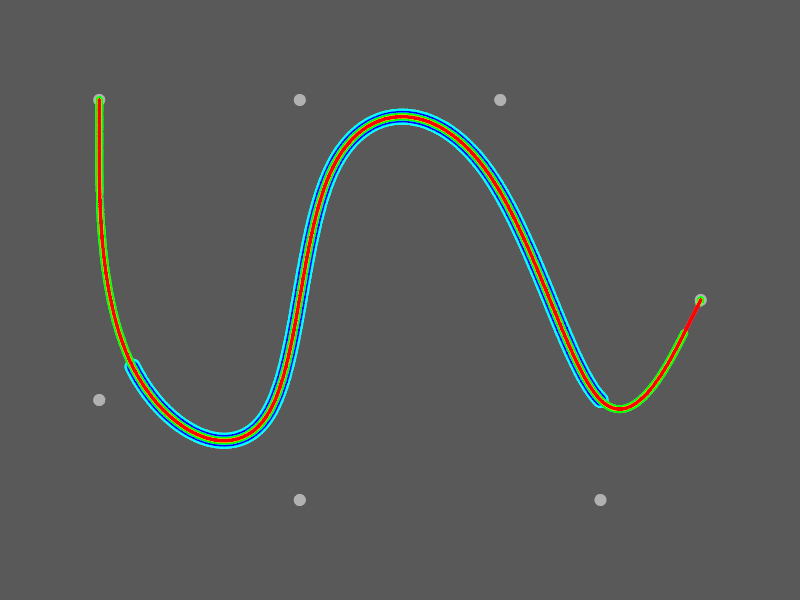

From: Tor Olav Kristensen
Subject: Re: Camera position for spline object
Date: 28 May 2022 15:55:00
Message: <web.62927c9e6b948b668051087f89db30a9@news.povray.org>
> On 2022-05-26 10:17 (-4), Tor Olav Kristensen wrote:
> > But I'm now wondering if the original poster used another spline type in the
> > other tool. The spline type in the POV-Ray code is "b_spline". But I've not been
> > able to find out what spline type that is supposed to be. I very much doubt that
> > it is the B-splines described here:
> > https://en.wikipedia.org/wiki/B-spline
> > Perhaps the b stands for Bezier (?) Maybe someone can verify this...
> POV-Ray's b_spline is indeed a 3rd degree B-spline.  I verified this a
> few years ago by plotting points derived by de Boor's algorithm against
> a POV-Ray b_spline.
Ok. I did the same test as you. It seems to be b-splines with a closed knot
vector. Their order is 4, i.e. 3rd degree (as you found) plus 1.
> I have a very poor understanding of what is going
> on mathematically, but I do know that b_spline is not a Bezier curve.
As Bill mentioned; B-spline curves are a superset of Bezier curves.
> I found the Wikipedia article quite confusing, especially since all of
> the illustrations have the curves intersecting the endpoints, yet de
> Boor's algorithm, which the article links to, does not produce this
> result.  I know that Bezier curves are related to B-splines, but I
> haven't figured out how.
To make B-splines intersect the endpoints, you can use open knot vectors.
Alternatively you can repeat the endpoints. To see how to do this,
have a look at the source code below and the attached image.
The file NURBS_29.inc in below can be found here:

// ===== 1 ======= 2 ======= 3 ======= 4 ======= 5 ======= 6 ======= 7
#version 3.7;
global_settings { assumed_gamma 1.0 }
#include "colors.inc"
#include "NURBS_29.inc"
default {
    texture {
        pigment { color White }
        finish {
            diffuse 0
            emission color White
background { color Gray10 }
camera {
    orthographic
    location -5*z
#declare Size = 7;
#declare PP =
    array[Size] {
        <-3, +2,  0>, // 0
        <-3, -1,  0>, // 1
        <-1, -2,  0>, // 2
        <-1, +2,  0>, // 3
        <+1, +2,  0>, // 4
        <+2, -2,  0>, // 5
        <+3,  0,  0>  // 6
#declare Radius = 0.01;
union {
    ShowPoints1A3D(
        PP,  // Points1A3D
        false, // WrapU
        6*Radius  // Radius
    pigment { color Gray40 }
    translate +5*z
// Uniform B-Spline of order 4 with closed knot vector
sphere_sweep {
    b_spline
    Size,
    #for (I, 0, Size - 1)
        PP[I], 8*Radius
    #end // for
    tolerance 0.1
    pigment { color Cyan }
    translate +4*z
#declare Order = 4;
#declare Open = false;
// The circumstantial way
#macro B_Spline_Function1A(OrderU, KnotsU, Values1A)
    #local SizeU = Size1A(Values1A);
    #local BlendU_Fns = BlendFunctions(SizeU, OrderU, KnotsU);
    function(_t) {
        0
        #for (I, 0, SizeU - 1)
            #local C = Values1A[I];
            #switch (C)
                #case (-1)
                    -BlendU_Fns[I](_t)
                    #break
                #case (0)
                    #break
                #case (+1)
                    +BlendU_Fns[I](_t)
                    #break
                #else
                    +BlendU_Fns[I](_t)*C
            #end // switch
        #end // for
#end // macro B_Spline_Function1A
#declare KK =
    UniformKnotVector(
        Open,  // Open
        Order,  // Order
        Size  // NrOfPoints
// Closed: { -3/4,-2/4,-1/4, 0/4, 1/4, 2/4, 3/4, 4/4, 5/4, 6/4, 7/4 }
// Open:   {  0/4, 0/4, 0/4, 0/4, 1/4, 2/4, 3/4, 4/4, 4/4, 4/4, 4/4 }
#declare PPx = ExtractComponent1A(PP, x);
#declare PPy = ExtractComponent1A(PP, y);
#declare PPz = ExtractComponent1A(PP, z);
#declare B_Spline_FnX =
        Order,  // OrderU
        KK,  // KnotsU
        PPx  // Values1A
#declare B_Spline_FnY =
        Order,  // OrderU
        KK,  // KnotsU
        PPy  // Values1A
#declare B_Spline_FnZ =
        Order,  // OrderU
        KK,  // KnotsU
        PPz  // Values1A
union {
    ShowFunctions1A3D(
        B_Spline_FnX,  // xFn
        B_Spline_FnY,  // yFn
        B_Spline_FnZ,  // zFn
        false,  // WrapU
        0, // MinU
        1, // MaxU
        200,  // ResU
        6*Radius  // Radius
    pigment { color Blue }
    translate +3*z
// Alternative way,
// but now with 2 repeated points in both the beginning and the end.
#declare NewSize = Size + 4;
#declare QQ =
    array[NewSize] {
        PP[0], //  0
        PP[0], //  1
        PP[0], //  2
        PP[1], //  3
        PP[2], //  4
        PP[3], //  5
        PP[4], //  6
        PP[5], //  7
        PP[6], //  8
        PP[6], //  9
        PP[6]  // 10
// Uniform B-Spline
union {
    Show_UBS_1A3D(
        QQ,  // Points1A3D
        Open,  // OpenU
        Order,  // OrderU
        false,  // WrapU
        200,  // ResU
        2*Radius  // Radius
    pigment { color Red }
    translate +1*z
// Now check if also the built in B-spline sphere sweep can be
// tricked into reaching the points in the beginning and the end.
sphere_sweep {
    b_spline
    NewSize,
    #for (I, 0, NewSize - 1)
        QQ[I], 4*Radius
    #end // for
    tolerance 0.1
    pigment { color Green }
    translate +2*z
Tor Olav
http://subcube.com
https://github.com/t-o-k
Download 'b_spline_sphere_sweep.png' (33 KB)
Preview of image 'b_spline_sphere_sweep.png'

> > Or is it just trial and error? Can someone please help me to get the proper
> > camera setup so as to obtain the figure attached:
> The points in your sphere_sweep don't plot the figure in the screen
> shot, the points form a more or less straight line in the z direction.
> (1.png) (Points 5 & 6 are the same.)
> Looking again at the screen shot, I notice that the 3 axes are at
> different scales. If I apply scaling and rotation to the points I can
> get something like your figure. Scale = <200,10,1> rotate<0,90,0> (2.png)
> Note that I have moved the camera to <0,0,-200>, looking at <0,0,0>. I
> find it easier to keep track of x,y,z if the camera is in the minus z
> position.
> If you want a point for the camera to look at, you can find the mean
> center of your plot thus:
>   #declare Thing_max = max_extent(Thing);
>   #declare Thing_min = min_extent(Thing);
>   #declare Thing_centre = (max_extent(Thing) + min_extent(Thing))/2;
> (Red sphere)
> #include"colors.inc"
>   camera {
>      //location <-0.0872 , -1.8850 ,   4.8301 >*3.5
>      location <0,0,-200>
>      look_at <0,0,0>
>      angle 22
> light_source { <100,100,-100>  color rgb<1,1,1> }
> background {color rgb<0.5,0.5,0.5> }
> #declare Scale = <200,10,1>;
> //#declare Scale = <1,1,1>;
> #declare P01 = Scale*< 0,         0,         -20>;
> #declare P02 = Scale*< 2.583e-09,-2.7093e-08, 3>;
> #declare P03 = Scale*< 0.075646, -0.91834,    8.9288>;
> #declare P04 = Scale*< 0.076898, -2.3756,    14.7492>;
> #declare P05 = Scale*<-0.15231,  -4.2038,    20.4593>;
> #declare P06 = Scale*<-0.15231,  -4.2038,    20.4593>;
> #declare Thing = union{
>      sphere{P01 0.9 pigment{rgb<0,1,0>}}
>      sphere{P02 0.9 pigment{rgb<0,1,0>}}
>      sphere{P03 0.9 pigment{rgb<0,1,0>}}
>      sphere{P04 0.9 pigment{rgb<0,1,0>}}
>      sphere{P05 0.9 pigment{rgb<0,1,0>}}
>      sphere{P06 0.5 pigment{rgb<0,1,0>}}
>          sphere_sweep {
>           //b_spline
>           linear_spline
>           6,
>               P01,0.5,
>               P02,0.5,
>               P03,0.5,
>               P04,0.5,
>               P05,0.5,
>               P06,0.5
>           tolerance 0.1
>           texture{ pigment{ color rgb<0.69,0.99,0.15>}
>            finish { phong 1
>             ambient 0.3
>           //scale<2,2,0.35>   rotate<-90,0,0>  translate<0,-2,3>
> //rotate<0,90,0>
> rotate<-90,0,0>
> sphere{Thing_centre, 1.5 pigment{rgb<1,0,0>} rotate<0,360*clock,0>}
> //box{Thing_min, Thing_max pigment{rgbt<1,0,0,0.8>}
> object{Thing rotate<0,360*clock,0>}
