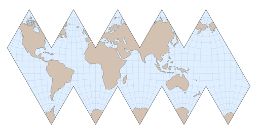

I am going mad trying to project image maps onto polygons that are not in the
x-y plane or plumb to the y axis. I have 20 equilateral triangles forming a
typical D20 shape (regular icosahedron). I have the XYZ coordinates for the
points so all I have to do is create each triangle using sets of the 32
vertices. BUT . . . .
I cannot work out how to project the 20 image_map pigments properly. Image_map
pigments only seem to work on polygons normal to the Z axis and left corner at
0,0 XY
The suggestion that I create each triangle at 0,0 and then translate/rotate them
to the icosahedron would be just fine if i had those numbers. (I do not)
There must exist another way, as the current limitation is ludicrously
un-useful. Everybody aplying pictures to polyhedra would have exactly the same
problem.
What am I missing?
Is it possible to translate the triangle by translating its individual points?
That I might be able to do, but I can't work out how.
The ultimate goal is a Dymaxion type world map on an Icosahedron.
Download 'test-ico.png' (62 KB)
Preview of image 'test-ico.png'

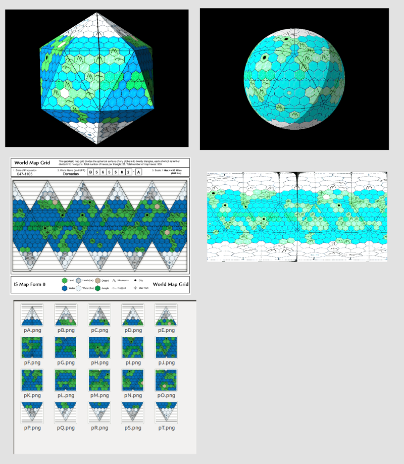

From: Molly-J
Subject: Re: image_map to tilted and rotated triangle centered and scaled
Date: 29 Mar 2022 16:15:00
Message: <web.624367b3ccfe29009cded0992eac0897@news.povray.org>
Thank you everyone for all that help.
I worked out how to do it after re-reading your posts carefully. I had to break
out the geometry/trigonometry skills to derive the angles from xyz coordinates.
there seems to be no other way.
unless there is . . . .
Is there a povray function that returns polar coordinates of a surface's normal?
eg. create a polygon my_polygon at xyz xyz xyz and then ask--
let lat/lon = normal(my_polygon)
Download 'tutorial-00.png' (505 KB)

Hi again Molly
I've now made a couple of GitHub repositories that may be useful for you.
Here you can find the vertices and the triangles that you need:
https://github.com/t-o-k/POV-Ray-icosahedron
Here you can see how you can UV-map parts of an image onto a mesh2:
https://github.com/t-o-k/POV-Ray-UV-mapping-of-mesh2
And here you can download images suitable for being mapped onto an icosahedron:
https://solarviews.com/cap/ico/icoearth.htm
Tor Olav
