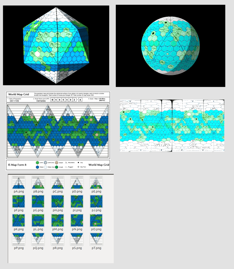

From: Molly-J
Subject: Re: image_map to tilted and rotated triangle centered and scaled
Date: 29 Mar 2022 16:15:00
Message: <web.624367b3ccfe29009cded0992eac0897@news.povray.org>
Thank you everyone for all that help.
I worked out how to do it after re-reading your posts carefully. I had to break
out the geometry/trigonometry skills to derive the angles from xyz coordinates.
there seems to be no other way.
unless there is . . . .
Is there a povray function that returns polar coordinates of a surface's normal?
eg. create a polygon my_polygon at xyz xyz xyz and then ask--
let lat/lon = normal(my_polygon)
Download 'tutorial-00.png' (505 KB)
