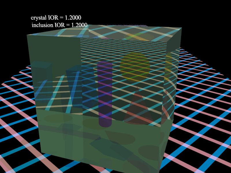

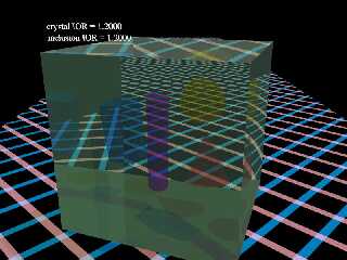

From: Kenneth
Subject: Re: Transparent Objects Become Black
Date: 17 Nov 2021 16:10:00
Message: <web.61956cb028696f324cef624e6e066e29@news.povray.org>
> Kenneth, I have not tested it here, but are the 'voids' really
> necessary? Is it not enough to just add the bubbles to the gel, as both
> have different ior's and do not interact?
Apparently, the visual result is exactly the same either way.
Here is my own "poor man's crystal", ha-- just an intersection of three rotated
boxes. The inclusions are simple shapes. I rendered two versions, with the
inclusions as a UNION with the crystal vs. being DIFFERENCED from it as voids. I
see absolutely no visual change, although I was expecting them to look
completely different. It seems that the ior 'effect' depends only on the
*surfaces* that the camera ray sees, not really on any imagined interior
substance of the inclusions.
I have not yet tested my scene to discover how the different iors affect each
other-- i.e., simple addition vs. multiplication of the iors. That's difficult
to tell, visually. I suspect that it's just addition.
Date: 18 Nov 2021 07:27:27
Message: <619646af@news.povray.org>
Op 17-11-2021 om 22:06 schreef Kenneth:
Yes, that confirms my guess. You didn't say, but I suppose that the
'union' renders faster than the 'difference'. Additionally, using blobs
as inclusions, especially if there are many of them, will speed up
render time.
I am not sure. It looks like that - independent from ior - the used
media inside container and inclusions are treated separately. In my
experiments I do no see any cross-influence, addition or multiplication,
of colors.

This situation is not quite what I originally thought, although it *is* simple
addition, in a different form:  From further tests, I see that the different
iors interact like this example:
              crystal ior (the container): 1.2
              inclusion ior: 1.2
When they are the *same*, the inclusions do not show any 'additional' ior effect
-- like an additional 0.2 for themselves, above the container's 1.2-- but just
the overall ior of 1.2... as if the container and the inclusions are all "made
from the same material" (whether as a union or a difference).  I guess that I
should have expected this-- it seems obvious now-- although I originally thought
that the inclusions would show 1.2 + 0.2 = 1.4.
BTW, I also discovered something interesting along the way:
An ior of 0.0 is the same as ior 1.0. This has actually confused me in the
past-- because 'negative' iors ( < 1.0 and even < 0.0) can be used for
interesting effects, but there is this unexpected  'glitch' at exactly 0.0.
Download 'identical_iors_jpeg_file.jpg' (75 KB)
Preview of image 'identical_iors_jpeg_file.jpg'

The refraction depends on the ratio of the iors on each sides of the
surface. What you see is what is expected and observed in nature.
I've experienced with negative ior. That makes the surface behave as if
it had
finish{ reflection 1 }
When you think about it, it makes sense. The ior is the ratio of the
speed of light in a vacuum divided by the speed of light in a medium.
A negative ior demand a negative speed of light in that medium.

That's an interesting observation. With my own tests here, I was not sure a
'negative' ior was having any effect when lower than 0.5-- until I re-positioned
the crystal and camera 'just so'. Then I could see at least my sphere inclusion
subtly changing its appearance as the ior decreased. But as a practical matter,
the more negative it goes, the less of a visual change there is.
