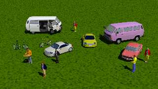

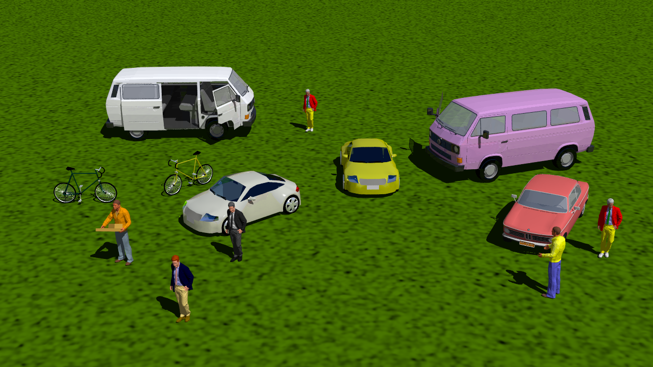

From: Maetes
Subject: Re: A little help about old vers.
Date: 24 Jun 2025 05:20:00
Message: <web.685a6d20ce24a8bb27cb80c430225ff5@news.povray.org>
Here an image will all models
ma
Download 'test_all_01.png' (807 KB)
Preview of image 'test_all_01.png'
From: GioSeregni
Date: 24 Jun 2025 18:10:00
Message: <web.685b2134ce24a8bba9a8e10259126100@news.povray.org>
> ma
very nice!
