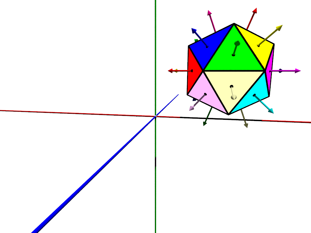

Not that you don't have enough to do, but you might consider the option of
writing the centers of the triangles and the normals of those faces to disk, in
case anyone would find that data to be useful.  (I'm thinking of Voronoi over
the surface of the mesh, and/or using your utility to display normal directions
for debugging or educational/illustrative/debugging purposes.

Also make sure you have the utility write an "inside vector" so that the mesh
can be used in CSG.

I'm not sure how the mesh2 code works under the hood, but I'm wondering if a
vertex-order checking needs to be done to ensure the proper ordering of the
vertices so that the face normals are in the correct direction.

I've tested my normal calculations with a tetrahedron, cube, octahedron, and
icosahedron. I have macros to check handedness of the triangle vertex order,
correct wrong ones, and calculate face normals that always point outward.
Works in all eight octants.
I have yet to make / test a concave mesh, and some code may be superfluous,
while other parts may need a bit of extra checking.
Definitely had a few bonehead mistakes and head-scratchers that I managed to
experiment my way out of along the way.
I'm sure there's still lots more to learn if I get around to testing any of this
on a more complicated mesh like the bunny, buddha, dragon, etc.
Unlike jr, I'm terrible with data structures, so I have no idea how to go about
efficiently checking for holes, duplicates, etc.
Download 'surfacenormals.png' (58 KB)
Preview of image 'surfacenormals.png'
