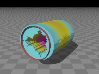

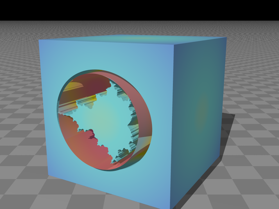

I'd expected that the areas "far outside" of the Mandelbrot set (outside
of the red cylinder) would have "low" values, so they are far "outside"
of the isosurface. But they aren't, so the result is that the whole
contained_by box is filled.
Is it a bug how mandel pattern & isosurface work together or is the bug
in my scene file? :-/
Lars R.
Download 'mandel.pov.txt' (2 KB) Download 'mandel.png' (171 KB)

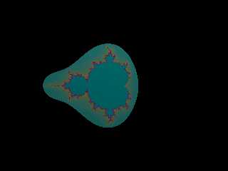

It looks like the pattern drops off to zero.
Maybe try adding "open" to your isosurface statement.
https://wiki.povray.org/content/Reference:Isosurface
"When the isosurface is not fully contained within the contained_by object,
there will be a cross section. When this happens, you will see the surface of
the container. Using the open keyword, these cross section surfaces are removed,
and the inside of the isosurface becomes visible.
Note: Using open slows down the render speed, and it is not recommended for use
with CSG operations."
Might have to add "all_intersections" as well, if things still don't look good.
(just guessing)

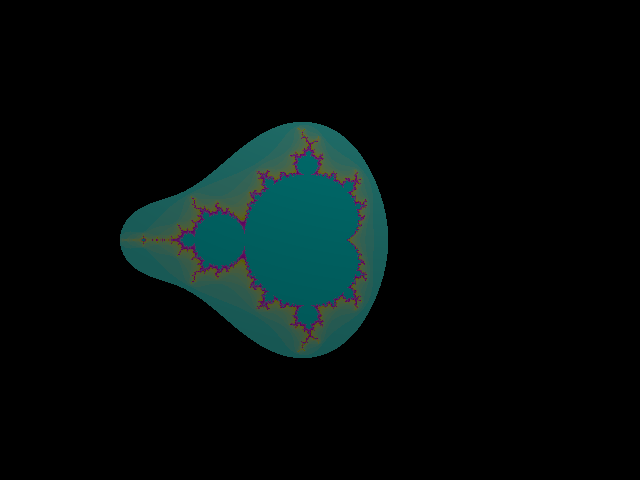

Here's the pattern with 1000 iterations on an xy plane.
Download 'mandeltest.png' (29 KB)
Preview of image 'mandeltest.png'

Correct.
According to the documentation of isosurface, all points with function
value  < threshold are "inside" the isosurface object.
The "mandel" pattern is "low" (near zero) far away from the Mandelbrot
set, increases slowly near the border of the set and is 1 inside the
"apple shape" set itself (with default values for "interior" and "exterior".
So I had expected that a formula like 0.9 - mandel would give the
desired result:
   * the points inside the Mandelbrot set will be <0, so are consideded
as "inside" the rendered shape.
   * the points far away of the Mandelbrot set will be >0, so are
"outside" of the rendered shape.

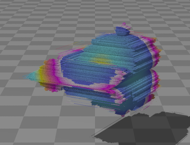

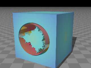

But the rendering looks completely different than expected, see attached
Changing the formula to 0.5-mandel2(x,y,z) it looks much more than a
Mandelbrot set, but it is "inverse": the Mandelbrot set is "outside",
the surrounding areay is inside. Hence I switched the sign, so the
forumla becomes mandel(x,y,z)-0.5.
So the inside of the Mandelbrot set becomes the inside of the
isosurface, as expected, but also the far away areas are "inside", which
is _not_ what I expected.
What went wrong here?
Lars R.
pS: The "open" keyword just removes the visibility of the contained_by
object, but I consider it helpful to see what is insided and what it is
outside of the isosurface object.
Download 'mandel-0.5.png' (25 KB) Download 'mandel-0.9.png' (20 KB)
Preview of image 'mandel-0.5.png'
Preview of image 'mandel-0.9.png'

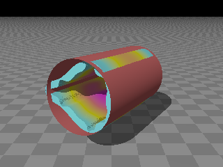

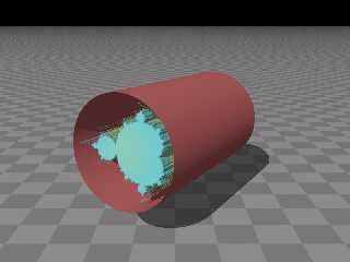

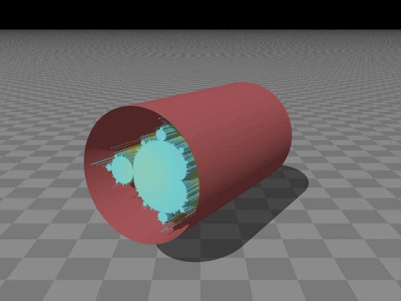

Thank you a lot! Changing the color map into a stupid black-to-white
ramp solves the problem.
See attached .pov files and renderings.
> Maybe you post your full scene as an attachment, and someone can
> figure this out.
I did it in my original posting.
Thanks again and enjoy the renderings (or use them as inspirations for
own "weird christmas tree" ideas. ;-)
Lars R.
Download 'mandel.pov.txt' (2 KB) Download 'mandel.png' (145 KB) Download 'mandel2.pov.txt' (2 KB) Download 'mandel2.png' (201 KB)
Preview of image 'mandel.png'
Preview of image 'mandel2.png'

        pigment {
            mandel 1000
            color_map {
                [ 0.0 color rgb <0, 0, 0> ]
                [ 0.2 color rgb <1, 0, 0> ]
                [ 0.4 color rgb <1, 1, 0> ]
                [ 1.0 color rgb <1, 1, 1> ]
                [ 1.0 color rgb <0, 0, 0> ]
- or like this:
    #declare MandelFn = function { pattern { mandel 1000 } };
    plane {
        +z, 0
        pigment {
            function { MandelFn(x, y, z) }
            color_map {
