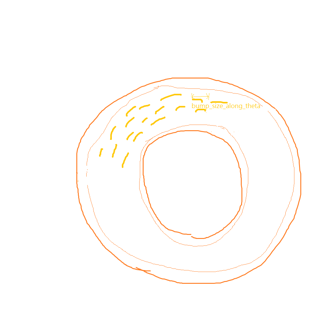

The 'macro' which I should introduce is
generate_thin_circled_pattern_f_input_t_theta_h(
first_time, last_time, d_boundary_time0, d_boundary_time1, t_radial_bump_size,
time_node_amount,
bump_size_along_theta, theta_pos_random_factor,
min_h, max_h, d_boundary_h0, d_boundary_h1,
seed_m,
r_vs_t, h_vs_r_ratio
It is located at bump_pattern_base_function_macros.inc
The goal of it is to generate thin pattern, just like f_bumps(x,y,z).
But it is on the different coordinate system(I say that 'tree log coordinate' in
this case), this macro just generate an output_f = function(time, theta, h) {
It generate bumps along theta by generating an position array[seg_amount] during
0~2*pi, it consult the input 'bump_size_along_theta' to determine the
seg_amount, the shorter the bump size, the larger the seg_amount.
'theta_pos_random_factor' controls the randomize of the positions. When it is
zero, the position is equally spaced on theta, when it is 1, the position has
the max randomize.
Download 'generate pattern macro var_theta.png' (38 KB)
Preview of image 'generate pattern macro var_theta.png'

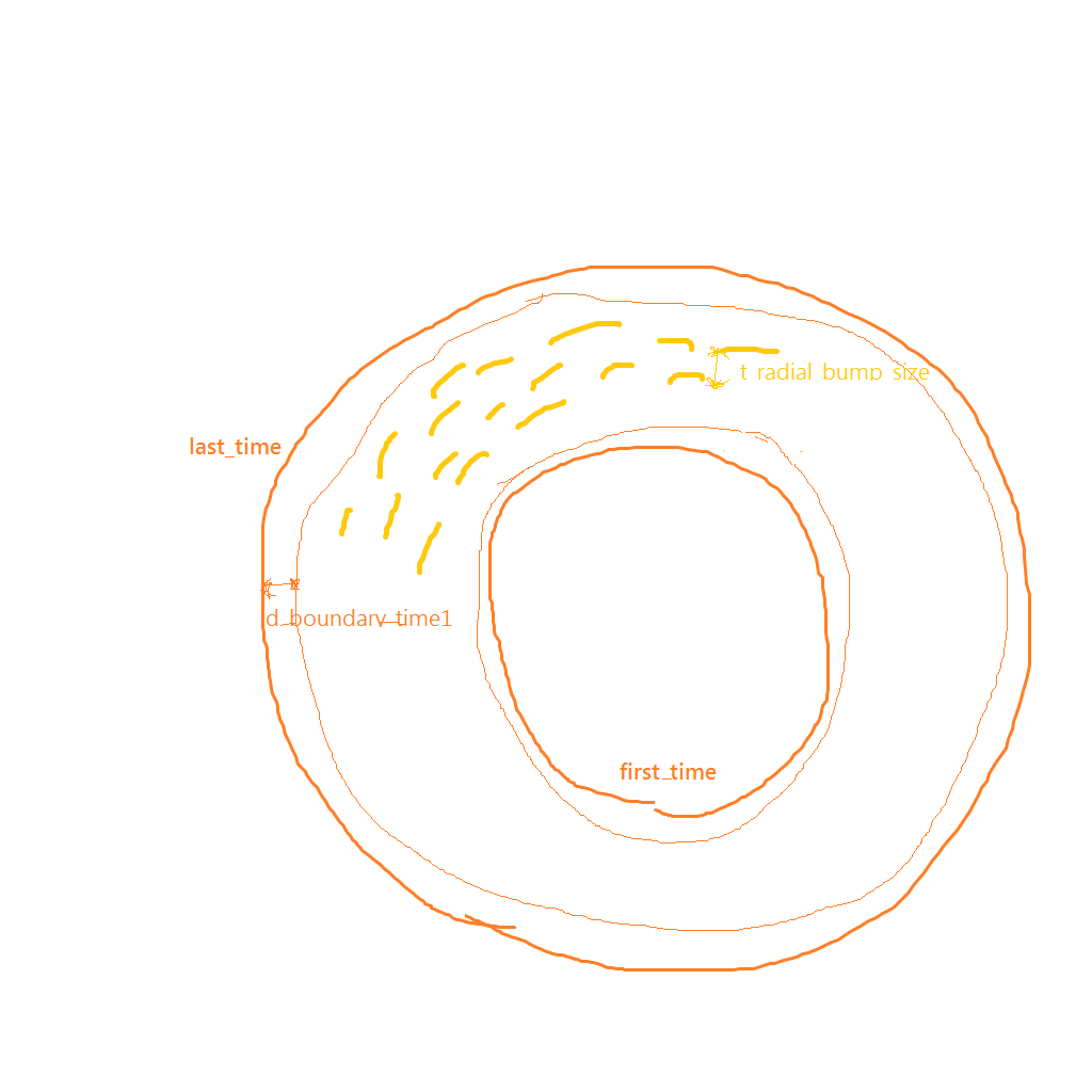

'first_time', 'last_time', 'd_boundary_time0', 'd_boundary_time1' define the
boundaries of the pattern on 'time value', you can regarded it as the radial
direct pattern.
't_radial_bump_size' as in attachment picture, unit is year.
'time_node_amount' is because, if it generate only one continuous pattern on
theta, the 'bump_size_along_theta' cannot maintain, the bump_size will get
smaller at the smaller radius. So I generate several patterns. On different
radius, I apply different seg_amount to theta position array[seg_amount]
It is the origin of it needing 'time_node_amount' to determine the amount of
such pattern on different radius. You can set it 3~5 it should sufficient.
Download 'generate pattern macro var_t.png' (38 KB)
Preview of image 'generate pattern macro var_t.png'

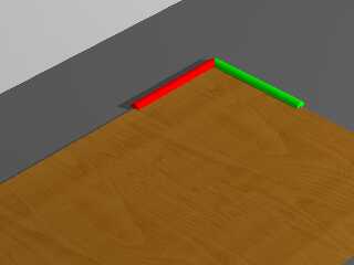

Such design is assumed the ideal situation. In fact, I'm planning to revise it.
It is obvious imperfect along the h-direct, When I ..'veneer' it, it shows no
change pattern (along theta).
Download 'show board2 radiosity.png' (1035 KB)
Preview of image 'show board2 radiosity.png'
