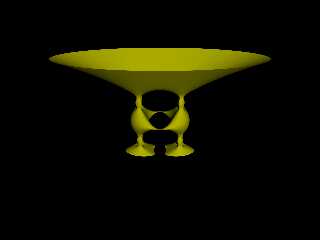

And it works - well, not the way it should.
I believe there is something wrong in my Povray code which is hard for me to
find out.
I added AT's equations as comment above the Povray code.
Meanwhile I read the threads initiated by klp in Povray's advanced users
<6752dcbc@news.povray.org>
in Dec 2024 about the topic but I could not find the solution there.
The interesting thing about my misinterpretation of AT's equations is:
 (1) setting threshold 1 and accuracy 0.01 (max_gradient 2352446)
 ==> Povray renders something solid (not the object I was expecting)
 ==> Trace Time: 1h 38 min using 16 threads
 (2) setting threshold 0 and accuracy 0.01 (max_gradient 2352446)
 ==> Povray renders something invisible
 ==> Trace Time: about the same as above
 (3) setting threshold 0.01 and accuracy 0.1 (max_gradient 2352446)
 ==> Povray renders an object that looks like being peeled
 ==> Trace Time: 0h 39 min using 16 threads
 And no, Povray doesn't complain about gaps in the object!
I will post an image of (1) and (3) in p.b.i
Thanks for your patience
Droj
Download 'iso_devil_plate_test.pov.txt' (4 KB)
From: Bald Eagle
Subject: Re: AT Devil Plate
Date: 27 Apr 2025 08:15:00
Message: <web.680e1f13d1f5ea8e1f9dae3025979125@news.povray.org>

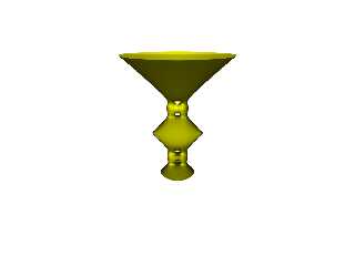

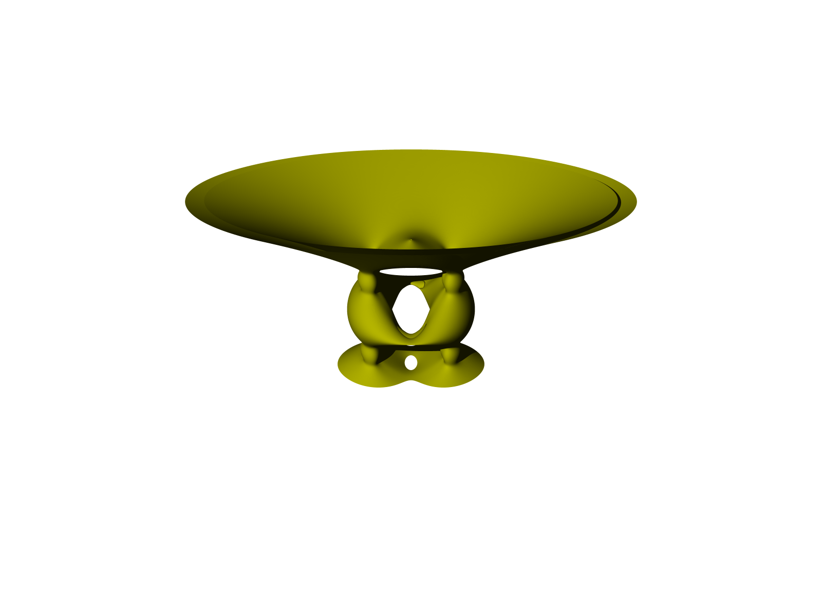

I don't know what your ultimate goal is, but when I just evaluated the
isosurface for
function {DevilFn2(x,y,z)
I get the following render (Cam and lights adjusted, white sky_sphere)
- BW
Download 'iso_devil_plate_test.png' (39 KB)
Preview of image 'iso_devil_plate_test.png'

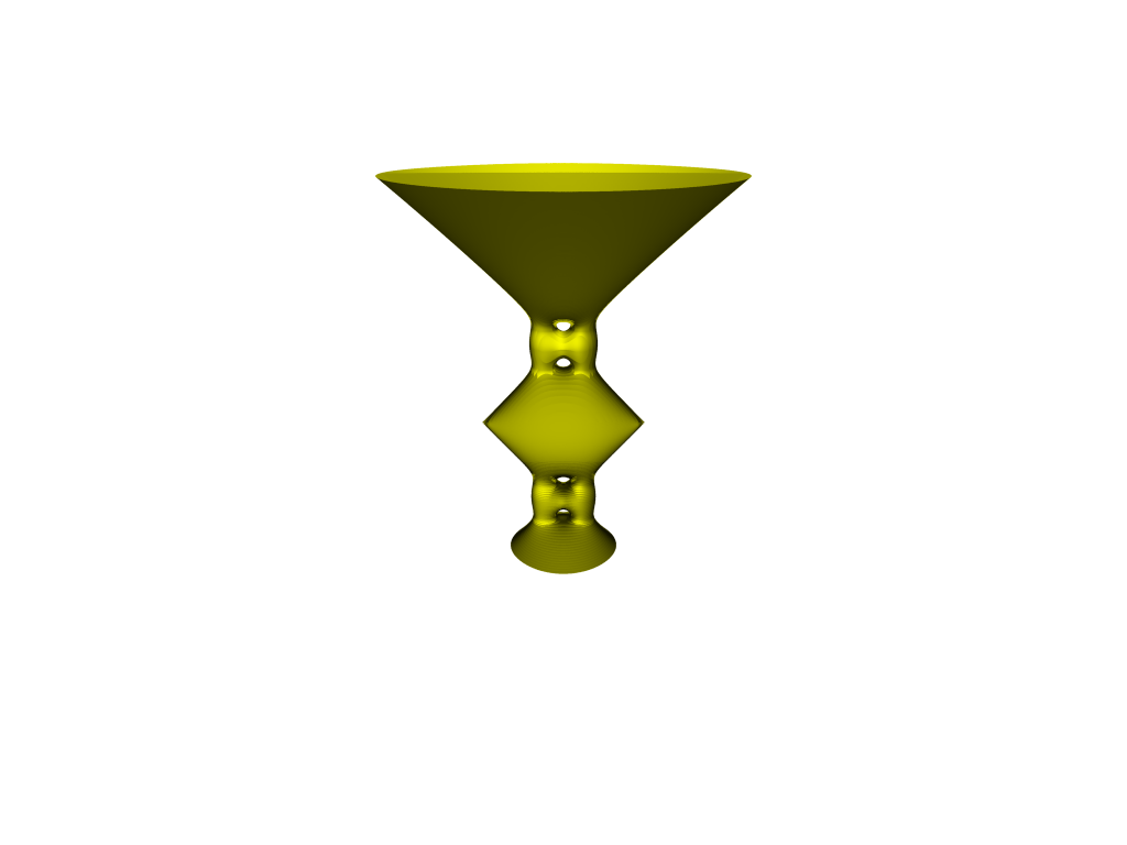

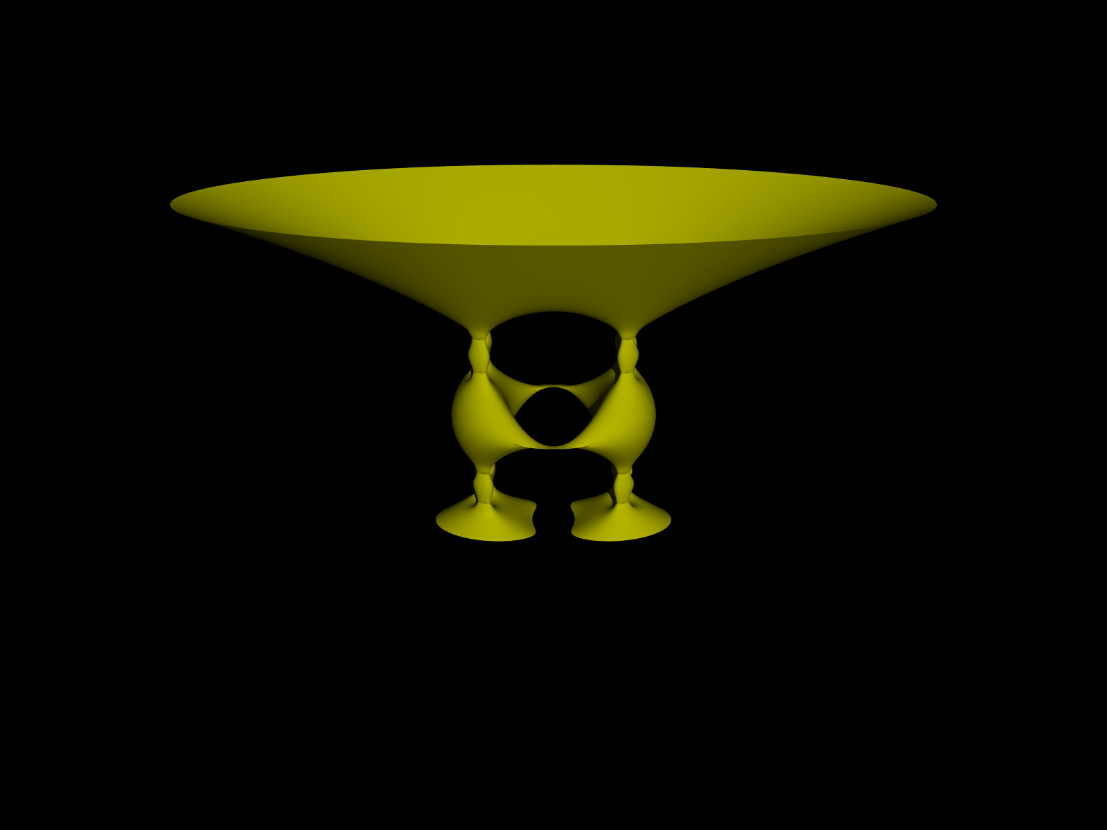

From: Droj
Date: 28 Apr 2025 14:00:00
Message: <web.680fc0ecd1f5ea8e397fdce03b2af915@news.povray.org>
> isosurface for
> - BW
When you render the function #declare Iso = function(x,y,z) {
you get the image attached.
The next 2 functions should add thickness to the shape (you see the rim of the
'plate' is thin like an eggshell).
And this is where the flaw is.
Droj
Download 'iso_devil_plate.png' (77 KB)
Preview of image 'iso_devil_plate.png'

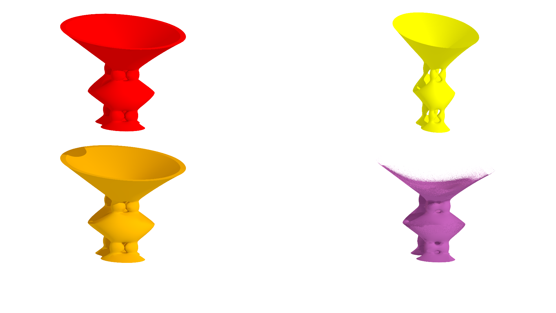

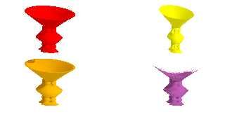

Obviously this should work. But I run into a problem with this approach.
The yellow object depictes the devils plate function without any thickening:
#declare c=1/10000;
#declare Th=1/10;
#declare Devil = function(x,y,z) {
x*x*x*x+2*x*x*z*z-36/100*x*x-y*y*y*y+25/100*y*y+z*z*z*z }
#declare Devil2 = function(x,y,z) { Devil(x,sqrt(y*y+z*z)-15/10,z) }
#declare IsoExterior = function (x,y,z) { Devil2(x,y,sqrt(x*x+z*z)-15/10) }
isosurface { function { IsoExterior(x,y,z) }
    contained_by { box { <-45/10,-25/10,-75/10>,<45/10,45/10,75/10> } }
    threshold 0.0
    open
    max_gradient 2500
    pigment { colour Yellow }
The red object shows the approach by Abderrahman Taha (MathMod). He
calculates the numerical derivatives to approximate the normals. Then
the shape is shifted a small amount along and against these normals.
Finally, both functions are multiplied to form the sets of points at
which at least one of the functions returns the value zero - the
threshold that is then used in the isosurface:
// numerical derivatives
#declare DFx = function(x,y,z) {
(IsoExterior(x+c,y,z)-IsoExterior(x,y,z))/c }
#declare DFy = function(x,y,z) {
(IsoExterior(x,y+c,z)-IsoExterior(x,y,z))/c }
#declare DFz = function(x,y,z) {
(IsoExterior(x,y,z+c)-IsoExterior(x,y,z))/c }
// normalisation
#declare R = function (x,y,z) { x/sqrt(x*x+y*y+z*z) }
#declare IsoPlus = function (x,y,z) {
    IsoExterior( x+Th*R(DFx(x,y,z),DFy(x,y,z),DFz(x,y,z)),
                 y+Th*R(DFy(x,y,z),DFz(x,y,z),DFx(x,y,z)),
                 z+Th*R(DFz(x,y,z),DFx(x,y,z),DFy(x,y,z)))
#declare IsoMinus = function (x,y,z) {
    IsoExterior( x-Th*R(DFx(x,y,z),DFy(x,y,z),DFz(x,y,z)),
                 y-Th*R(DFy(x,y,z),DFz(x,y,z),DFx(x,y,z)),
                 z-Th*R(DFz(x,y,z),DFx(x,y,z),DFy(x,y,z)))
#declare ThickIsoExterior = function (x,y,z) {
IsoPlus(x,y,z)*IsoMinus(x,y,z) }
#declare DevilsPlate = function (x,y,z) {
    select (  -(-24/10-y)*(y-44/10),ThickIsoExterior((10*x/15),y,z), 1)
isosurface {
    function {
       DevilsPlate(x,y,z)
    threshold 0.0
    open
    max_gradient 20000000
    pigment { colour Red }
The orange object ist nearly the same as the red one but without the
select statement, moving the range condition for y into the bounding box.
This all works very fine, but Mike Williams' approach (dark purple)
looks a little strange:
#declare DevilsPlateD = function (x,y,z) {
      select (
-(-24/10-y)*(y-44/10),(abs(IsoExterior((10*x/15),y,z))-0.01) ,1)
isosurface {
    function {
       DevilsPlateD(x,y,z)
    threshold 0.0
//   open
    max_gradient 1000000
    pigment { colour DarkPurple }
All values for max_gradient are adjusted according to the log.
max_trace_level was at maximum (256).
I have no idea what happens here.
Best regards
Michael
Download 'devilsplate02.png' (173 KB)
Preview of image 'devilsplate02.png'
From: Bald Eagle
Date: 29 Apr 2025 14:00:00
Message: <web.681112d1d1f5ea8e4573577725979125@news.povray.org>
MichaelJF <fri### [at] t-onlinede> wrote:
Well, the red and orange are looking good!
I'm not sure what's happening with MW's method, but I was just making a quick
suggestion.
The surface obviously extends infinitely in the +/-y directions, and so the
select is just there to trim the function.
I believe we can exclude that and just rely on the contained_by box.
IsoExterior (10*x/15),y,z) just scales the function in the x direction.
I'd take that out and use scale to take care of that part.
I'm just guessing here, but what if you then try something like:
IsoExterior (abs (x) - 0.01, abs (y) - 0.01, abs (z) - 0.01)
maybe also experiment with subtracting from f_r (x, y, z)
(include functions.inc)
try changing the threshold from 0 to 0.01
There's a lot of tricky things that have to be done to get certain functions to
work well with isosurfaces in POV-Ray vs other software packages
Maybe take a look further upstream at the preceding functions in the daisy chain
to see if a better gradient can be fashioned.
Define a set of y axes across the xz plane in the AABB, and graph the function
along those y-axes and see what pops out.
- BW
>       select (
> isosurface {
>     function {
>        DevilsPlateD(x,y,z)
>     threshold 0.0
> //   open
> Best regards
> Michael

Hi,
I tried some of the solutions proposed here and yes, the orange object is the
best approximation.
When you mentioned to use the function f_r (x, y, z) - although I do not have a
clue what it does (there is no comment in functions.inc) I remembered that TOK
used it in his source code for prettyball_1_at_klp_tok.pov.txt.
I tested it with Abderrahman Taha's Clebsch_2 and it worked amazingly well.
So, I adapted the code for Devil Plate, too which now looks as follows.
// Iso_Devil_Plate_test8.pov
#version 3.7;
global_settings { assumed_gamma 2.2 }
#include "colors.inc"
#include "textures.inc"
#include "metals.inc"
#include "functions.inc"
#declare H = 1e-4;
#declare Th = 1/10;
#declare Xmin = -45/10;
#declare Xmax = 45/10;
#declare Ymin = -24/10;
#declare Ymax = 44/10;
#declare Zmin = -75/10;
#declare Zmax = 75/10;
// Devil=x^4+2*x^2*z^2-(36/100)*x^2-y^4+(25/100)*y^2+z^4
#declare DevilFn = function {
 pow(x,4)+2*pow(x,2)*pow(z,2)-(36/100)*pow(x,2)-pow(y,4)+(25/100)*pow(y,2)+pow(z,4)
// Devil2=Devil(x,sqrt(y*y+z*z)-(15/10),z,t)
#declare DevilFn2 = function(x,y,z) {
 DevilFn (
  x,
  z
// IsoExterior=Devil2(x,y,sqrt(x*x+z*z)-(15/10),t)
#declare IsoExt = function(x,y,z) {
 DevilFn2 (
  x,
  y,
// DFx=((IsoExterior(x+c,y,z,t)-IsoExterior(x,y,z,t))/c)
#declare DFX = function { (IsoExt(x+H,y,z)-IsoExt(x,y,z))/H }
// DFy=((IsoExterior(x,y+c,z,t)-IsoExterior(x,y,z,t))/c)
#declare DFY = function { (IsoExt(x,y+H,z)-IsoExt(x,y,z))/H }
// DFz=((IsoExterior(x,y,z+c,t)-IsoExterior(x,y,z,t))/c)
#declare DFZ = function { (IsoExt(x,y,z+H)-IsoExt(x,y,z))/H }
// Adaptation according to TOK's code follows
#declare Fn =
    function(x, y, z, dx, dy, dz, s) {
        IsoExt(
            x + dx*s,
            y + dy*s,
            z + dz*s
// F(x,y,z,t) = if(y<(44/10)&y>-(24/10),ThickIsoExterior((10*x/15),y,z,t),1);
select() removed
#declare DP_Fn = function(x,y,z,dx,dy,dz) {
        Fn(x, y, z, dx, dy, dz, +Th/f_r(dx, dy, dz))
        Fn(x, y, z, dx, dy, dz, -Th/f_r(dx, dy, dz))
        // instead of: IsoPlus(x,y,z)*IsoMinus(x,y,z),
//ISO Devil_Plate =
isosurface {
  function {DP_Fn(
             10*x/15,y,z, // scaling x
             DFX(x, y, z),
             DFY(x, y, z),
             DFZ(x, y, z)
        contained_by{box{<Xmin,Ymin,Zmin>, <Xmax, Ymax, Zmax>}}
        threshold 0.0 // Trace Time 0 h 26 min
        accuracy 0.01
        max_gradient 2216254
        open
        pigment {Yellow}
 rotate 90*y
#declare Win = image_width/image_height;
background { color <1.0,1.0,1.0> }
camera {
    location <0, 15, -25>
    up y
    right Win*x
    look_at <0.0, 0.0, 0.0>
    angle 54
light_source {
    <-17, 25, -35>
    color rgb <1, 1, 1>
It's probably as close to the original as it can get.
Thanks to all of you for the input.
Droj
Download 'iso_devil_plate_test8.png' (77 KB)
Preview of image 'iso_devil_plate_test8.png'
