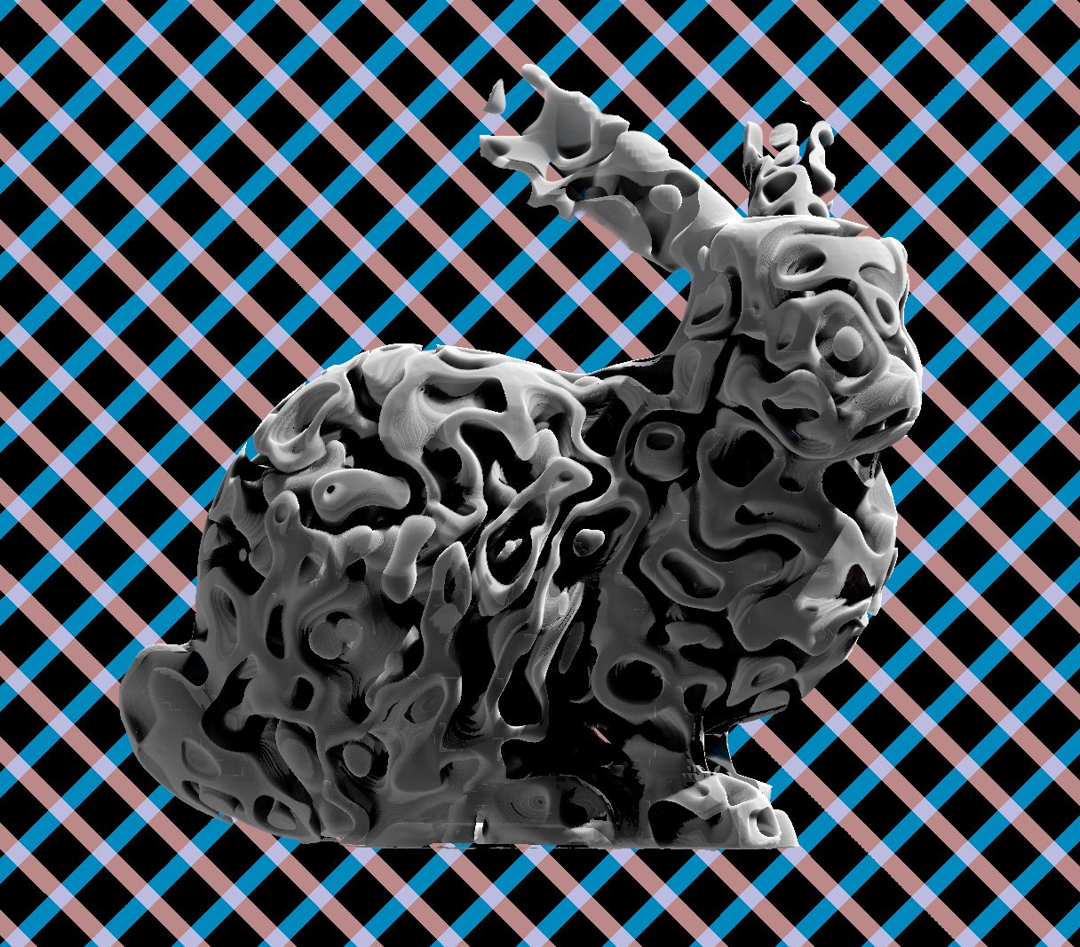

And here's the good ol' Stanford Bunny. This is a mesh2 model made (or
converted) by James Holsenback in October of 2014. It's available here...
https://news.povray.org/povray.binaries.misc/thread/%3C5432afe4%40news.povray.org%3E/
There are some subtle media-related issues with this render; the media probably
just needs more samples.
Download 'solid_media_mesh2_stanford_bunny.jpg' (294 KB)
Preview of image 'solid_media_mesh2_stanford_bunny.jpg'
From: Alain Martel
Subject: Re: 'solid media' human model
Date: 14 Apr 2022 11:07:52
Message: <625838c8$1@news.povray.org>
Le 2022-04-14 à 09:15, Kenneth a écrit :
> These were my media settings:
> object{ MY_OBJECT
> hollow
> texture{pigment{rgbt 1}}
> interior{
>   media{
>   scattering{1, 300 extinction 0.7}
>   method 3
>   intervals 1
>   samples 47, 139
>   aa_level 4
>                 density{
>                 bozo scale .055 sine_wave frequency 4// Interestingly, the
> // ordering of sine_wave and frequency makes a difference-- the visual result
> // is different when reversed.
>                 color_map{[.6 rgb 0][.6 rgb 1]}
When using sampling method 3, ONLY the first value of samples is used,
the second value is always silently ignored.
So, samples 47, 139 is effectively exactly the same as samples 47.
intervals default to 1 and should remain at that value, so, you should
not set intervals at all with method 3.
From: Kenneth
Date: 14 Apr 2022 15:15:00
Message: <web.6258715fd1523eea4cef624e6e066e29@news.povray.org>
Oh! You are correct. (I had to test it myself, just to see.) You have probably
mentioned this in previous posts, but I did not pay good-enough attention. :-(
The way the documentation is presented in "3.7.2.3 Sampling Parameters &
Methods" has always confused me-- as to which media parameters belong to which
media method. It skips around between method 3, then methods 1 and 2, without a
clear (to me) delineation between the three. I guess I'm just reading it wrong.
Then there is this explanation -- which refers only to Method 1, I guess?
"The samples Min, Max keyword specifies the minimum and maximum number of
samples taken per interval. The default values are samples 1,1. The value for
Max may be omitted, in which case the range Min = Max will be used."
So by omitting the 'Max' value, I admit that even at this late date I really
have no idea what is meant by "...the range Min = Max will be used." What range,
if only a single sample value is specified? What does 'range' refer to?

> The object pigment is a discontinuous function with an infinite
> gradient, which might factor into some of what you're seeing.
> Usually you have to insert a user-made smooth gradient to join up the 2 regions
> of the function (inside:outside).  And then the isosurface method that you are
> using works just fine.
> I've played with this a few times, and Bill Pokorny has ... objectasiso
From 2009! Yeah, I had a sneaking feeling that I was 'rediscovering the use of
fire', ha, and that someone had already done this kind of thing. I guess I
should have done a newsgroup search-- but I was too excited about my 'brand-new
use for POV-ray'  :-P
Infinite gradients, "inserting a user-made gradient", egads!
Actually, I was beginning to think about this in a hazy sort of way, that the
object pattern itself (as turned into a function) was the root of the problem,
because of it's strict 'inside/outside' nature. As-is, it doesn't behave like a
normal function, from what I can tell.
I just downloaded Bill P's files; will definitely give them a read. BTW, I think
this is the first time that I have ever downloaded and un-packed a Unix tar.gz
'thing'. I learn something new every day.
