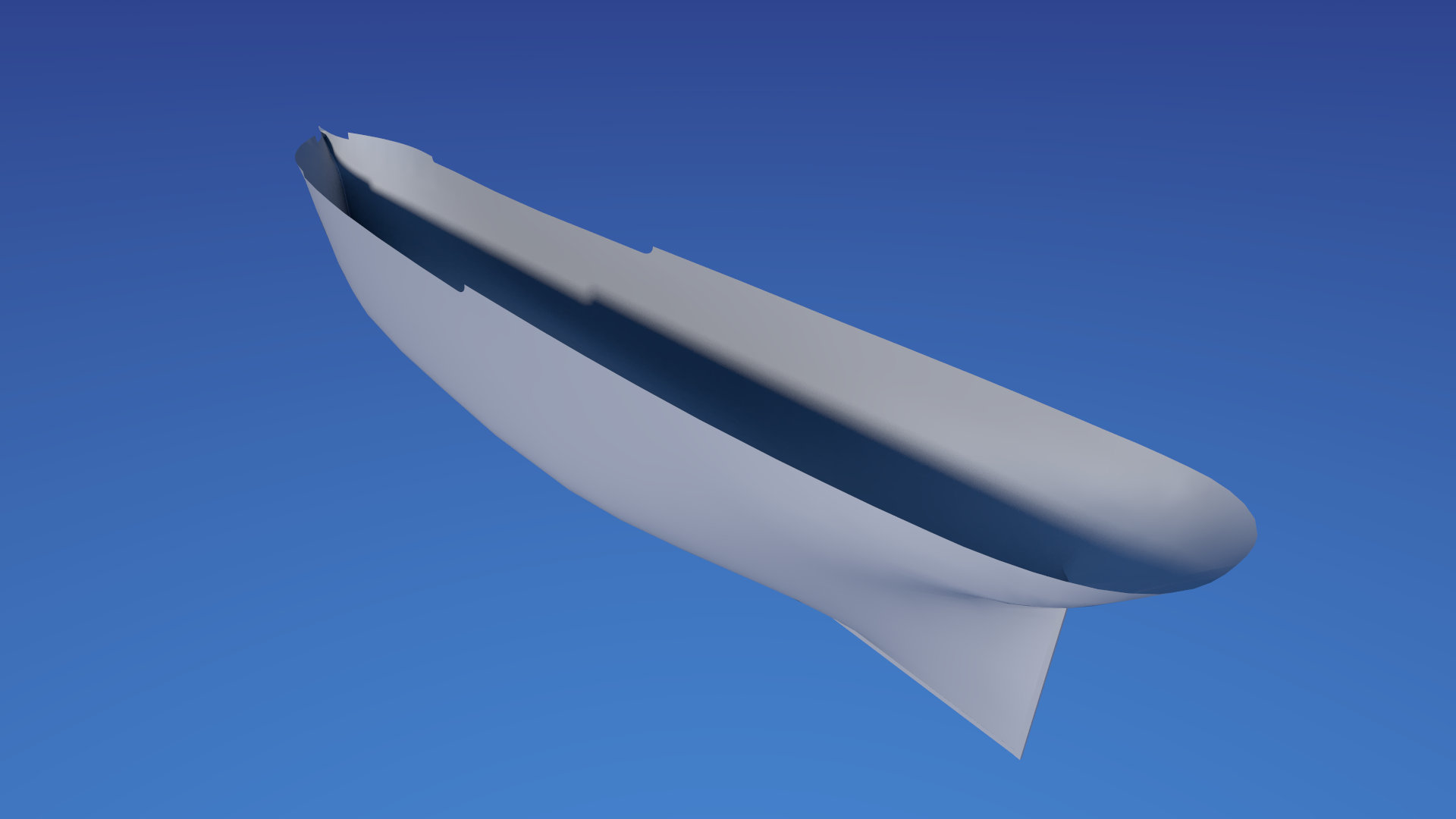

After a long hot summer, with the nights getting longer, and the days getting
colder, it is time to start a new project. Maybe I'm overreaching myself, but
the bar has to be higher every time.
I decided to do the Balclutha, a steel-hulled, full-rigged ship, built in
Glasgow in 1886.
She is now a museum ship in San Fransisco.
(https://en.wikipedia.org/wiki/Balclutha_(1886))
The Library Of Congress website has detailed plans and photos of this ship, so I
have all the information to model this ship. Here is the start:
I've modeled one side of the hull, in Blender, exported the .obj-file, and
created a mesh2-file.
Ton.
Download 'forum1.jpg' (80 KB)
Preview of image 'forum1.jpg'

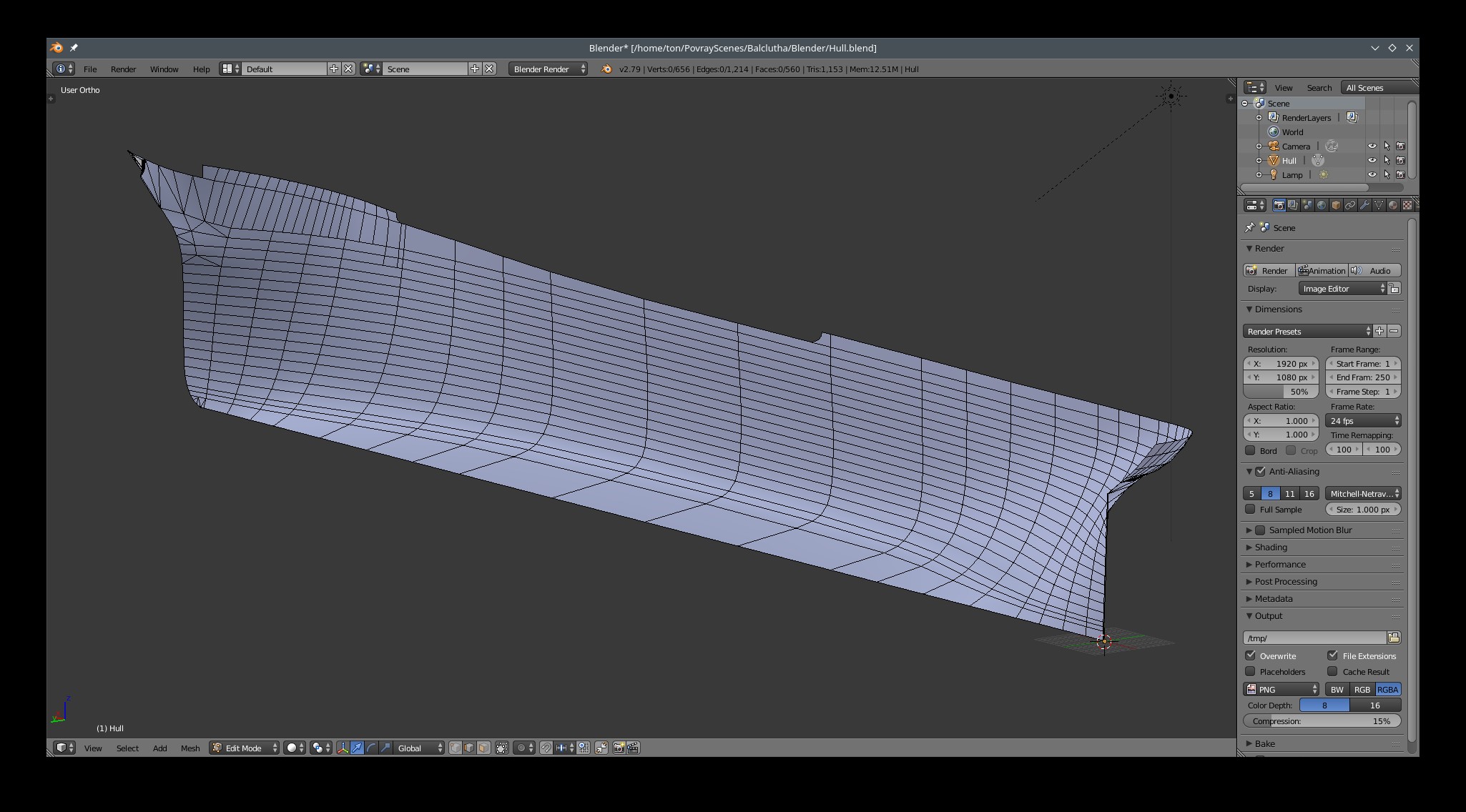

Good start. How did you model the hull: nurbs?
From: Ton
Subject: Re: Sailing ship Balclutha
Date: 29 Mar 2022 19:05:00
Message: <web.62438fccbeadc5ebad1330e67597fb06@news.povray.org>
> Thomas
Bedankt Thomas.
I used Blender, and transformed the obj output in mesh2, with normals.
Ton.
Date: 30 Mar 2022 02:33:04
Message: <6243f9a0$1@news.povray.org>
Op 30/03/2022 om 01:01 schreef Ton:
>> Thomas
> Bedankt Thomas.
Indeed, but what I mean: /within/ Blender, how was the hull surface
modelled? I do not use Blender so I thought maybe it was generated with
the help of a nurbs tool, which is not available in my Silo package.
 From my experience, hulls are not very easy to model without it I
think, or some similar tool.
From: Ton
Date: 30 Mar 2022 06:10:00
Message: <web.62442c60beadc5ebad1330e67597fb06@news.povray.org>
> >> Thomas
> > Bedankt Thomas.
> Thomas

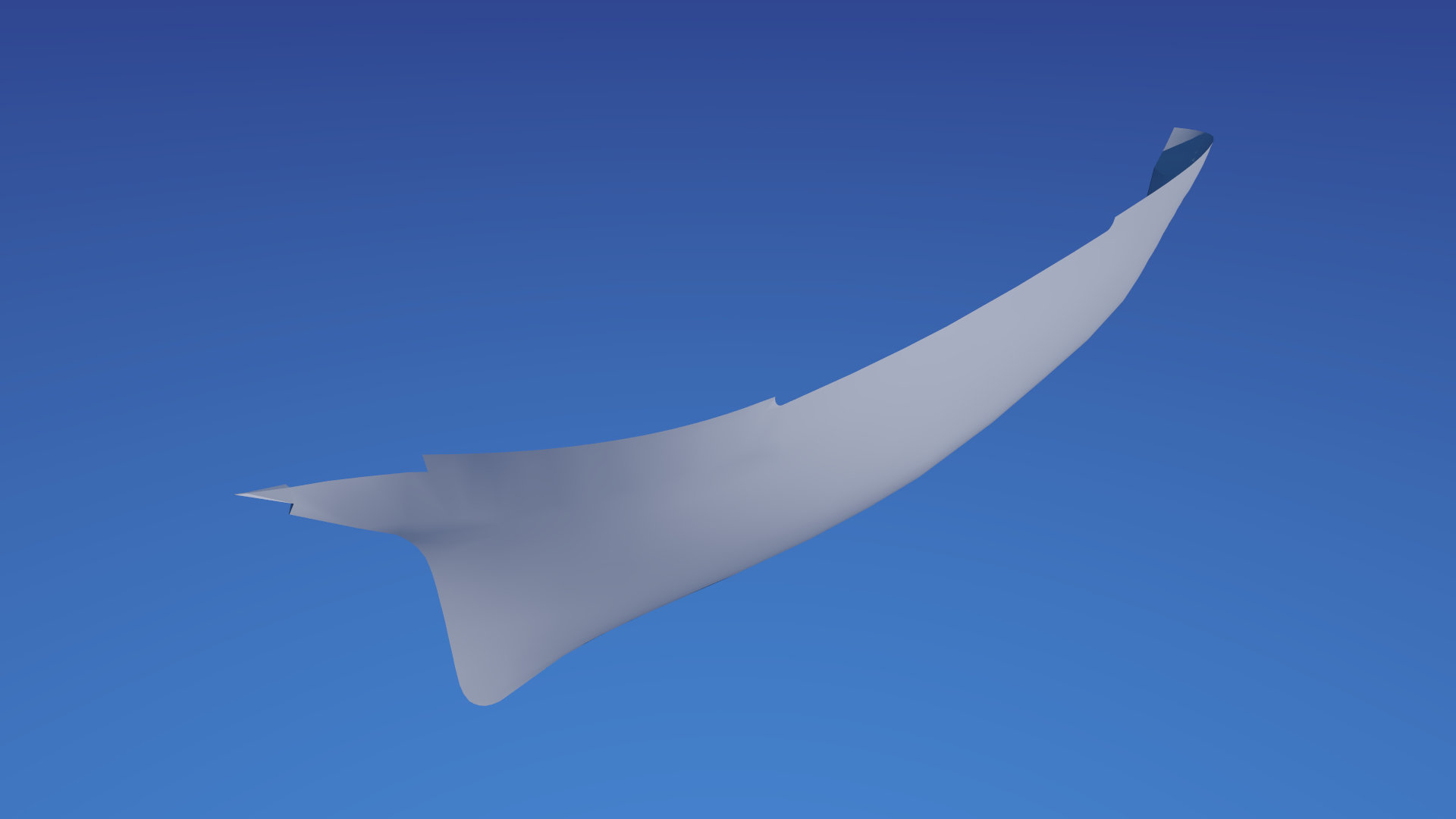

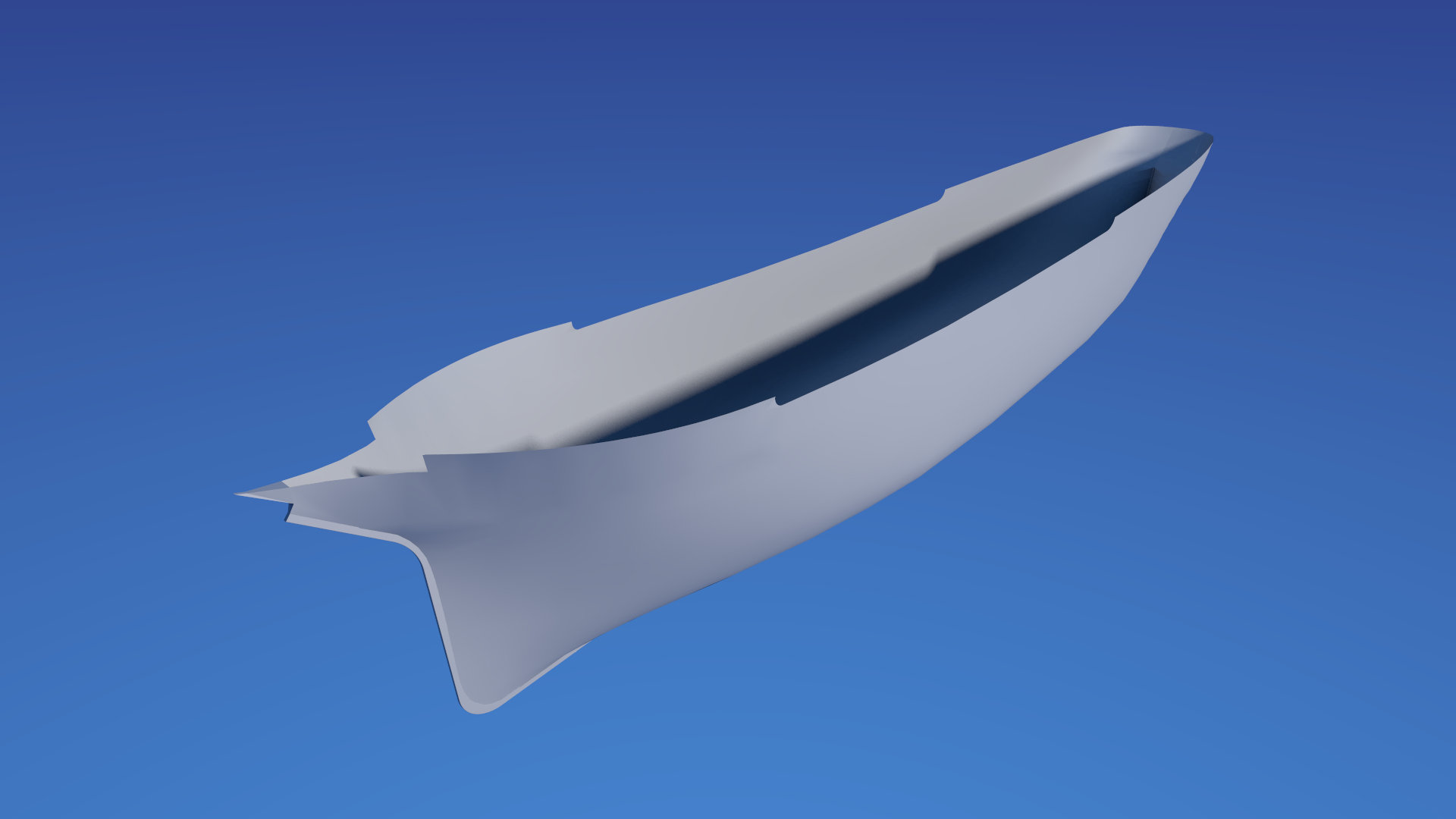

With the help of the hull profile plans I can determine the X, Y, and Z
coordinates of the hull. X is forward-backwards, Y is up-down, and Z is
left-right (or port-starboard). I start with a plane I subdivide when necessary.
In that way I work down the hull. When exporting to obj-file I (well, blender)
triangulates those rectangles. You see the result, quite convincing.
I have mirrored the hull, added the keel, which are povray objects from
roundedge.inc.
Ton.
Download 'forum4.jpg' (349 KB)
Preview of image 'forum4.jpg'
From: Ton
Date: 30 Mar 2022 06:15:00
Message: <web.62442c92beadc5ebad1330e67597fb06@news.povray.org>
Download 'forum2.jpg' (92 KB)
Preview of image 'forum2.jpg'

From: Ton
Message: <web.62442d1dbeadc5ebad1330e67597fb06@news.povray.org>
Download 'forum3.jpg' (91 KB)
Preview of image 'forum3.jpg'
Date: 30 Mar 2022 07:44:54
Message: <624442b6$1@news.povray.org>
Op 30-3-2022 om 12:09 schreef Ton:
>>>> Thomas
>>> Bedankt Thomas.
>> Thomas
> roundedge.inc.
> Cheers
> Ton.
