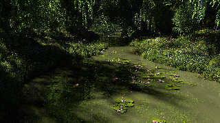

This idyllic (non-realistic) scene is the result of several months of work. It
took that long because of an experiment.
I was curious about what would happen when only looking long enough at each
parts of the scene and so detecting not so good parts.
In fact I detected one flaw after another for three long months.
So I substituted, changed or retextured nearly all objects, some of them several
times.
In the end the scene used 155 individual objects - by comparison my recent redo
of "warm_up" only used 21 meshes.
So the scene contains 31 animals (9 birds, 7 mammals, 11 insects, 3 frogs and 2
fishes).
Since some of them are nearly invisible, I downloaded a 8000*4500 pixel version
http://news.povray.org/povray.binaries.scene-files/thread/%3Cweb.5ea0897b523527c5afdd13e10%40news.povray.org%3E/
Rendering this version took more than 9 days and 43 GB of RAM were used.
I worked several weeks on an atmosphere alone, but in the end all I did was
adding a subtle fog effect.
The chief motiv of the image is the contrast of light and shadows as it is
important in impressionistic painting or gothic architecture.
I'll explore this topic in my next images more.
Beside this philosophical reasons it was important for me in a more technical
sense as it is the first image since 15 years developed with assumed_gamma 1.
I think, I'll stay at this since it is obviously possible to realize strong
contrasts with assumed_gamma 1...
Happy rendering in difficult times,
Norbert
Download 'light & shadows.jpg' (878 KB)
Preview of image 'light & shadows.jpg'

WOW. That's one beautiful image Norbert! Bravo.
Going to sit back, drink a cup of coffee, and stare at it for a while.
Bill P.

Fantastic, would like to visit this place. Povray is surely amazing, well done.
Ton.

That is one truly impressive photograph.  I can hardly wait to see your
render.
But seriously, you've outdone yourself here.  Great job!
I would expect so.  Real life does it linearly; it is our perceptions
that are non-linear.  My response to a low contrast scene has not been
to fiddle with the assumed gamma, but to change the lighting environment.

Absolutely gorgeous scene indeed. While your "experiment" contains the
danger of never finishing scene building, it is absolutely essential for
reaching any level of perfection. I do something less extreme than you
myself, with the result that over the last couple of years my production
has dramatically fallen ;-) There are other reasons too for this drop
but those are coming from RL... Anyway, this is a landmark image.
> fishes).
I suppose continuous render or did you interrupt and continue (+c) a
couple of times?
I recognise that. ;-)
Cant wait...
I can only approve.
> Norbert
Thanks! My thoughts go to the numerous who are threatened of losing
their livelihood because of covid19.

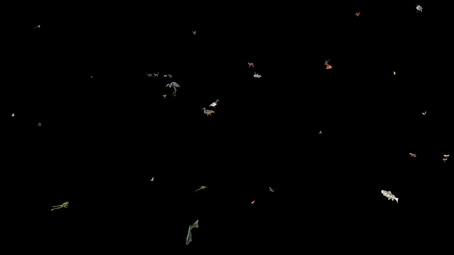

Lol - in the case you wonder about where all the animals are, here is an image
with all the creatures...
Norbert
Download 'light & shadows_animals.jpg' (92 KB)
Preview of image 'light & shadows_animals.jpg'
In fact texturing was really simple. A finish like "specular 0.3 roughness 0.003
diffuse 0.6 ambient 0" worked with nearly all objects. When I used assumed_gamma
2.2 there was much more work to do :-)
The biggest change was to reduce the radiosity contribution of the sky.
Here I used rather extreme settings (at least for me) -
#version 3.7;
#declare RAD = 8;
global_settings {
        assumed_gamma 1
        max_trace_level 255
        noise_generator 2
                radiosity {
                        pretrace_start 0.08
                        pretrace_end   0.04/RAD
                        count 30*RAD
                        nearest_count min (20, RAD)
                        error_bound 3/RAD
                        low_error_factor 0.5
                        recursion_limit 1
                        gray_threshold 0
                        minimum_reuse 0.015
                        brightness 1
                        adc_bailout 0.005
                        normal on
                        media off
#declare skyf = 0.5;
light_source {
        <0,0,40000> color srgb (<2.42,2.23,1.87>+2.173*0.3)*0.85
        area_light <1000,0,0>, <0,1000,0> 5,5 adaptive 0 jitter circular orient
        rotate <-47,-50,0>
sky_sphere {
        pigment {
                function {max (min (y, 1), 0)}
                color_map {
                        [0.0000  srgb <212*skyf,221*skyf,239*(1+skyf)*0.5>/255]
                        [0.1029  srgb <219*skyf,229*skyf,244*(1+skyf)*0.5>/255]
                        [0.1512  srgb <233*skyf,241*skyf,250*(1+skyf)*0.5>/255]
                        [0.1949  srgb <223*skyf,239*skyf,252*(1+skyf)*0.5>/255]
                        [0.2444  srgb <201*skyf,227*skyf,252*(1+skyf)*0.5>/255]
