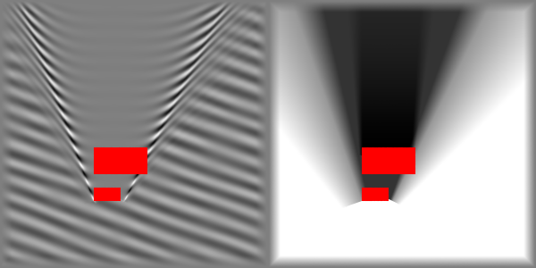

I just posted the wake-wave making code to p.b.s-f. It can generate the image
maps attached to this message, which are used respectively as image_map in a
height_field and as pattern for a texture_map. In red the ship is shown, which
illustrates why the wake needs to be assymetrical. And if you look closely, you
can see that the waves nicely meet up in the middle :-).

Ok. Thanks for your additional explanations. I don't need exact replication,
make-believe is enough and I think that your code is doing that very well.
Swimming ducks indeed. I have been watching them too in that context :-)
