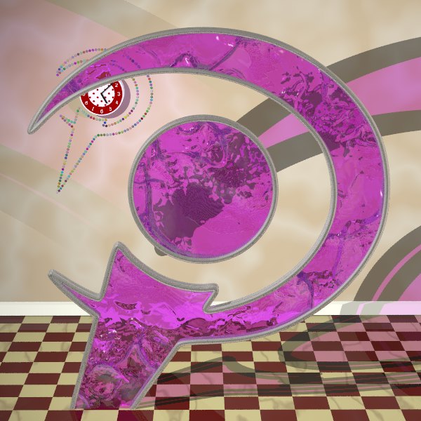

Scanned the logo for some Bezier splines:
2 problems:
Center circle was a poor excuse for a circle and using a Bezier editor seemed
impossible for making it round. R was 3.77 and I kept landing 2.08 for a handle
length. I was very close, as it turns out. 2.08 / 3.77 = 0.551724
Ratio of radius to handle length for a circle = kappa
4*(sqrt(2)-1)/3 = 0.552284749830792
Raw Bezier output produces unevenly spaced points along a curve with linear
iteration increment.
I was able to get an even point spread, but before explaining I was wondering if
someone else might have a different method. If you can genius this one, show
your work maybe?
I'll get you started:
OK, sorry 'bout that. Forget all that. Here's the macro:
#macro bezier_curve(p1,h1,h2,p2,detail) // <x,y> or <x,y,0,> or <x,0,y>
           //(node, ctrlh, ctrlh, node, .01)
     #local C = 3*(h1-p1);
     #local B = 3*(h2-h1)-C;
     #local A = p2-p1-C-B;
     #local i = 0;
     #while (i<1)
         #local xy= A*pow(i,3)+B*pow(i,2)+C*i+p1;
////////////////////// do something with xyz here \\\\\\\\\\\\\\\\\\\\\\\\
         #local i=i+detail;
     #end
     #local i=1;
     #local xy = A*pow(i,3)+B*pow(i,2)+C*i+p1;
     echov2(xy) echo("\n")
     #local xy=p2;
     echov2(xy) echo("\n") // same numbers
#end
want some points?

Download 'povlogo_007.jpg' (77 KB)
Preview of image 'povlogo_007.jpg'

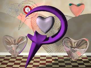

Deja Vu
Download 'copycat3.jpg' (186 KB)

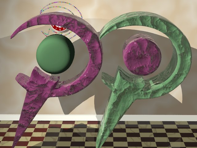

Update one the bezier stuff ...
With a little bezier help:
    bezier_subdivision() will still divide points closer at sharper part of the
curve
    bezier_length()
    bezier_point_spread() evenly-spaced points along multiple paths
and
    bezPrism(exH,rm1,rm2,slices,Switch)
with width and height radius modifiers: 0-1 range = R*kappa thru R
> 1 is bowl-shaped
Design considerations:
Multiple entries for backbone points, triangulating up one side and down the
other, presents a dilemma of using a fast face-index search for normal addition
or VEq() and going 9 times slower.
Perimeters that have little shape-wise relation to the backbone are buggy, such
as this one required increment-rate-control at a critical point along the path.
Download 'bezier_prism.jpg' (246 KB)
Preview of image 'bezier_prism.jpg'

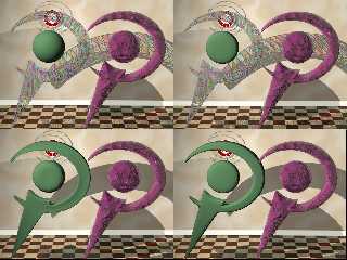

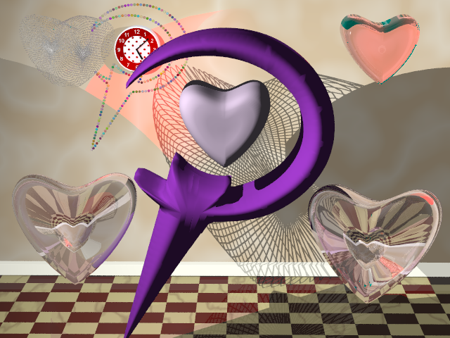

Happy with everything, except UV vectors for "up one side and down the other" of
a "cresent with a handle" ?!?
Anyway, radius modifers work well, eh?
Download 'povlogo_smooth8.jpg' (59 KB)
Preview of image 'povlogo_smooth8.jpg'

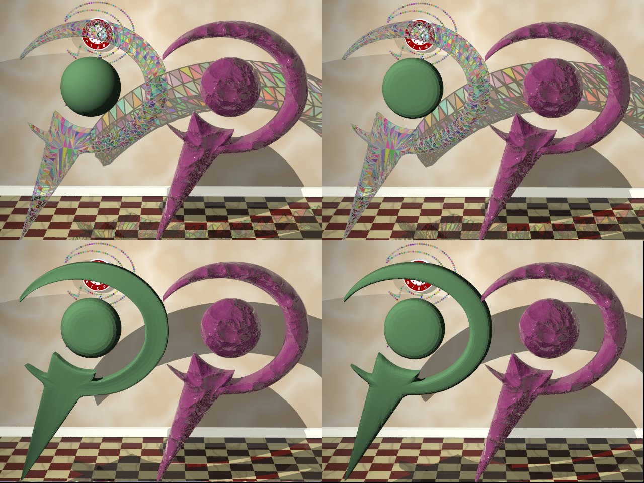

rewrite!
norms are made and then written to mesh face-indexed without missing any faces
due to multiple-entry backbone points, VEq is out the window.
At first tried to write it by using previously written face and edge
definitions. These had to be redone.
Ended up with 2 sets of norms seen here; points that all have the average of
adjacent faces, and backbone to perimeter vector norms. The latter being the
case for 2 lower transparencies, with averaged smoothing on the smaller 2
hearts and the purpleP .

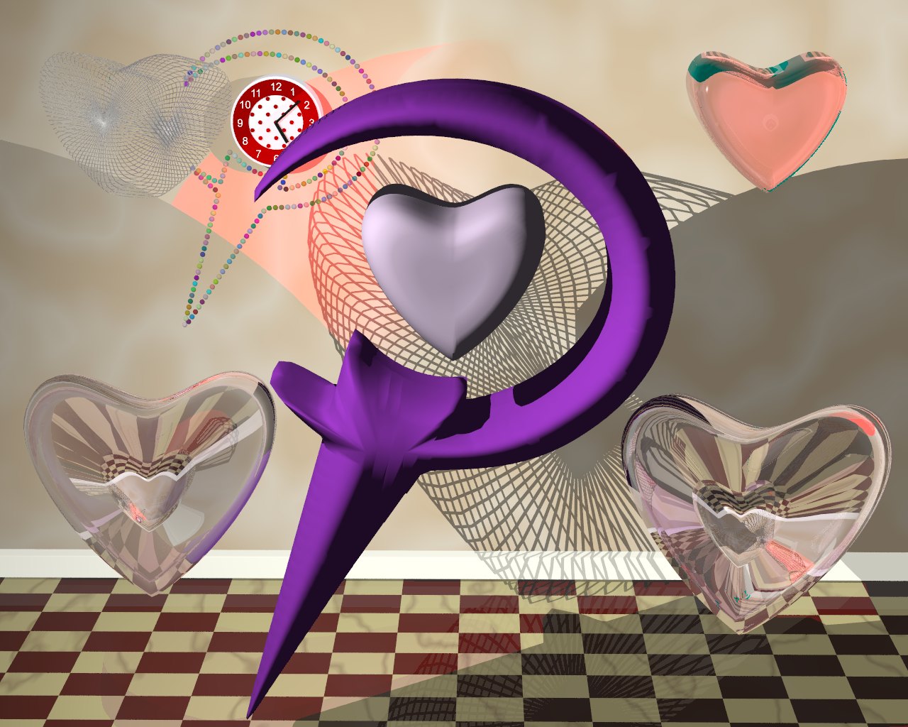

Download 'heart02.png' (338 KB)
Preview of image 'heart02.png'
From: alphaQuad
Subject: Re: Deja-Vu
Date: 26 May 2009 22:20:01
Message: <web.4a1ca2407a8ca8fcb70d65c50@news.povray.org>
640 doesnt do it justice.
perimeter to center 3D bezier path handles now have 2 modifers length and
rotation
Download 'heart02_lossy.jpg' (215 KB)
Preview of image 'heart02_lossy.jpg'

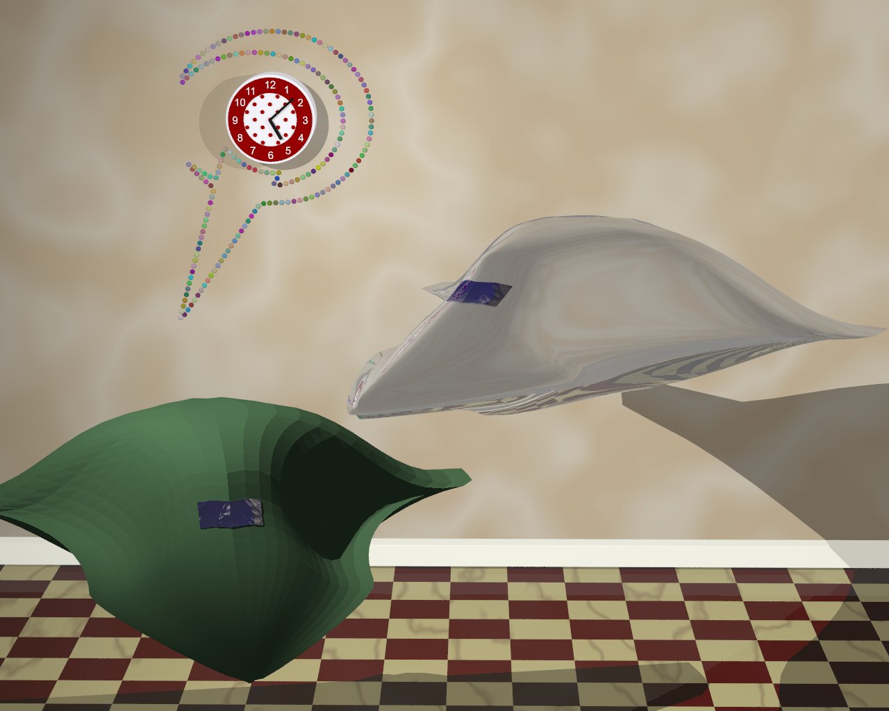

Get this script. Why it hasn't been done before, I dont know.
Hardest part was gettin triangle def right.
I have dubbed the new evolution bezierPrismQ() for Quads.
Before was auto triangulation, increment if closer. This time it is linear
increment, requiring sweeps parameter to request a point ratio of a*2-1=b,
ending with a single triangle at the nose and all other faces being quads.
Even 'with' taking ten minutes to add up the norms, if you dont quad around the
object you get streaks of misaligned normals with triangles defined anywhere in
the domain of perimeter to backbone.
2 bezier paths to this:
Download 'ship1_lossy.jpg' (104 KB)
Preview of image 'ship1_lossy.jpg'
