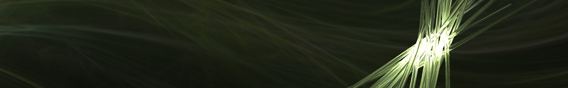

Mid-week abstract anyone?
Just a small test, which uses a few techniques which perhaps might be of
interest for some?
First, it's a simple way of randomly placing a lot of objects without them
intersecting. The code should speak for itself, but I don't know if this method
is entirely bulletproof?
Second, I wanted to use an image I did with apophysis (
http://www.apophysis.org/ ). The resolution was a bit too low though, and I
lost the settings to remake it. So I blurred it by averaging the image several
times in a while loop. I've blurred procedural textures this way before, but it
works quite well with image_maps also.
I'd love to see some "remixes" of this scene! The source is below, and I can
post the background image if anyone's interested.
(Pinnedyr means phasmatodea/walking sticks in Norwegian).
-Peter

Download 'pinnedyr_01.jpg' (129 KB)
Preview of image 'pinnedyr_01.jpg'

Man thats pretty cool!
Fractal Explorer (which you can program fractals in, using formula parser)
and chaoscope are both very good as well. http://www.chaoscope.org/
http://www.eclectasy.com/Fractal-Explorer/
Hmm...that makes me want to try your method on some fractals of my own.

Looks very good. Should work with any apophysis image of course (I love that
program), but there should be a kind of coincidence.

Beautiful

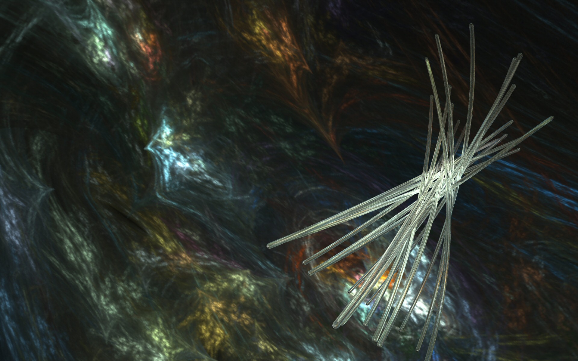

Here is one.

> Here is one.
> Thomas
Wow, that looks really nice!
I've been trying to add such a colorful background myself, but have failed
miserably. It would be interesting to see your scene with a more glasslike
texture.

> Just an quick example with glass.inc, which works for my background:
After 8h 36m (with some of the time in low priority), this was not a that quick
test after all ;) Maybe max_trace_level was a tad too high.
Well, I liked the result, so here it comes. Ultra-wide this time.

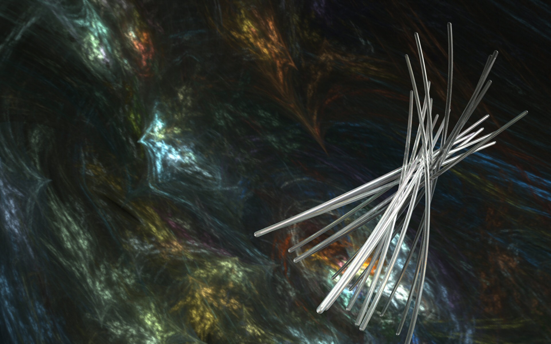

Here is with glass.inc.
Does not look so bright as you example, but the glass-like texture is more
pronounced than in my earlier image. I used max_trace_level 10. I do not see
any black spots, so that looks ok. Render time was about 30 minutes on my
machine (Pentium D 2x3GHz).
