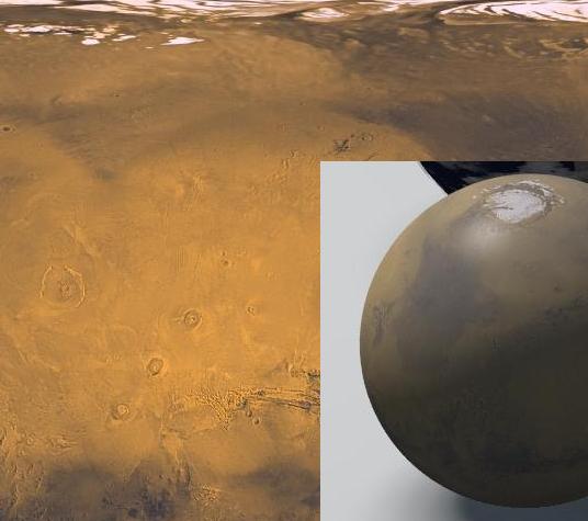

I've noticed that when I use an image map, the surface is usually very low
contrast and/or low saturation.  Is there some setting (i.e. specular -
I've tried turning specular off and it doesn't help) that has an effect
here?  How (aside from tweaking the image map) can I fix this?
The attached image shows the image map in the background and a rendering in
the foreground.  I've fixed this in the past for backgrounds by using
lightgroups and ambient = 1 for the background image map, but in this case
I need the object with the image map to interact with the light.
Any ideas?
Thanks!
Mike

From: PM 2Ring
Subject: Re: Low contrast/saturation using image maps
Date: 28 Apr 2006 10:40:01
Message: <web.44522880b8182a8476ba2c900@news.povray.org>
I generally just boost the diffuse value (and also ambient if I'm not using
radiosity). You can also adjust the brightness, contrast & gamma of any
pigment by converting it to a pigment function, and then using an
appropriate transfer function. Jaime's LightSys package can do this sort of
thing.
As you can imagine, this slows rendering, so you're probably better
off tweaking the image file. From the look of your Mars globe, I think you
need to boost the gamma of your source image. Or maybe it's just a funny
JPEG file...
I rendered some globes of Venus & Mars years ago, but the files are still on
my Amiga (I think).
From: Marc Jacquier
Date: 28 Apr 2006 15:21:03
Message: <44526b1f$1@news.povray.org>
news:web.44522300198979c81009749b0@news.povray.org...
I set diffuse 1 (default is 0.6)
Marc
From: Gail Shaw
Date: 28 Apr 2006 15:51:52
Message: <44527258@news.povray.org>
"Mike Sobers" <sob### [at] mindspringcom> wrote in message
Try this finish
finish {ambient 0 diffuse 0.9 brilliance 0.75}
From: gonzo
Date: 29 Apr 2006 16:15:00
Message: <web.4453c820b8182a8479b4a70c0@news.povray.org>
> Any ideas?
> Thanks!
> Mike
In addition to the above comments, try using a normal with the same image as
a bump_map.  That will provide some accent around small details.
RG
