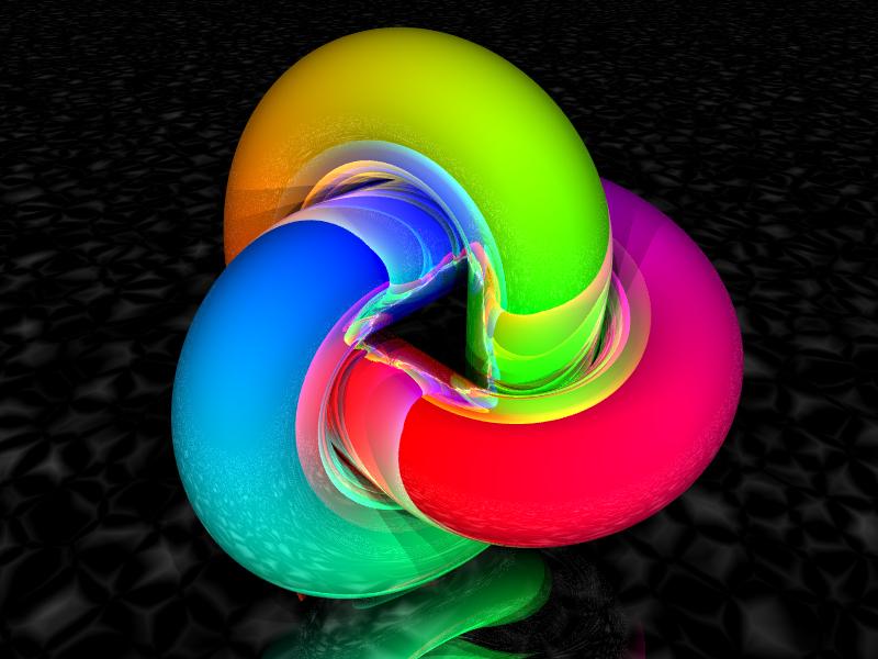

Go easy on me... 8^)  I was looking at the knot thinking it could be done
with torus sections.  It can't quite, so I cheated...
Download 'knot.jpg' (54 KB)
Preview of image 'knot.jpg'

I realized it couldn't be torus sections when I was trying to figure out
placement,  Then I realized I couldn't even just shear the sections.  The
next thought was sphere_sweep, but that was a bit of a pain, so I just
ended up using a lot of spheres. (3000 in fact, but I think it could be
less at this resolution.)  That suddenly made the color a lot easier than
if I had used the other methods.

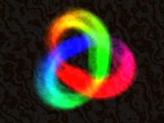

a bit...  Got the attached image which I think sucks compared to the mirror
one.  Esp. the parts where it overlaps.  Maybe I just need to play with it a
lot more, but that was bad enough (and made me think about the translucent
"problem" to think that what I was imagining might not be consistent enough
to implement.

Yes, I made a version like that too, because of that HOF image.  I didn't
think the knot would look quite as close to the linked rings as it does,
until I did it.  I was just thinking of doing the knot like the links,
torus sections tight enough to just be tangent to the other parts of the
object.
The links were a lot harder to make the colors fade into each other
though... 8^)  Maybe I should have used a figure-8 knot instead of the
trefoil, so the plagerism wouldn't be so obvious.
Download 'knot-fire.png' (135 KB)
Preview of image 'knot-fire.png'
