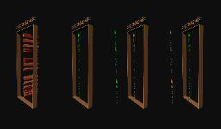

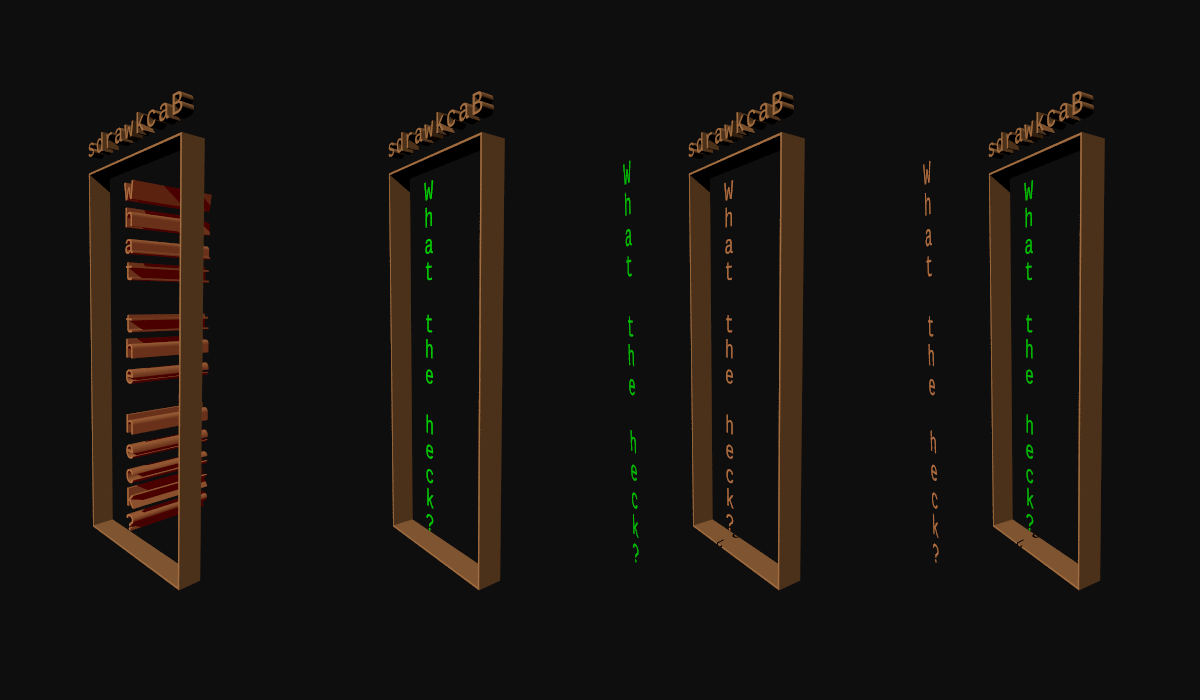

On 3/4/25 10:35, William F Pokorny wrote:
> I started looking at a yuqk version of documentation for the text{} object.
Playing with the thickness parameter.
I've always specified values >0, but it works with values at 0 and with
negative values. With the latter though, by intent or mistake, only
renders the front and back surfaces - and the interior exterior
treatments are interesting / different(*).
Iideally we'd have an 'open' capability with text{}, but the way the
negative thickness values are working allows us to somewhat easily add
front and back surface textures which are different than the text{} sides.
The images use an 'interior_texture{}' that is green for the "What the
heck" string. Only matters with the negative thickness on the third and
fourth sub images. The fourth also using 'inverse'.
Bill P.

From: Bald Eagle
Subject: Re: Other things the text object can do.
Date: 19 Mar 2025 08:05:00
Message: <web.67dab2e99216b80b25b4de9225979125@news.povray.org>
This is all pretty interesting - especially using "inverse"  I always forget to
try and use that in things.
I do notice that there is something - a shadow? - present in the two rightmost
images that are not present in the two leftmost.  Significant in any way?
- BW
From: William F Pokorny
Date: 19 Mar 2025 12:59:40
Message: <67daf7fc$1@news.povray.org>
No. I think they are showing up where they should be(*).
Bill P.
(*) For the moment, let's ignore the fact I often get things wrong. :-)

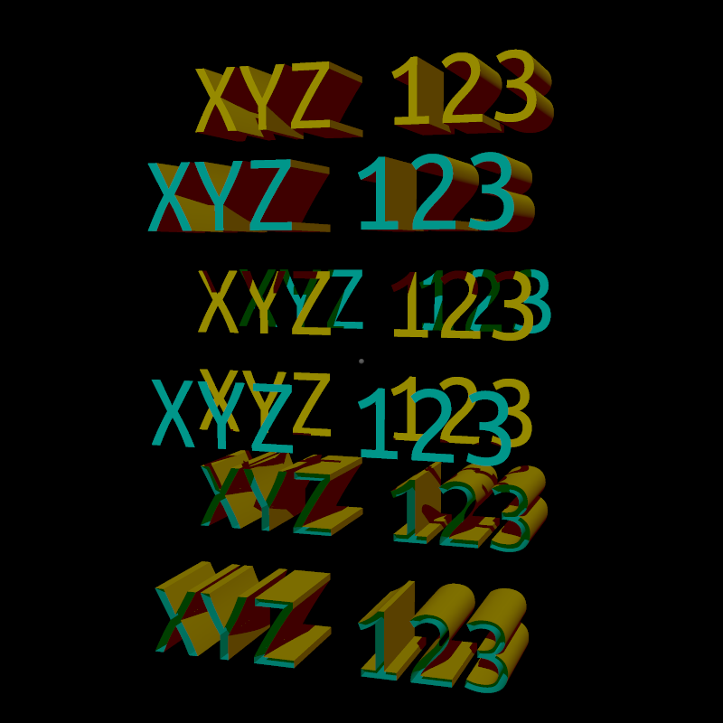

OK. Attached a sample image for many of the text{} updates coming in
release R19 of the yuqk fork. Namely, new text{} features 'caps' and
'open' along with fixes for negative thickness specifications. Negative
thickness becomes an OK thing to do and not something which only partly
works.
Bill P.
Download 'caps_open_features.png' (78 KB) Download 'caps_open_features.pov.txt' (5 KB)
Preview of image 'caps_open_features.png'
> works.
This is really cool, and actually very useful.
I often need to apply text to an image, but have to juggle the color depending
upon what color/brightness the background is.  Now we can have 2 contrasting
colors in a single glyph so that it always shows up reasonably well.
It will be interesting to experiment with things like gradients and other
patterns.
