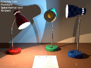

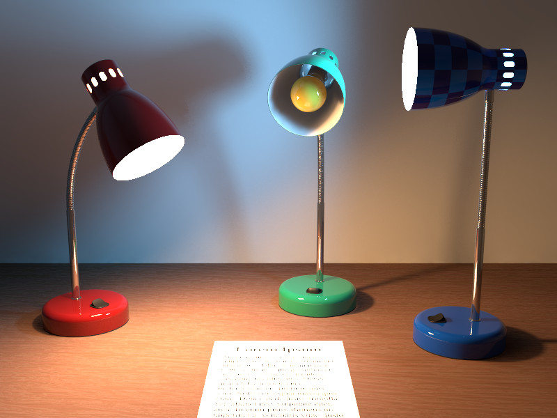

I'm still in the process of calibrating indirect lighting when radiosity
is not used, or when radiosity { max_sample } is used, but aside from
that, the module is essentially complete.  In this illustration, the red
lamp on the left has been directed to aim at the paper, and the other
two lamps were directed to aim at a specified angle.
The lamps' brightness can be synchronized with Lightsys IV.
Download 'desklamp.jpg' (93 KB)
Preview of image 'desklamp.jpg'

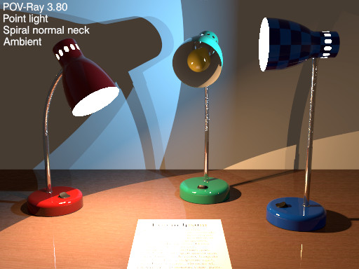

I actually did use a light group in my original lamp 17 years ago, but
aliasing was not the issue.  I used large fade distances, which did not
illuminate the hood interior sufficiently to cause anti-aliasing
difficulties.
The problem I had back then was how to avoid a sharp cutoff of the
light, which is recessed, by the hood without requiring an area light.
The attached image shows this issue.  I solved it in 2005 by using a
non-recessed wide-angle spotlight to illuminate the scene, and a light
group to illuminate the hood interior.
I made the decision last year to abandon that approach.  There would be
a single light_source, centered on the light bulb, for both the hood
interior and the scene, with the spotlight being repurposed for
radiosity replacement.  But a light group would not have solved the
problem anyway; the issue is the light intensity that realistic
attenuation entails, and a light group doesn't change that.  I verified
this by rendering my original 2005-2006 lamp with input arguments that
forced realistic attenuation.
I would rather deal with hyper-white aliasing by post-processing.
Download 'test_desklamp-v38d0r0.jpg' (51 KB)
Preview of image 'test_desklamp-v38d0r0.jpg'
