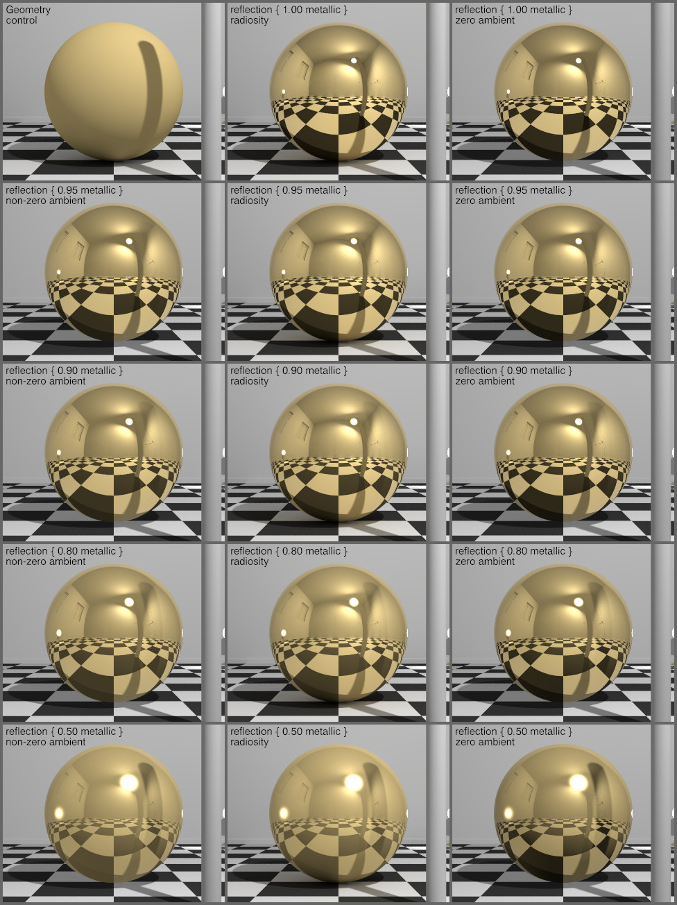

Image metal_ambient-pbi.jpg shows metal spheres with varying levels of
specular reflection, and a post used to cast a shadow on each sphere.
On each sphere, the 'diffuse' is calculated as half of what is not
specularly reflected.  For example, reflection { 1.00 metallic } has
diffuse 0, and reflection { 0.50 metallic } has diffuse 0.25.  The left
column sets ambient proportionately to the diffuse, and the right column
sets ambient to zero.  The middle column uses radiosity, and sets zero
ambient on all surfaces throughout the scene.
The radiosity cases are used as controls, to see how POV-Ray deals with
metallic surfaces with a diffuse component.  The shadows cast with
non-zero ambients (left) are better matches to the radiosity controls
than the shadows cast with zero ambients (right).  The same is true of
the reflected tiles.
(You may notice that the spheres also vary roughness with specular
reflection, but this is not at all relevant to the question of ambient &
diffuse.)

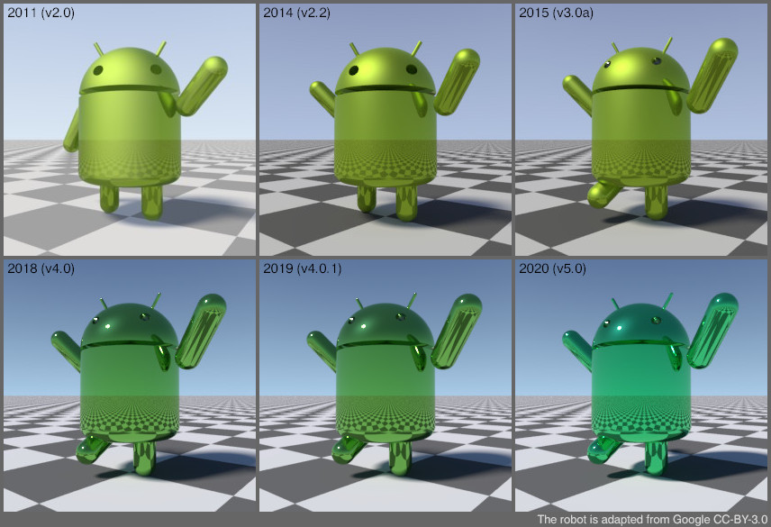

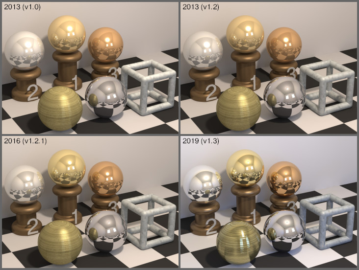

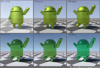

Since clipka has been posting about metallic finishes, over the years I
have been increasing the specular reflection and decreasing the diffuse
& ambient in my metallic textures.  This can be seen longitudally in
some of my Object Collection modules.  I am reconsidering the
AndroidRobot finish, though, for whenever Google next revises the robot;
I think the robot looks better semi-metallic.
For most metal surfaces, I'm finding this a good finish:
  finish
  { reflection { 0.9 metallic }
    diffuse 0.05
    ambient 0.05 * whatever_your_general_scene_ambient
    emission 0 // Suppresses 3.8's high ambient warning
    specular albedo 1 metallic
    roughness 0.0001 // or higher
For polished surfaces:
  finish
  { reflection { 1 metallic }
    diffuse 0
    ambient 0
    roughness 0.0001 // or lower

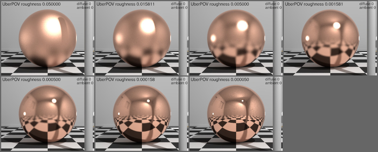

Download 'spec-androidrobot-pbi.jpg' (122 KB) Download 'spec-rc3metal-pbi.jpg' (118 KB) Download 'spec-roundedge-pbi.jpg' (111 KB)
Preview of image 'spec-androidrobot-pbi.jpg'
Preview of image 'spec-rc3metal-pbi.jpg'
Preview of image 'spec-roundedge-pbi.jpg'

Op 25/11/2021 om 20:00 schreef Cousin Ricky:
> On 2021-11-25 1:06 PM (-4), Alain Martel wrote:
>> The metallic finishes from metals.inc have been made to look acceptable
>> in an empty scene against a black background, and that's the only
>> situation where they look somewhat correct.
> Or, how about using a bright sky_sphere along with a large hollow black
> sphere with no_reflection.  Our realistic low-ambient and no-ambient
> metals will show up fine, no need for metals.inc's insane ambients.
<hint> There is a task for you to correct the metals.inc content for the
future users generations and, on a more serious note, for (future)
downloads of the POV-Ray package. </hint> ;-)
From: Alain Martel
Subject: Re: Ambient and cast shadows on metallic textures
Date: 26 Nov 2021 13:02:13
Message: <61a12125$1@news.povray.org>
>> I came to the conclusion that metallic finishes should have zero ambient
>> through my own experimentation. The metallic textures from the various
>> includes looked just wrong to me.
> Yes, they do look horrible!  My experiments with better metallic
> textures began very soon after I downloaded POV-Ray.
>> I started by commenting out the
>> ambient. I got a massive improvement. Then, I tested with an explicit
>> zero ambient and got the best, most realistic, result.
> As I implied in the OP, I adopted the policy of reducing the ambient in
> proportion to the diffuse, and wrote a macro to do this automatically.
> Since a highly specular surface would have a low diffuse component, this
> naturally leads to very low ambients.  But the ambients in metals.inc
> are *way* out of proportion to the diffuse components!
>> When I first posted about it, I was unaware of Clipka's position on that
>> subject.
Here is my edited versions of metals.inc and golds.inc.
I explicitly set all ambient to zero.
Download 'golds.inc.txt' (10 KB) Download 'metals.inc.txt' (14 KB)
