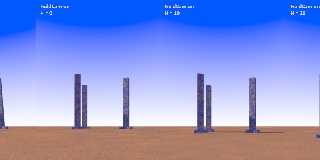

I need the help of a Matrix Master.
I am a regular user of Doctor John's FieldCam macro which enables
slanting architecture to look straight. It simulates the professional
cameras where this adjustment can be done through the lenses.
The macro works perfectly... as long as your scene camera is situated
about the origin of the Y-axis. Recently, I have been working on scenes
where the camera is situated at about y=170.00, and strange things
happen: the camera is moved upwards and forwards, the more so as
elevation gets greater.
To illustrate this, I have attached a little test scene and an image
showing the problem. H is the value for the elevation of the scene
elements along the Y-axis.
I can correct this by adding a translate after the "NoFall" transform in
the camera code, but I assume that this could better be done within the
"NoFall" matrix. I have not the slightest idea how to do this.
Thanks for any help.

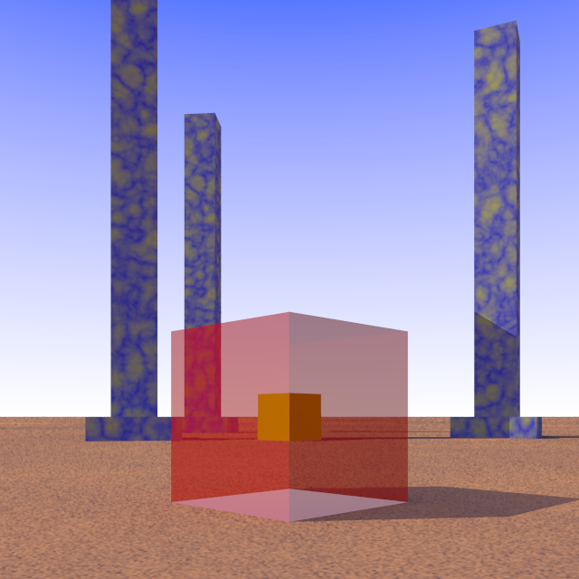

I have never used Doctor John's macro but a quick look at it make me think it is
not supposed to work if the Y coordinates of you camera location and look_at do
not have the same value.
Changing your script as follow:
#case (2)
  #declare CamHeight    = 1;
  #declare CamLoc       = <2000.0, H+CamHeight, -2400.0>;
  #declare CamLookAt    = <2000-100, H+CamHeight, -2400+100>;
#end
and testing with the same H values as you example and FC on gives me correct
images (as far as I understand), cf attachment.
I also don't know if you really need to have a look_at at a different height...
I hope this will help you.

Sorry, after sending my previous message and looking at yours again I think I
have misunderstood what this macro does.
Sorry for the useless post...
I think it's actually accomplished using the adjustable film plane of the view
camera.
The 3-book series on negative, print, and camera by Ansel Adams ought to
describe it fully and clearly.
<hint> One might think there are PDF's of those available...   ;) </hint>
Is this a custom version that you edited yourself, or a later version of the
original?
All I found was this:
http://news.povray.org/povray.text.scene-files/thread/%3Cweb.3e0c736a1f1273cdb29393de0%40news.povray.org%3E/
I'm puzzled by this:
#local VCorr = pow(vlength(CD), 2)/pow(HypoXZ, 2);
and its use in the matrix.  Seems to be some long-winded way to compute y^2 or a
multiple of it....
Maybe try
#local VCorr = CP.y;       ?    Totally guessing.
I don't really understand what I'm looking at in the scene, nor how the macro
corrects the one column and not the others...
shear matrix:
http://www.f-lohmueller.de/pov_tut/trans/trans_450e.htm
The matrix just ... "corrects" the basis vectors of the world space that the
camera uses.
If you look at the thread that jr references:
http://news.povray.org/povray.binaries.misc/thread/%3Cweb.5c226659252b677e48892b50%40news.povray.org%3E/
we explain that the POV-Ray matrix keyword uses a proper 3x3 mathematical matrix
with an additional 1x3 translation matrix "bolted on"to the bottom.
So for
ABC
DEF
GHI
you have row-wise definitions of the basis vectors i, j, k (x, y, z) of the
world space.
So
ABC = <1, 0, 0> = x
DEF = <0, 1, 0> = y
GHI = <0, 0, 1> = z
and then you tack on a translate <x, y, z> to the bottom of that.
So, quick and dirty answer, to address moving your correctional translation to
the matrix would be (I think)
matrix <1, 0, 0, 0, 1, 0, 0, 0, 1, 0, -CP.y, 0>
Doctor John has some mathematical hocus pocus going in with his squared terms,
and what assumptions he makes and why is currently beyond my ken, but perhaps at
some point when I return to having the time and energy to muck around with
POV-Ray stuff, I will puzzle it out.
I'm not sure what the Vcorr does, but I guess it is doing it... wrong?
That's all I've got - for now.
-Bill
 From left to right:
1 - a scene not using FC, camera pointing upwards, base level at y=0.0
2 - same scene using FC. The pillars are now straight as far as the
observer is concerned. Base level still at y=0.0
3 - same scene, again using FC, but now with a base level of y=10.0
4 - idem, base level is y=20.0
Look again: all three pillars are corrected!

Op 17/11/2020 om 22:12 schreef Bald Eagle:
> For the moment, just disregard my other suggestions/guesses.
> Just get rid of the VCorr term in the matrix.
> I have no idea what that's for, but it seems to be the source of the problem.
> Do a few fast, simple [but extreme] renders and see what you think.
#declare NoFall =
transform {
   matrix < 1,     0,      0,
           ShearX, 1, ShearZ,
            0,     0,      1,
            0,     0,      0>
Better (the camera stays at the correct altitude) but is still shifted
increasingly in the view direction. At least, it shows that, as
suspected, VCorr did not serve any purpose. Interestingly, in its first
version, John did not have a VCorr at all!
Using a cube as a proxy camera, shifted an arbitrary value in front of
the camera to make it visible, I can show what happens. The red,
transparant, box is the proxy of the "real" camera; the yellow box is
the proxy of the "real" camera, shifted along the line of view after the
application of the NoFall transform. The distance between the cubes
increases with the height of the camera for y>0.
 From this, it is easy to write a quick-and-dirty correction to be added
/after/ the NoFall transform in the camera definition:
//start code
   FieldCam (CamLoc, CamLookAt)
   #local ProxyCam =
   box {
     <-1, -1, -1>, <1, 1, 1>
     translate CamLoc
     transform {NoFall}
   #local MinBox = min_extent(ProxyCam);
   #local MaxBox = max_extent(ProxyCam);
   #local MidPoint = ((MaxBox-MinBox)/2) + MinBox;
   #local CamLoc_corr = CamLoc - MidPoint;
#declare Camera =
#if (FC)
camera {
   perspective
   location  CamLoc
   sky       CamSky
   up        CamSky
   direction z*CamZoom
   right     x*AspectRatio
   angle     CamAng
   transform {NoFall}
   translate CamLoc_corr
   look_at   CamLookAt
#else
camera {
   perspective
   location  CamLoc
   sky       CamSky
   up        CamSky
   direction z*CamZoom
   right     x*AspectRatio
   angle     CamAng
   look_at   CamLookAt
#end
camera {Camera}
//end code
But this is not as elegant as finding a way to do this already in the
macro ;-)
Download 'dj_fieldcam_test.png' (255 KB)
Preview of image 'dj_fieldcam_test.png'

I'll try to look at this at some point to quantify the shift - it dependent upon
the cam loc, the look_at point, or both?
My thought is that the transform is a _scaling_ and so as we know, that can
shift things that are not AT the origin...
What happens if you shift the camera to the origin, apply the transform, and
then shift it back?
From: Bald Eagle
Subject: Re: Doctor John - FieldCam conundrum
Date: 18 Nov 2020 17:20:00
Message: <web.5fb59db0ed460f771f9dae300@news.povray.org>
> then shift it back?
Well, it definitely has an effect.
First I tried location <0, 0, 0> applying the transform, and then translate
CamLoc, but I just got a blue render (sky)
Then I did
#if (FC)
 camera {
  //FieldCam (CamLoc, CamLookAt)
  FieldCam2 (CamLoc, CamLookAt)
  perspective
  location  CamLoc
  sky       CamSky
  up        CamSky
  direction z*CamZoom
  right     x*AspectRatio
  angle     CamAng
  translate -CamLoc
  transform {NoFall}
  translate CamLoc
  look_at   CamLookAt
That lets me see the columns and seems to change the camera position as well.
replacing VCorr with 1 changes the camera position such that the columns are no
longer visible...
Juggling some things, so that's all I was able to play with for now.
From: Bald Eagle
Date: 18 Nov 2020 19:15:01
Message: <web.5fb5b8d0ed460f771f9dae300@news.povray.org>
So I turned off the field cam, but added the macro invocation to the other
camera definition.
Then I made an axes object, made an object {axes transform {NoFall}}
and overlayed them.
There's no difference if they are at the origin, but when the axes are
translated up (by 50) before applying the transform, I indeed get the up and
forward behaviour.
I can fix the forward movement, but the vertical movement is really puzzling.
  #declare NoFall =
  transform {
   matrix <     1,     0,      0,
           ShearX,  VCorr, ShearZ,
                0,     0,      1,
                0,     0,      -50*ShearZ>
From: Bald Eagle
Date: 18 Nov 2020 19:30:00
Message: <web.5fb5bc18ed460f771f9dae300@news.povray.org>
So for now, just try
  #declare NoFall =
  transform {
  matrix < 1,     0,      0,
           ShearX, 1, ShearZ,
    0,     0,      1,
   -CamLoc.y*ShearX,     0,      -CamLoc.y*ShearZ>
Date: 19 Nov 2020 03:02:14
Message: <5fb62686$1@news.povray.org>

[aside: OK. New Thunderbird version... seems I clicked on wrong answer
button... Sorry]
YOU MADE MY DAY!! :-)
This is the correct answer indeed. I tried a couple of exotic scene
settings and the scene remains rock-solid.
Sir, I bow before your fathomless wisdom and sharp insight. I only got
as far as to understand that the last row of the matrix was crucial.
Thank you infinitely indeed.

From: Bald Eagle
Date: 19 Nov 2020 06:35:00
Message: <web.5fb65763ed460f771f9dae300@news.povray.org>
Thanks, Thomas.
I'm glad that it seems that I've mostly solved the issue - at least for all of
the use cases you've tested.
I still have a feeling that there's a bit more to be done, and somehow VCorr
_may_ be needed in there.
It's not very noticeable from far away, you need steep viewing angles to see
what I mean.
> Op 18/11/2020 om 13:16 schreef Jörg "Yadgar" Bleimann:
> > My digital cameras (even the relatively sophisticated Panasonic Lumix
> > DMC-LZ100) are no able to correct for falling lines... but perhaps this
> > macro can do that with the photos?
> I do not see how. If you import your photograph into a povray scene,
> applying the macro will not correct the '/content/ of the photograph,
> only the scene it is part of.
Possibly.
But you'd need the camera and look_at data from your original photo to get the
right angle of tilt needed.
You may just try making an animation with your photo and rotating it around -x
to see what happens, since AFAIA, that's the bulk of the effect.
Mr Le Coat seems to have a much firmer grasp of all of this:

I agree with you. One of the things which still puzzles me is that there
seems also to be a slight zoom effect, mostly noticiably in cloud
patterns for instance in the background. Maybe that is what you observe.
However, for the time being, the macro is more useful than it was.
I shall put version 4.0 of the macro in povray.binaries,utilities.

From: Bald Eagle
Date: 20 Nov 2020 06:30:00
Message: <web.5fb7a86fed460f771f9dae300@news.povray.org>
OK, I wanted to make sure that it wasn't just me.
The zoom, I think, is part uncorrected stuff, and part unexpected "optical
illusion".  It's real, but it's the effect of tilting the camera's "film plane",
so that some parts are closer to the scene objects than they were.
Try 2 things.

To apply the camera matrix with the camera at the origin.
I think any further work will really need to quantify the effect.

This does not work correctly: the camera is pushed below the surface
(above the surface when y becomes negative, obviously). the VCorr
remains a puzzle to me and the _j does not help in the matter. I also
have a hunch that putting the camera at the origin is not helpful. It
doe not make any difference as far as I can tell.
Yes, I think that is the correct conclusion. So far, you have done a
great job already and made the macro much more useful than it was
originally.
