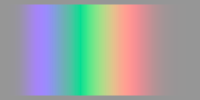

One way to get a realistic impression of a spectrum in a restricted
color space is to desaturate the spectrum as a whole until the
representative colors of all wavelengths are in gamut.  My attempt at
this, desat_submission.png, compares well with a Wikimedia illustration:
   http://commons.wikimedia.org/wiki/File:Rendered_Spectrum.png

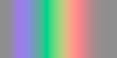

Image spectral_desat-pbi.png is a similar effort using Ive's SpectralRender.
The greens turned out brilliantly; however, the cyans are still
muddy-looking compared to the other colors.  This does not jibe with my
experiences.  Occasionally, sunlight refracts off the edge of a glass
pane, and the cyan is incredibly rich.  JPEG photographs of rainbows
show a rich cyan, even when the backdrop is not blue sky.

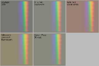

brighter if the spectrum is rendered "in situ."  The images
rich_teal_montage-d65.png and rich_teal_montage-d50.png show terrestrial
sunlight dispersed onto a white surface under various ambient lights,
with D65 and D50 white balances respectively.  (Artificial lights are
modeled because one serendipitous sunbeam that impressed me was
dispersed inside a retail establishment.)  Progressively larger prisms
are used from bottom to top.  The intensities of the sunlight and the
ambient lights were adjusted such that no pixel was out of gamut or
exceeded the 8-bit dynamic range.
The cyan does brighten up when the wavelengths are smeared, but then so
does the yellow, way more than in a real spectrum or rainbow, and at the
expense of the orange and red area.  Smearing also turned out not to be

The source for desat_submission.png follows.  It requires Lightsys IV.
=============================[BEGIN CODE]=============================

The source for the rich_teal_montage-*.png images (rich_teal.pov)
follows.  It requires Lightsys IV and SpectralRender.  The file
SpectralComposer.inc is just a version of SpectralComposer.pov which I
modified by wrapping the user setting #declares with #ifndefs.
The spectra for the ambient lights were prepared with
integratelight.inc, which integrates spectral curves rather than
sampling points on the curves.  I haven't yet released the code, but the
scene file will render without it.  Except for the Mitsubishi runs, the
results look virtually identical either way.
