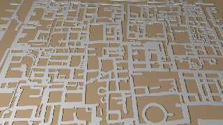

The attached image is the render of a prism object (linear_sweep
bezier_spline) generated by Inkscape from an image.
My question is if it would be possible, and if yes how, to drape this
prism over a (gently) undulating height_field? The vertical component
should remain vertical of course as they represent (foundation) walls.
Download 'inkscape_mohenjodaro_test.png' (219 KB)

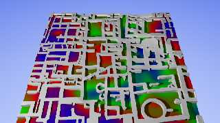

Subject: Re: Prism over a height_field?
Date: 28 Jul 2011 05:03:16
Message: <4e3125d4@news.povray.org>
On 28-7-2011 10:24, Bill Pragnell wrote:
> Extend the prism in y, and intersect with a copy of the heighfield offset in y?
Yes indeed! That seems to do the trick. Here a small test image.
Thanks again!
Download 'inkscape_mohenjodaro_test.png' (237 KB)
Preview of image 'inkscape_mohenjodaro_test.png'

Are you sure you used the heightfield correctly? In some areas, the walls seem
deeper than in others. Or is that deliberate? :)
Not deliberate, but indeed a need for better coordination of the
parameters :-) On the other hand, it can be used for some height variations.
This image shows a better construction.
Download 'inkscape_mohenjodaro_test.png' (316 KB)
Date: 28 Jul 2011 07:31:17
Message: <4e314885$1@news.povray.org>
On 28-7-2011 12:47, Jim Holsenback wrote:
> cool ... very clever solution
Isn't it? This will give me the possibility to populate my city of
Gancaloon in an easy manner. Only for overviews of course because the
buildings will not have enough details. I have now to devise a street
plan, and find a way to make the buildings of slightly different height,
probably by separate and superposed prisms. As everything can be based
on image_maps, this is going to be mainly GIMP work :-)
