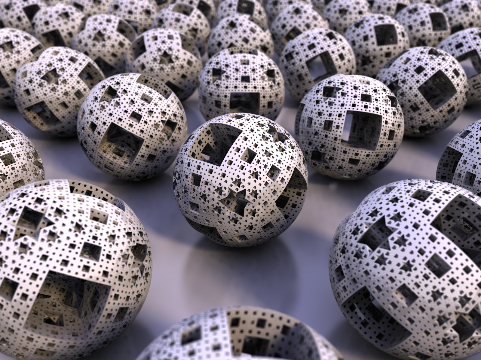

Recipe
* Take one Menger Sponge (Level according to taste).
* Chop off, diagonally, the eight corners.
* Inflate the sides until spherical.
* Polish until slightly reflective.
* Place on a micro-normal-blurred reflective surface.
* Replicate about 500 times.
* Add an area light for soft shadows.
* Turn on radiosity and focal blur.
* Render for 30 days or until done.
Download 'spheresponge.jpg' (699 KB)
Preview of image 'spheresponge.jpg'

Thanks for the nice comments.  Here's some information for those
interested in the structure of the object.
I started with my non-recursive Menger Sponger isosurface function...
function
  max
   #declare Level = 4;
   #declare Size = 0.5;
   #while (Level > 0)
    #declare Size = Size / 3;
    min(Size-abs(mod(x,Size*6)-Size*3),Size-abs(mod(y,Size*6)-Size*3)),
    min(Size-abs(mod(y,Size*6)-Size*3),Size-abs(mod(z,Size*6)-Size*3)),
    min(Size-abs(mod(z,Size*6)-Size*3),Size-abs(mod(x,Size*6)-Size*3))
    #declare Level = Level - 1;
    #if (Level > 0) , #end
   #end
Contained and chopped the corners off with further "max" constraints to
form a cuboctahedron...
#declare Sponge = function
  max
   #declare Level = 4;
   #while (Level > 0)
    min(Size-abs(mod(z,Size*6)-Size*3),Size-abs(mod(x,Size*6)-Size*3)),
   #end
   x-1, -x,
   y-1, -y,
   z-1, -z,
   -x+y-z-0.5,
   +x+y-z-1.5,
   -x-y-z+0.5,
   +x-y-z-0.5,
   -x+y+z-1.5,
   +x+y+z-2.5,
   -x-y+z-0.5,
   +x-y+z-1.5
Then made a mapping that transformed any coordinate within a sphere to a
coordinate within the cuboctahedron such that any point on the surface
of the sphere would also fall on the surface of the cuboctahedron...
#declare SphereTransX = function { x * sqrt(x*x+y*y+z*z) /
max(abs(x),abs(y),abs(z),(abs(x)+abs(y)+abs(z))/2) }
#declare SphereTransY = function { y * sqrt(x*x+y*y+z*z) /
#declare SphereTransZ = function { z * sqrt(x*x+y*y+z*z) /
 From there I could simply define my Sphere Sponge as...
#declare SphereSponge = isosurface
  function
   Sponge
    SphereTransX(x-0.5,y-0.5,z-0.5)+0.5,
    SphereTransY(x-0.5,y-0.5,z-0.5)+0.5,
    SphereTransZ(x-0.5,y-0.5,z-0.5)+0.5
  contained_by { sphere { 0.5, 0.5 } }

Hehe :-)  The really nice thing about defining it as an Isosurface is
that you can make it as complicated as you want (i.e. render the sponge
at any level you want) without taking up tons and tons of memory.
The real limit then becomes how many pixels you have on the screen to
visualize the beast! :-)

I almost forgot...
If you can compile your own version of POV-Ray, you may be interested in
this trick to speed up rendering *A LOT*
Load up isosurf.cpp, scroll down to the bottom, and replace the
Evaluate_Fuction code with the code shown below.  This is basically a
pure C code version of my Sphere Sponge isosurface function, and as you
can imagine, can be evaluated much faster than the parsed SDL version.
DBL Evaluate_Function(FUNCTION funct, VECTOR fnvec)
	DBL result = -1.0;
	DBL x = fnvec[X]-0.5;
	DBL y = fnvec[Y]-0.5;
	DBL z = fnvec[Z]-0.5;
	DBL max = fabs(x);
	if (fabs(y) > max) { max = fabs(y); }
	if (fabs(z) > max) { max = fabs(z); }
	if ((fabs(x)+fabs(y)+fabs(z))/2 > max) { max =
(fabs(x)+fabs(y)+fabs(z))/2; }
	DBL sphereScale = sqrt(x*x+y*y+z*z) / max;
	x *= sphereScale;
	y *= sphereScale;
	z *= sphereScale;
	x += 0.5;
	y += 0.5;
	z += 0.5;
	DBL size = 0.5;
	for (int level = 4; level > 0; --level)
		size /= 3.0;
		DBL a = size - fabs(fmod(x,size*6.0)-size*3.0);
		DBL b = size - fabs(fmod(y,size*6.0)-size*3.0);
		DBL c = size - fabs(fmod(z,size*6.0)-size*3.0);
		if (a < b)
			if (a > result) { result = a; }
		else
			if (b > result) { result = b; }
		if (b < c)
		else
			if (c > result) { result = c; }
		if (c < a)
		else
	if (x-1 > result) { result = x-1; }
	if (y-1 > result) { result = y-1; }
	if (z-1 > result) { result = z-1; }
	if (-x > result) { result = -x; }
	if (-y > result) { result = -y; }
	if (-z > result) { result = -z; }
	if (-x+y-z-0.5 > result) { result = -x+y-z-0.5; }
	if (+x+y-z-1.5 > result) { result = +x+y-z-1.5; }
	if (-x-y-z+0.5 > result) { result = -x-y-z+0.5; }
	if (+x-y-z-0.5 > result) { result = +x-y-z-0.5; }
	if (-x+y+z-1.5 > result) { result = -x+y+z-1.5; }
	if (+x+y+z-2.5 > result) { result = +x+y+z-2.5; }
	if (-x-y+z-0.5 > result) { result = -x-y+z-0.5; }
	if (+x-y+z-1.5 > result) { result = +x-y+z-1.5; }
    	return result;
