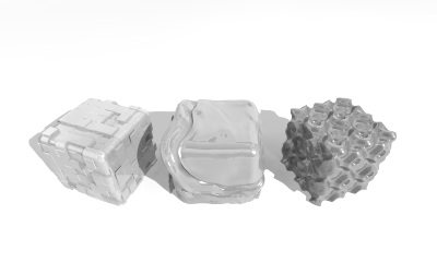

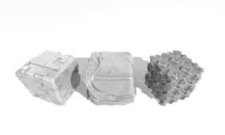

In a scene I am working on, I am building it up with just plain primitive
boxes but when I have the layout all done, I'd like to make them isosurfaces
so I can deform them with noise or pigment functions. I couldn't figure out
an easier way than make a macro that takes the same vectors that define the
box, plus some other parameters, resulting in an isosurface.
This may not be usefull for anyone else but me (meaning, it works on the
scale I'm working with, your results may vary... and it's not tested
heavily), but here's the macro and sample output.

Download 'isobox3.png' (29 KB)
Preview of image 'isobox3.png'
