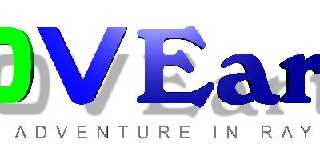

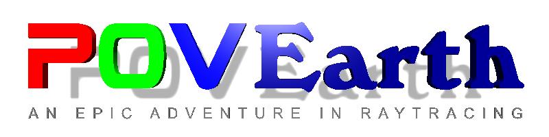

High!
Originally, I intended to reveal this only at a more advanced stage...
but I got stuck with the shadows. I aimed at blurred shadows for the two
lines of text, so I used a fairly large area_light made up of 50  by 50
single lights. But then I found it very difficult if not impossible to
make them *really* blurred - if I just enlarge the area light, shadows
become thinner and thinner until they disappear completely, which is
just logical. On the other hand, increasing the number of single lights
does not help either, it just bogs down the CPU. Even at these
comperatively moderate settings, the shadows of the lower line disappear...
Is there a way to blur shadows without post-processing at all?
See you in Khyberspace!
Download 'povearth-title.jpg' (23 KB)
Preview of image 'povearth-title.jpg'

If you have too much light hitting that back plane, it will drown out the
soft shadows.
Set the plane's ambient to 0 and diffuse to 1 in the finish{} block. Then
make sure your only light source is the area_light (if you want other light
sources on the text, put them in a light_group with the text). Set the
area_light's color to rgb 1, and if the direction to the area light from the
part of the plane we're looking at is about perpendicular to the plane, this
will cause a near perfect transition from white to black on the soft
shadows.
You may then want to raise ambient and decrease diffuse (keep them adding up
to 1 to keep the background white) to make the shadows lighter.
Also make sure you have circular and orient set in the area light.
 - Slime
