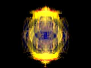

I wanted to modify it to the basic Mandelbrot so I could try and find
the Buddhabrot. No luck as I can't code to save myself. I did come up
with this though and I quite like it. I think I'll call it the
Sumobrot. I used Mike's modification to create 3 df3's and played
about with emitting media. Let your eyes go slightly out of focus.
Regards
        Stephen
Download 'Sumobrot.png' (201 KB)
Preview of image 'Sumobrot.png'
Wow.  Miss a few days, miss a lot.  I'm searching but not finding examples
of "Mike's modification" or "df3s" and I really want to figure this out!
So, please help.  Source perhaps?  Or of your less out-of-focus version
below?  I haven't puzzled out df3's yet.  Maybe this example would soak in.
Thanks
(Really cool by the way, yours and Andrew's and as always, Mike's)
Dave Matthews
From: Stephen McAvoy
Subject: Re: The Cubic Mandelbrot [23 kb] - Sumobrot.png
Date: 29 Jun 2005 18:41:45
Message: <to86c1t4alun9i77rdu21e8t2jkm3lghv7@4ax.com>
On Wed, 29 Jun 2005 17:01:35 EDT, "Dave Matthews"
Mikes Modification (sounds important like Tim's error in fractint) was
to use Andrews's formula and use it as a pigment.
Of course! It is a three step process.
I added a variable to the formula and created an animation. Then using
tga2df3 I created a df3. The less out of focus image had more tga
images. 120 in the one you asked about. Mikes Modification uses a
three colour, colour map. So I modified that and produced three
monochrome df3's, Red, Yellow and Blue. This took 4 and a half hours
on my Laptop the df3's are 84 Megs.
The POV file to generate the image was made in Moray so the coordinate
system is not the same as in POV and there are INC and INI files. I
have found that there are 4 interesting positions for the camera and
they are symmetrical about the origin.
BTW using a sphere instead of a box produces in interesting image but
I've not found anything worth posting.
I'll post the source in Povray.biniaries.misc as a zip file shortly.
