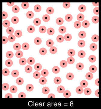

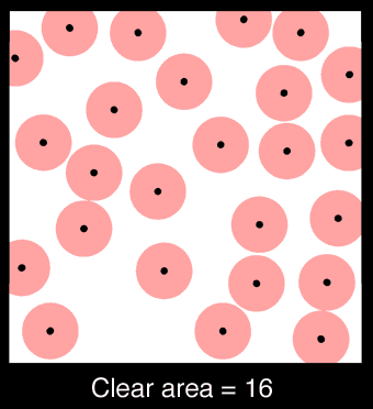

I'm working on some code to pack a number of objects - presumably
vegetable-based, but I guess a person could pack anything they want -
into a rectangular area. It uses arrays to store the locations of
individual "trees", and tests randomly-placed trees against those
already in the arrays to make sure that their "clear areas" don't
overlap. A confidence value tells the code to give up and stop placing
trees after a user-defined number of placement failures.
Because of the random nature of the code and the need to test against
every other tree when placing a new one, scenes with a lot of trees take
a long time to parse; the example below using "clear area = 4" took 31
minutes on my Mac G4/867! I'm contemplating some kind of automatic
bounding so the code only tests new trees against old trees in the same
area, which should help more the more trees there are. Other planned
improvements include the ability to use multiple patterns to affect the
success of tree placement, the ability to have any number of "layers" of
trees with different placement characteristics, and some kind of
probability system using either a user-defined threshold or a random
test to determine whether placement in an unlikely area (such as on a
steep slope, or close to another tree) succeeds.
Whether I'll actually MAKE any of these improvements remains to be seen...
-Xplo

From: Florian Brucker
Subject: Re: Forest generation (or; crude packing)
Date: 30 Mar 2004 16:31:29
Message: <4069e731$1@news.povray.org>
A way to improve this would be something like bounding boxes - divide
the space you're filling into n*m rectangles, each with it's own array
where the objects of that rectangle are stored.
#local Objects = array[CellsU][CellsV][MaxObjectsPerCell];
Of course you have to add an object which overlapps a border into both
cells it touches.
And now please go on and find me the same packing algorithm you're
writing, but only should it:
- use 3 dimensions instead of 2
- pack a certain amount of objects in as little space as possible
- use non-spherical (cylindrical would do) objects with a random
   rotation
Haven't got any idea how to do this (Apart from actually running it
through SimPOV, which would take years IMHO).
I'd already be happy if I found some algo which produces pseudo-correct
results, where the cylinders would overlap (but nobody would notice).
Florian
From: Darren New
Date: 30 Mar 2004 17:49:40
Message: <4069f984$1@news.povray.org>
Sounds like you may be just running linearly through your array when
trying to place a new tree. Inserting the tree in order, then finding
the trees to test against via binary search might work better.
For example, order by X axis, do a binary search, and only compare with
trees within a certain distance of the same X.
Or, if you can fit (say) 20 across and 20 high, make a 20x20 array and
only check the nearby cells for possible trees.
Darren New, San Diego CA USA (PST)
   I am in geosynchronous orbit, supported by
   a quantum photon exchange drive....
From: Xplo Eristotle
Date: 30 Mar 2004 17:51:03
Message: <4069f9d7@news.povray.org>
>> take a long time to parse;
I plan to implement something like that, yes...
...but not like that. If I'm reading this right, I could accomplish the
same effect right now by using multiple "forests" stitched together,
which isn't what I want; the "clear areas" around trees in adjacent
cells would overlap because those trees don't get checked against each
other.
Instead, I would divide the area into sections and only check against
the trees in the sections near where the new tree is trying to be
placed. So for example, instead of checking tree #27 against trees
#1-26, I would check the arrays for the section where #27 is going and
the eight sections around it, and perhaps find that the only trees in
those sections are #4, #5, and #21. Knowing this, the code would only
check those trees, and ignore the others, since all of the others must
be too far away to overlap.. am I making any sense?
>   rotation
The tighter this algorithm packs the objects, the longer it'll take,
since you'll have to raise the confidence to absurd levels to ensure
that they're packed as tight as they're going to get. I suppose if you
really wanted to be thorough, you could have a second algorithm take
over when the first one loses its confidence and walk a fine grid,
testing each point on the grid to make sure something can't fit there;
at some point this would be far more efficient than random placement
that fails over and over again.
3D is easy. The math gets a little more complicated.
3D using cylinders is easy.. kinda. The math that tests for overlap gets
even more complicated, but the algorithm basically stays the same.
3D using cylinders under the influence of gravity which not only moves
the cylinders but also rotates them when they touch other objects..
you're on your own, pal. And you may want a sumpercomputer to run the
simulation... ;)
-Xplo

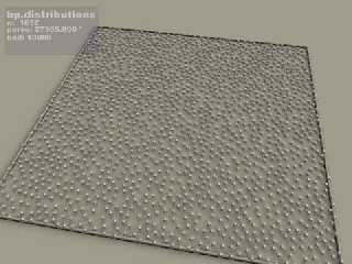

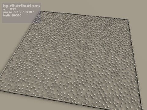

From: bp
Date: 30 Mar 2004 23:59:27
Message: <406a502f@news.povray.org>
can i show mine?
i did this ages ago, and was planning to make some improvments to my
otherwise totally brute force method, but i was pleased enough with the
final image anyway. Sorry, i've probably lost the source, but i could
have a dig around for it.
(in the top left panel, n is the number os dots, parse is the time it
took to parse in seconds, i think, and bail is the amount of times it
has failed and then bailed out to start rendering. Jeepers - it looks
like this one took around 7 hours to generate!)
benp
Download 'hwdistributions3b.jpg' (34 KB)
Preview of image 'hwdistributions3b.jpg'
From: bp
Date: 31 Mar 2004 00:01:37
Message: <406a50b1@news.povray.org>
and...
bp wrote:
> can i show mine?
> benp
Download 'hwdistributions3_reallyfine.jpg' (55 KB)
Preview of image 'hwdistributions3_reallyfine.jpg'
Date: 31 Mar 2004 06:18:19
Message: <406aa8fb$1@news.povray.org>
Now the second one rocks! Can't see the parsing time properly, but it
must have been quite some days :)
Florian
