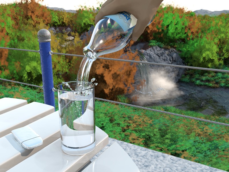

Well I've tweaked loads of things in my scene since the last version I posted.
Thanks for all the comments, they've helped a lot!
Anyway, I'm now thinking that this looks finished. What do you think? Does it
need something more or is it complete?

It's better than before. Try working on the surface of the water in the
glass (make it not so flat), if you want. Primarily, I think the vegetation
needs work. It looks too blurry. I assume you're not trying to make it look
detailed, but it could still be improved.

Thanks. I agree with both those suggestions, but I have no idea how to improve
the trees! The technique I'm using was discovered by accident, so I don't really
understand how to fix it.
I'll have a play with the water surface. It has some ripples in it but they
aren't really visible. And I'll see if I can do anything with the trees.

  I think that making the greens on vegetation less "standard" would
suffice, as they are not the main focus. For the rest, the sun light is
very nice, and the overall scene has an interesting "high mountain"
ambient.

I agree, tone the vegetation done some, to let the foreground stand out
more.

The only thing I think needs to be changed is the surface of the water in
the glass - it's too still.
This looks like a pretty good entry for the topic in the IRTC.
