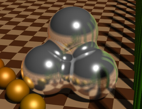

I made this image using Ron's blurred reflection trick and Rune's hint
(of scaling the normals very big instead of very small) and it works quite
well.
  It took 32 minutes to render in a 600MHz Sun Blade (with +a0.1).
  The source code follows the image.
Download 'test.jpg' (46 KB)
Preview of image 'test.jpg'

There's an odd discontinuity on the lower-right silver ball - the reflection of
the space between the two green shapes seems very different from the reflection
either side...

I think this is because the left hand one of the green shapes in
question is actually casting a shadow over that bit of the ball.

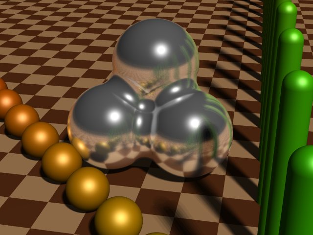

Attached picture was rendered with MegaPOV for comparison. I tried 50 blur
samples first to compare the 50 samples in Warp's code but that didn't look
good. Then I chose 255. Less might have been enough. Anyway, we can see a
difference in the type of blur.
MegaPOV blur = reflection 1 reflection_blur .075 reflection_samples 255
Render times 1 ghz Amd, AntiAlias 0.3.. Note also that Pov3.5 is faster.
MegaPOV blurred reflection = 7.35 minutes
MegaPOV Ron's Blur         = 4.21 minutes
POV3.5  Ron's Blur         = 3.29 minutes
Download 'BlurReflec_Megapov.JPG' (50 KB)
Preview of image 'BlurReflec_Megapov.JPG'

  Yes, that's exactly what happened there. And it *is* the correct behaviour.
(The change in color happens because the blob is not colorless, but has a gray
tint.)
