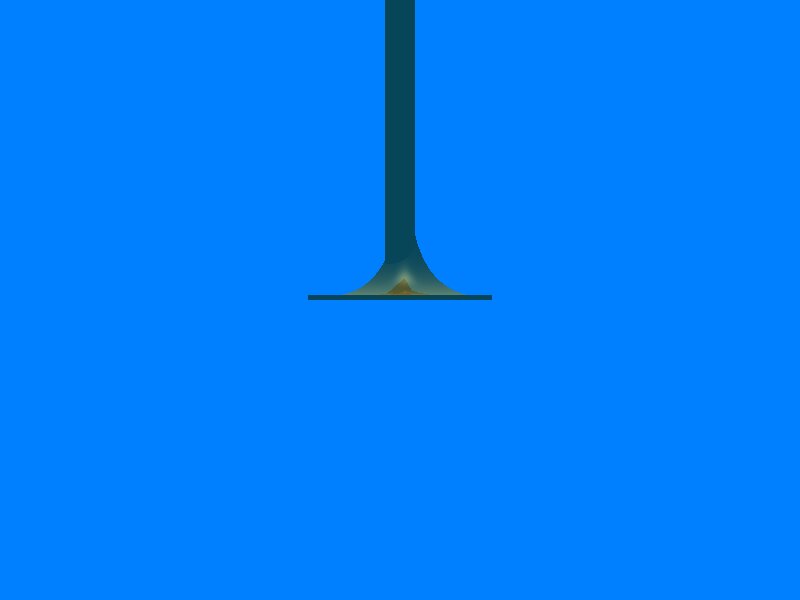

Currently, I'm modeling an ancient mathematical co-prozessor... and with
its pins, a problem occurred. As they are somehow soldered to the
ceramic die's lower side, there is a smooth transition between the pin
itself and its flat round base. Any attempts to model this with blobs
resulted in monstrously swollen base cylinders, so I decided to do it
with a lathe, using Moray.
But when viewed from along the z axis, the lathe turns out to be
asymmetric (see picture)! Did this result from the fact that I did not
specify a fourth point on the y axis?
Here is the code:
#declare Pin_Raw=
cylinder
 0, <0, 0.0037, 0>, 0.0001
#declare Pin_Transition=
lathe { // RotSweep001
  quadratic_spline
  3  // control points
  <28.704931, 14.913935>,
  <5.999999, -0.033529>,
  <0.639678, 11.939946>
  scale 0.0001
  translate 0.00003
#declare Pin_Socket=
cylinder
 0, <0, 0.00003, 0>, 0.0006
#declare Pin=
union
 object { Pin_Raw }
 object { Pin_Transition }
 object { Pin_Socket }
 texture { T_Gold_2B }
Download 'cyrix0001.jpg' (6 KB)
Preview of image 'cyrix0001.jpg'

The lathe itself is symmetrical, it's just that you've translated it by
<0.00003, 0.00003, 0.00003> relative to the Pin_Raw cylinder. Try
   translate 0.00003*y
Mike Williams
Gentleman of Leisure

Are you aware that POV-Ray promotes
the 0.00003 scalar in your
"translate 0.00003" expression to a
vector, so that the expression
becomes this:
translate <0.00003, 0.00003, 0.00003>
Maybe you meant to write:
translate 0.00003*y
Hmmm...
I see now that you are using Moray.
Maybe I haven't found your problem.
Tor Olav
From: Jörg 'Yadgar' Bleimann
Subject: Re: Lathe problem (JPG, 800 x 600, 6 KB)
Date: 13 Feb 2003 16:44:10
Message: <3E4C219C.76DE80B2@tiscalinet.de>
High!
>    translate 0.00003*y
Ouuuh... how stupid!!!
