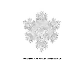

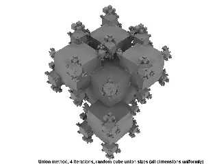

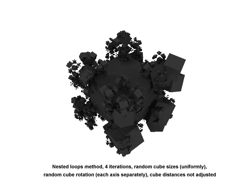

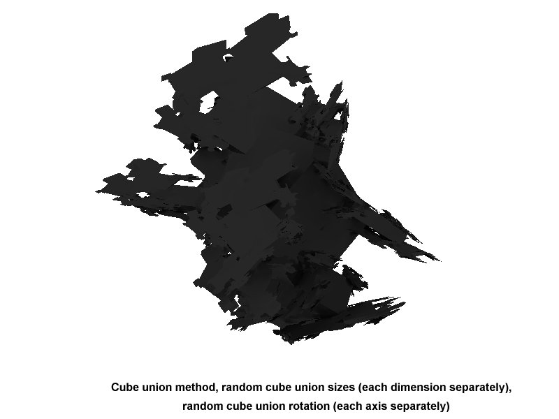

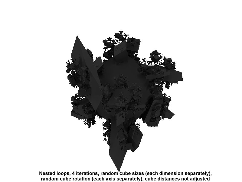

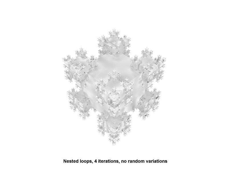

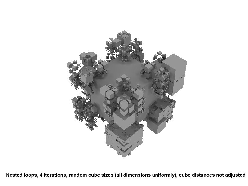

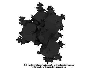

High!

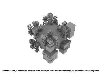

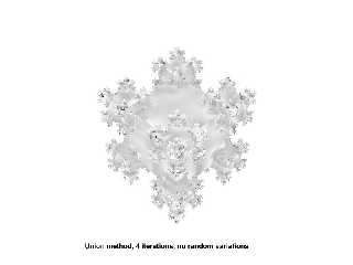

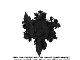

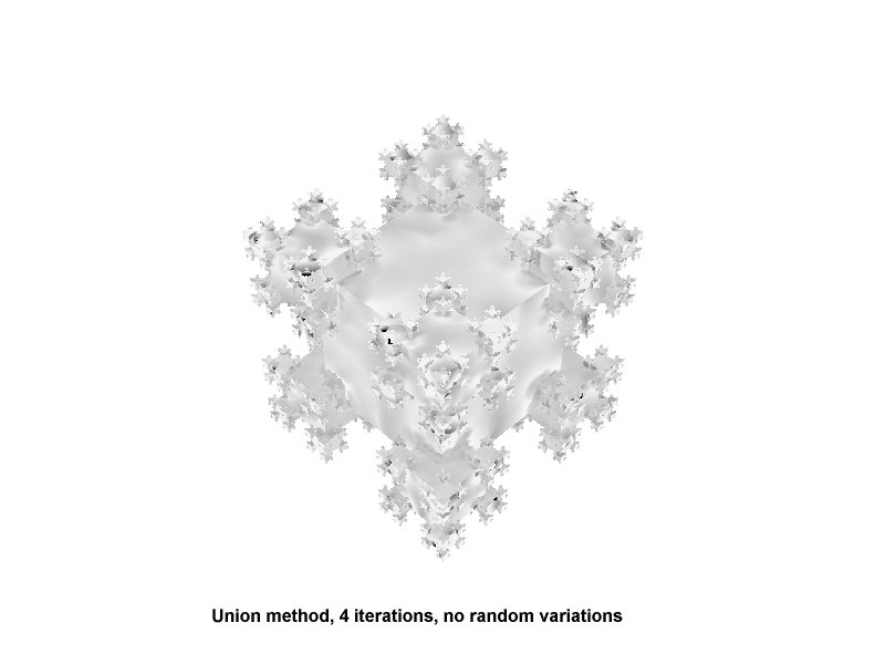

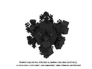

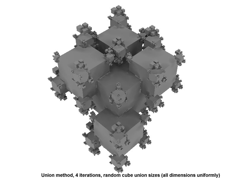

Several weeks ago, I posted here on a problem with primitive fractal
scenes. Back then, I used to build them by nesting
loops corresponding to their tree-like structure. But (at least with the
cube fractal) whenever I did this more than 4 iterations
deep, I got that nasty "Too many nested objects" error.
Then the ominous K appeared on the scene... he posted an alternative
solution in p.b.s-f capitalizing on PoV-Ray's implicit
creation of objects:
#declare cubes=
union
   object { cube}
   object { cube ...}
   object  { cube ... }
#declare cubes=
union
    object { cube }
    object { cubes ... }
and so on... each definition of "cubes" is scaled and translated in the
following re-definition.
I then started to use this technique, it worked very well, but of course
there is the problem, that, unlike with nested loops, I'll
never be able to modify each single cube individually, for example by
using rand(). Nevertheless, K's method yielded some
very interesting results, which I would like to show here.
But as realistic trees need branches and twigs which are individually
modifyable, I still asked myself if there are other ways to
get rid of the "too many nested objects" error - I just can't imagine
that all the many more or less sophisticated tree macros
use not more than 4 iterations! One way I myself found indeed - to put
the whole nested loop structure together in a merge
statement instead of a union - but then calculation becomes dead slow,
around 1 line every 10 minutes or so, not to mention
radiosity...
A propos radiosity: can anyone give me a hint how to avoid those ugly
blotchy artifacts?
See you in Khyberspace!
Yadgar
Now playing: Out of World (Feltman Trommelt)

Nice and interesting images.
Your nesting problem... I don't get the problem.
I did something similiar to this a while ago, I've attached the outcome...
All I did was to write a macro, which divides a cube into a 3x3 Grid.
It places a superellipsoid in the corners and then calls itself
again with the middle-section as new cubes.
So, recursively, the cube is divided, superellipsoids are placed, and
we move in further and further.
It's a pretty simple macro, but I guess something like that, along with
some more #if-#else-#end, would do the job. Random-Stream may be
used freely etc, just the implementation requires a little thought.
I'm not sure how you did your images, what you are actually willing
to achieve, so maybe my approach is not suitable to your project.
Just my 2 cents worth...

The fifth iteration will create a huge hit on parse time, and render
time ten times that.
Applying textures to individual elements will slow it down even more.
Grim

High!
See the posted code for both algorithms in p.b.s-f. ...
No, it isn't... as your superellipsoids don't intersect anywhere, unlike in my
scene, where always one out of eight cubes is
hidden inside the cube of the previous iteration! But on the other hand, even
when I programmed an exeption for this one
cube (i. e. not to render it at all), I still got this mean "Too many nested
objects" when trying to render more than four
iterations deep!
I also programmed a scene with spheres who did not intersect at all - and then
it was no problem to render, let's say five
iterations...
You clearly ran me out... this cries for revenge!
Now playing: I love the Night [The Ecstasy of Flight] (Chris de Burgh)

Hey Yadgar
I adapted Tim Nikias' macro to your fractal, and it worked for every level i
tried it for.
I then ran a few timed tests just to see which method worked the best.
It turns out that all 3 ran for the same length of time.
The only glitch was the too many nested objects problem with your method.
Of all 3 methods, Tim's is by far the easiest to read write and maintain.
Thanks to you both, this has been quite enlightening.
K
