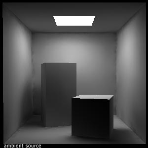

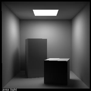

To verify that my assumptions about povray light sources
are correct I tried to make ambient source with the same
lighting properties as a diffuse area light.
I think I got it but there is this mysterious constant 2*pi
which is required. I think the 2 comes from the fading equation
attenuation=2/( 1+(d/fade_distance)^fade_power ). The intensity
at the surface of the light is two times higher than at the fade
distance. But where does the pi come from? :)

From: Jaime Vives Piqueres
Subject: Re: Equivalent area light and ambient source
Date: 13 Oct 2001 06:34:12
Message: <3BC818AC.633BECD5@ignorancia.org>
  Very interesting... but the area version looks better, soft and
without artifacts.
 Because light propagation is spherical? I've been reading a lot about
lighting lately, because I'm trying to relate common bulb properties to
pov light sources, and found many equations involving pi.
http://www.ignorancia.org/
From: Kari Kivisalo
Date: 13 Oct 2001 12:15:48
Message: <3BC868B4.30805D99@engineer.com>
> without artifacts.
It's faster too. This was fundamental research to advance
povray science :)

From: Wolfox
Date: 13 Oct 2001 18:14:52
Message: <3bc8bcdc@news.povray.org>
IIRC, isotropic propagation of electromagnetical waves (and therefore light)
causes energy to be distributed on a sphere surface with center on the point
emitter. So that pi constant may come out of that.
