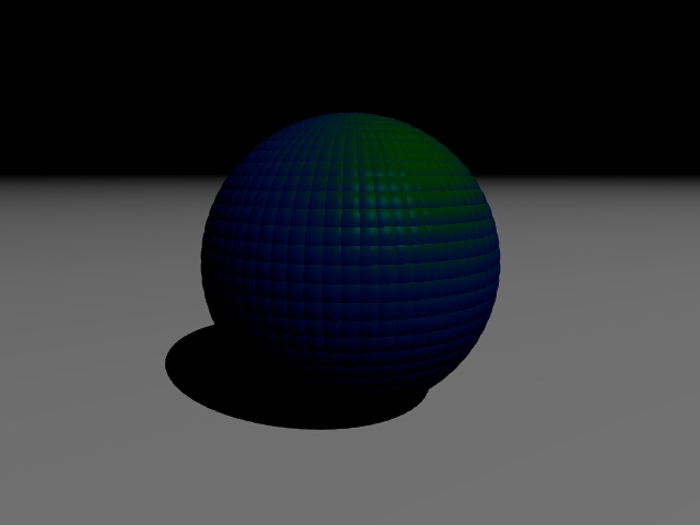

yesterday, I started a POVMan shader to do an insect "shell" (not sure
of the word).
here is the first result.
it needs more work to find the right colours and to make the surface
finish more realistic.
2 questions:
- I'm not sure of my shader version of the "metallic" keyword... I
multiplied the specular by the surface colour...Am I right ?
- I'm using little spheres to do the big sphere. When I increase the
radius of the spheres, the rendering time increase a lot ! Is it normal
           David

From: Rick [Kitty5]
Subject: Re: insect shader (50ko bu)
Date: 15 Jan 2001 05:57:59
Message: <3a62d7b7@news.povray.org>
> of the word).
All I saw was a solid black sphere - had to open it up and play with the
gamma to see anything :)

From: gemelli david
Date: 15 Jan 2001 06:08:15
Message: <3A62DA88.A5E3BDD5@xlstudio.com>
yes, it's dark but on my computer, it is good...

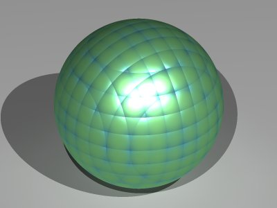

From: Rick [Kitty5]
Date: 15 Jan 2001 09:10:54
Message: <3a6304ee@news.povray.org>
> > would it not be possible to achieve this effect in povray using the
pillow
> > normal?
> I don't know "pillow normal"
i ment quilted :)
#declare Material1 =
   material  // Material1
      texture
         pigment
            quilted
            control0 0.2
            control1 0.2
            color_map
               [ 0.0     rgbft <0.583333, 1.0, 0.583333, 0.0, 0.0> ]
               [ 0.5     rgbft <0.291667, 0.739567, 1.0, 0.0, 0.0> ]
               [ 1.0     rgbft <0.0, 0.0, 1.0, 0.0, 0.0> ]
            scale  0.2
         normal
            quilted , 0.548
            control0 0.2
            control1 0.2
            scale  0.2
         finish
            ambient 0.172633
            diffuse 0.2158
            brilliance 1.729
            phong 1.0
            phong_size 17.216667
            specular 0.3453
            roughness 0.060133
            metallic 1.0
POV-Ray News & Resources - http://povray.co.uk
Kitty5 WebDesign - http://kitty5.com
Hi-Impact web site design & database driven e-commerce
PGP Public Key

From: gemelli david
Date: 15 Jan 2001 09:31:49
Message: <3A630A3C.C24FC647@xlstudio.com>
> i ment quilted :)
ok !
but, the effect I want is a surface wich color changes with the incident
light !!
in my picture (I know, it's only a picture, an animation is in progress...)
the green tint is dependant of the light source direction.
as I said, I have to work on it to get the right colours and finish but,
the "spirit" is here !
      David
From: Chris Huff
Date: 15 Jan 2001 11:01:59
Message: <chrishuff-E18E98.11032015012001@news.povray.org>
In article <3A62BC0D.C65F3E08@xlstudio.com>, gemelli david
> of the word).
"Exoskeleton", but people will look at you funny if you use words like
that too much... ;-)
> 2 questions:
That seems to be an approximation...looking at the source code, POV
seems to use some kind of Fresnel function for textures using
"metallic". This is for both phong and specular...and apparently phong
and specular are the only things affected by metallic, and the
calculations do use the surface color, though it is more complex than a
simple multiplication.
When the spheres overlap more, POV has to solve for more spheres to get
the one that is in front of the others. If you have 4 spheres
overlapping in an area, all 4 will have to be computed to render that
area. When you increase the radius of the small spheres, you increase
the average number of spheres per pixel, and POV has to do more work to
render the image.

From: gemelli david
Date: 15 Jan 2001 11:17:45
Message: <3A63230F.EDB180D@xlstudio.com>
yes, right !
ok, I'll play with it just to get the effect I want, if it is too
> render the image.
ok, thanks for this precision !
         David
