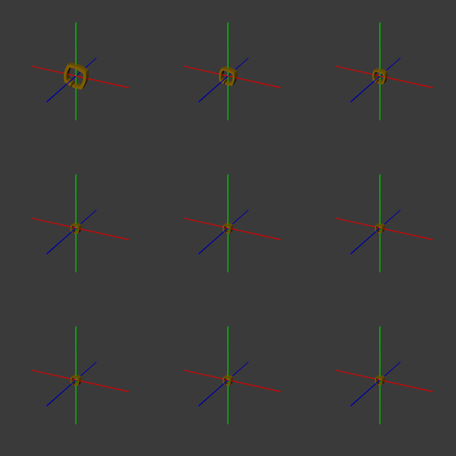

Hi Bill,
Your suggestions are reasonable ways we might better see what's
happening. I suspect I've mislead you into thinking I believe something
is amiss with how matrix transforms are working or with what I expect
for a result.
My original surprise at the result in the lower right image over in pbi
came from setting up a matrix I knew was out of bounds for typical use.
I didn't expect things to work like two separate shear matrices; I
didn't know what would happen, but the result surprised me due how
dramatically it whacked the checker pattern.
I started to wonder what other useful direct matrix transformations
there might be. The 'matrix form' posted about in this thread looks
useful too, but I fully admit I'm just poking the matrix with a stick to
see what happens. To some extent, I wonder about why it does what it
does, but I care more about whether what it does might be useful.
The isosurface animation was itself another way to verify behavior.
There is the usual pattern space to function space inversion. I
un-inverted the rotation so it looked like the checker rotation. I left
the scaling as is because scaling up of the function's coordinate space
shrinks the isosurface result here - keeping the results in a fixed
view/frame, so to speak.
I ran the animation out only to frame 50, but I did spot checks at
frame_numbers 100 through 900 stepping by 100. An image of those renders
is attached.
Bill P.
Download 'matrixplayasiso_frm100__900.png' (33 KB)
Preview of image 'matrixplayasiso_frm100__900.png'

From: William F Pokorny
Subject: Re: Playing with matrix transforms
Date: 21 Jan 2025 18:00:47
Message: <6790271f$1@news.povray.org>
On 1/21/25 15:30, Bald Eagle wrote:
> The isosurface looks like a strange, but interesting result to me, because
> you're getting distortion of the square instead of the simple rotation like you
> do in the checker.
> It sort of looks like a camera iris - something to be pursued, I think.
Yes, I added a f_hypot(x,y) multiplier to the two 'rotation/shear terms'
to create something more interesting than the square-frame rotating and
shrinking.
Attaching two more mp4s. The one with the _BW.mp4 suffix removes that
f_hypot() multiplier.
The one with the _SinCosHyp.mp4 suffix adds a sin() then cos() wrap of
the f_hypot() multipliers. Done with the thought it might be
interesting. :-)
Bill P.

For those of you that want to be able to do matrix calculations within POV-Ray,
I have made a library that can do some of that.
It can be found here:
https://github.com/t-o-k/POV-Ray-matrices
(NB: Some of the descriptions and examples are not finished yet.)
Below are some examples with this library that may be relevant to this thread.
Tor Olav
http://subcube.com
// ===== 1 ======= 2 ======= 3 ======= 4 ======= 5 ======= 6 ======= 7
#version 3.7;  // Should also work in version 3.8
global_settings { assumed_gamma 1.0 }
#include "matrices.inc"
#declare No_Change_Transform = transform { }
#declare Rotate_Transform = transform { rotate 60*x }
#declare Shear_Transform =
    transform {
        matrix <
            1, 1, 0,
            0, 1, 0,
            0, 0, 1,
            0, 0, 0
#declare Translate_Transform = transform { translate <3, 1, 2> }
#declare Composite_Transform =
    transform {
        No_Change_Transform
        Rotate_Transform
        Shear_Transform
        Translate_Transform
#debug "\nNo Change Transform:\n"
M_Print(M_FromTransform(No_Change_Transform))
#debug "\nRotate Transform:\n"
M_Print(M_FromTransform(Rotate_Transform))
#debug "\nShear Transform:\n"
M_Print(M_FromTransform(Shear_Transform))
#debug "\nTranslate Transform:\n"
M_Print(M_FromTransform(Translate_Transform))
#debug "\nComposite Transform:\n"
M_Print(M_FromTransform(Composite_Transform))
#debug "\n\n"
#declare No_Change_Matrix = M_Identity(4);
#declare Rotate_Matrix = M_Rotate3D_AroundX(radians(60));
#declare Shear_Matrix =
    array[4][4] {
        {  1.0,  1.0,  0.0,  0.0 },
        {  0.0,  1.0,  0.0,  0.0 },
        {  0.0,  0.0,  1.0,  0.0 },
        {  0.0,  0.0,  0.0,  1.0 }
#declare Translate_Matrix = M_Translate3D(<3, 1, 2>);
#declare Composite_Matrix =
    M_Mult(
        M_Mult(
            M_Mult(
                No_Change_Matrix,
                Rotate_Matrix
            Shear_Matrix
        Translate_Matrix
#debug "\nNo Change Matrix:\n"
M_Print(No_Change_Matrix)
#debug "\nRotate Matrix:\n"
M_Print(Rotate_Matrix)
#debug "\nShear Matrix:\n"
M_Print(Shear_Matrix)
#debug "\nTranslate Matrix:\n"
M_Print(Translate_Matrix)
#debug "\nComposite Matrix:\n"
M_Print(Composite_Matrix)
#debug "\n"
#error "No error, just finished"
