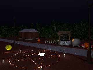

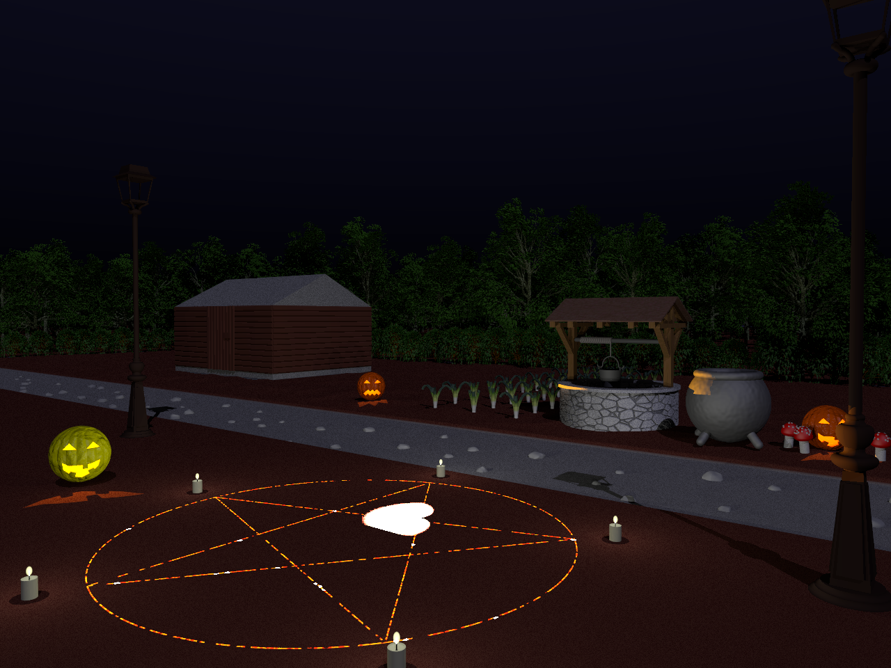

I post a message here, because I get a weird render with povray 3.8.0 beta 1 of
a scene with the following resolution : 1280x960 (see attached image with this
message) , you can see a white stain that has the shape of a heart near the
pentagram. When I render this same scene with stable v3.7.0 the white stain
doesn't appear. And even weird, when I render this scene with povray "3.8.0
beta1" but with the resolution of 640x480, I don't get this white stain in the
final image. Usually I'm cautious before I claim this is a bug and that the
error is not between the keyboard and the chair, but there is something wrong
there.
Antoine.
Download 'halloweenhousenighttime3.8.png' (1167 KB)
Preview of image 'halloweenhousenighttime3.8.png'

What I've found so far:
 - The artifact varies with the image size.  A 960x720 render leaves an
   oblong stain on the upper left vertex.
 - The artifact isn't completely absent with 640x480.  At 640x480, tiny
   white spots appear along the veins of the pentagram, but they are
   absent in a 3.7 render.  I presume that this means you did not put
   them there deliberately, and that they are related to the big heart-
   shaped stain.
 - 3.8 beta 2 does not solve the problem.

There are other things to consider:
- First off, set the boolean 'PlaceWell' (line 19 of main pov file) to false, to
get a faster rendering, the heart shape artifact being always there.
- Changing the minimum_reuse value from '0.015' to '0.01' make the 'heart shaped
artifact' to disappear, but the little white stains you talked about are there,
it seems.

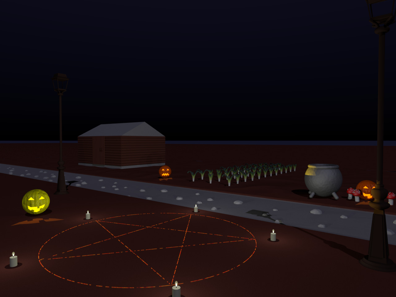

The following might, or might not, be of help to you with official
versions of POV-Ray.
I took a quick look at at this bug with my current povr branch and found
along with some recent bounding code changes it got me to a more stable
fail for a bug I've been chasing for years. Details posted in the v4.0
group.
My povr branch is now considerably different than official POV-Ray
offerings, but after translating the pentagram up by 2x the thread
radius(a) I got away from the 'white regions.' I never saw the heart
shaped one - no idea why not in povr. Image attached.
(a) - Media needs clean start and stop intervals. Near coincident
shape/surfaces can cause confusion and leave intervals open - and with
emission media this results in extremely bright regions.
Where you had media I moved from min, max samples and interval
specifications to just 'samples 10'.
In many places you are using the srgb keyword with channel values
outside the 0-1 range. My povr branch doesn't allow this because any
'srgb calculation' outside the 0-1 range is wacky. See post elsewhere
for details. If you need values outside 0-1, use rgb to exactly specify
what you want for internal linear values.
includes/outdoorsLamp.inc -> debug statement line 218 uses LampZpos and
it should be LampZPos.
Bill P.

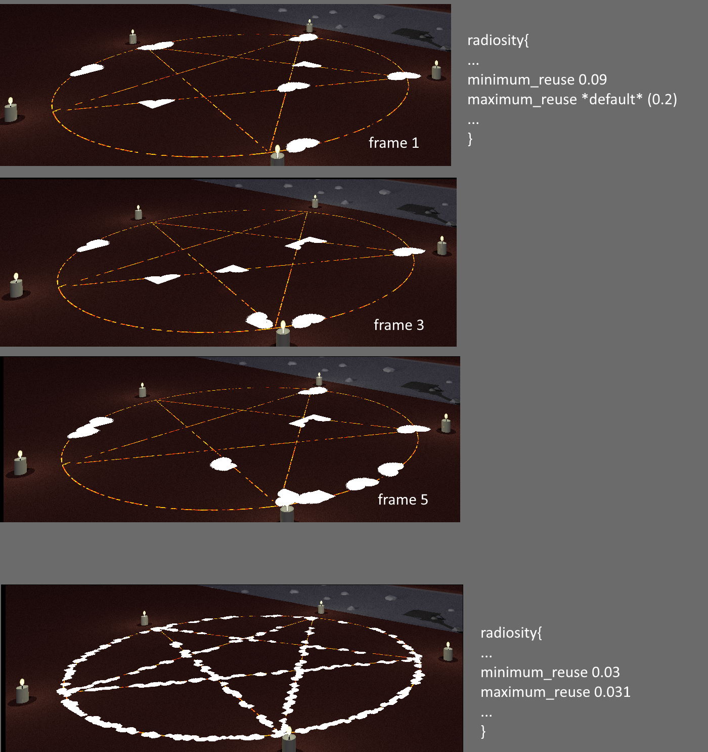

This is a very tricky problem to diagnose; I am seeing inconsistent results from
render to render, even at the problematic 1280X960 render size. Sometimes the
heart-shaped stain is there, sometimes not.
[Warren wrote:]
// There are other things to consider:
// First off, set the boolean 'PlaceWell' (line 19 of main pov file) to false,
// to get a faster rendering, the heart shape artifact being always there.
Even with that change, I still get inconsistent results.
Interestingly, I commented-out this code block in your main file to see what
would happen; it's your lamp-placement block, I think...
#for( It, 0, PositionsNum - 1, 1 )
 #end
#end
..... but I still see the (inconsistent) artifact.
That still leaves your pumpkins and candles in the scene-- with *their* lights.

Forget that; it's probably of no real consequence...because I think I've solved
at least part of the problem (the large heart-shaped artifact).
> ...I am seeing inconsistent results from
That's because of the scene's radiosity settings. I noticed that there was no
maximum_reuse value given, which means that it defaults to 0.2-- which is quite
large and can result in large splotchy artifacts-- the heart shape, for example.
My image examples are from an animation test. I changed minimum_reuse to 0.09...
and I now see LOTS of such artifacts. The reason why my earlier tests seemed
inconsistent is because of the random nature of such 'splotches' from render to
render, given the values used; and it just happened that the scene's rad
settings were sometimes producing only ONE *major* artifact...or none. The sizes
of such splotches vary according to the 'spread' between the minimum_reuse and
maximum_reuse values.
I also did a test with these rad values:
minimum_reuse 0.03
maximum_reuse 0.031
This produces even more splotches, all of the same (smaller) size.
It's obvious that these super-bright artifacts are showing up along the 'lines'
of the pentagram. The remainder of the problem must be that some of its srgb
colors are 'greater than 1.0' as was mentioned earlier, and are interacting
weirdly with radiosity; or that the scene's lights and fade_powers are somehow
too bright.
Apparently, radiosity is picking up a super-bright color from *somewhere*, and
using it in its calculations.

Forgot to mention that I changed the scene's rad 'count' from 800 to 80 for
these test renders, just to make quicker tests.
